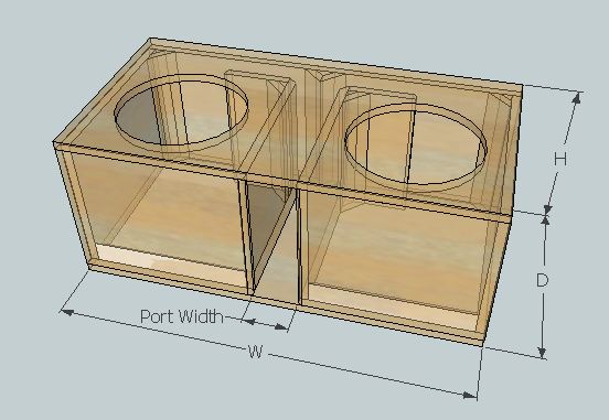

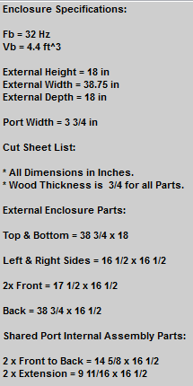

I have a 2000 Tahoe. I want a box like the one in Steve's only for 2 12's.
where the subs are mounted on top and the port is on the side facing  the hatch door. Wondering if anyone could hook me up with dimension's and or any advice would be solid as well.
  Thanks.
So here is a suggestion, power: to sub(s) rated, amp subsonic filter to 28Hz, minimum port clearance 3 3/4", figure is just an assembly guide:
