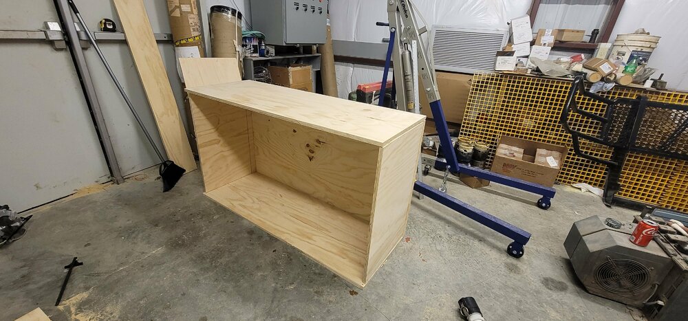

Box dimensions
L 54 1/2
D 18 1/2
H 30 1/2
Sealed side is going to be 10 inches high calculation 5.8 cubic ft³. Leaving the Ported size 11.96 cubic ft³. Only thing I've ever done is Ported boxes and sealed boxes so needing some help. I've seen where it's supposed to be 15sq inches to each cubic foot idk of that's combined, if so it'd be 155 Sq inches only thing I could come up with is a 6x6x6 square port hoping someone can help me out.
I'd post pics of it in truck but it's a mess currently from stripping everything out the back.
Just to answer the question, with a ported chamber volume of 12 cubic feet, 150 square inches of port area would be 10x15 inches, to tune that to 45Hz which is typical for those 4th bandpass boxes, the depth of that port would need to be 6.5 inches.
Quite frankly you are going to require more support than the port, the box you show, hope is from another project since it's not even the size of the sealed chamber of your (I assume) wall. Walls look thin..etc.
