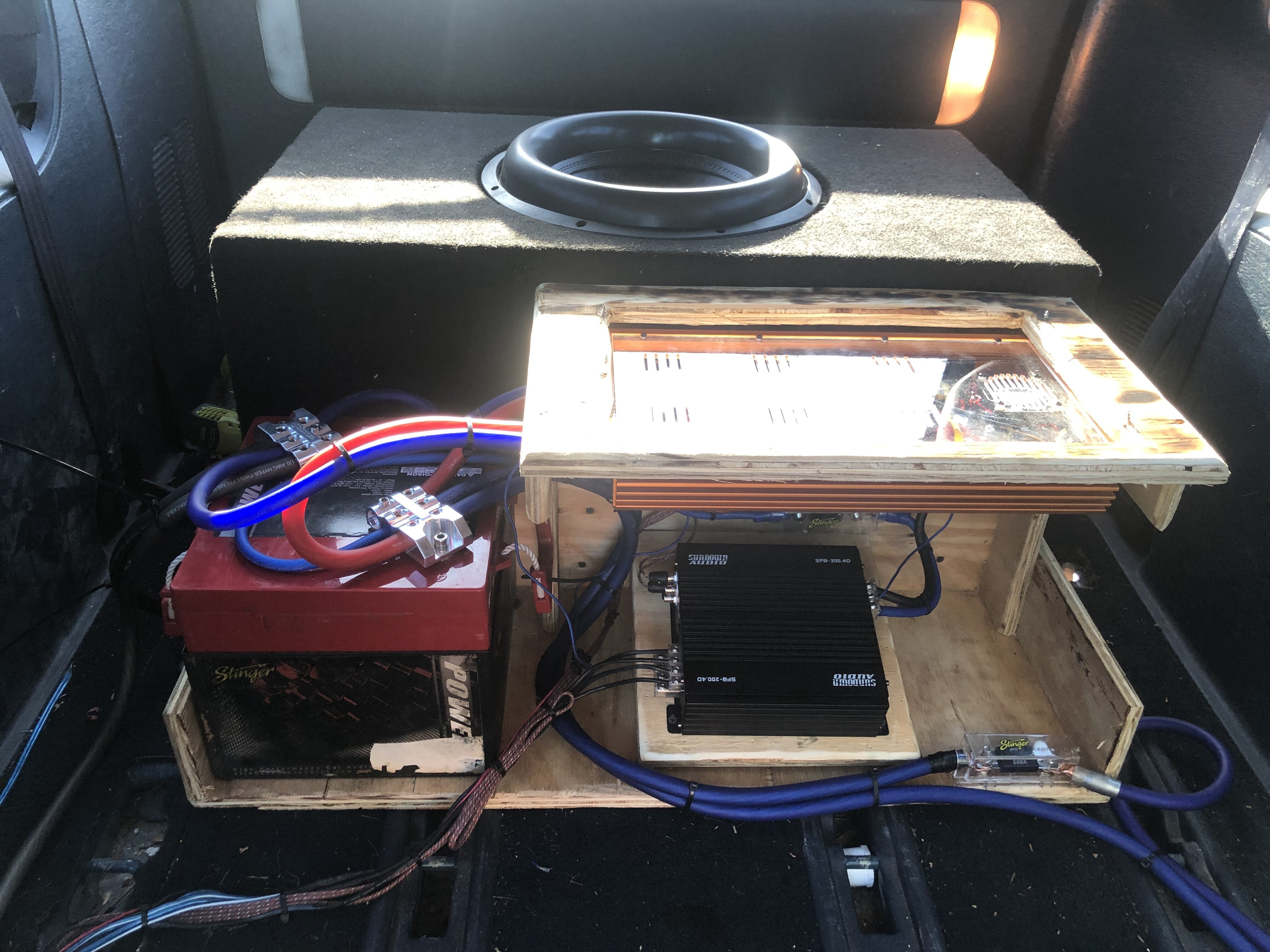

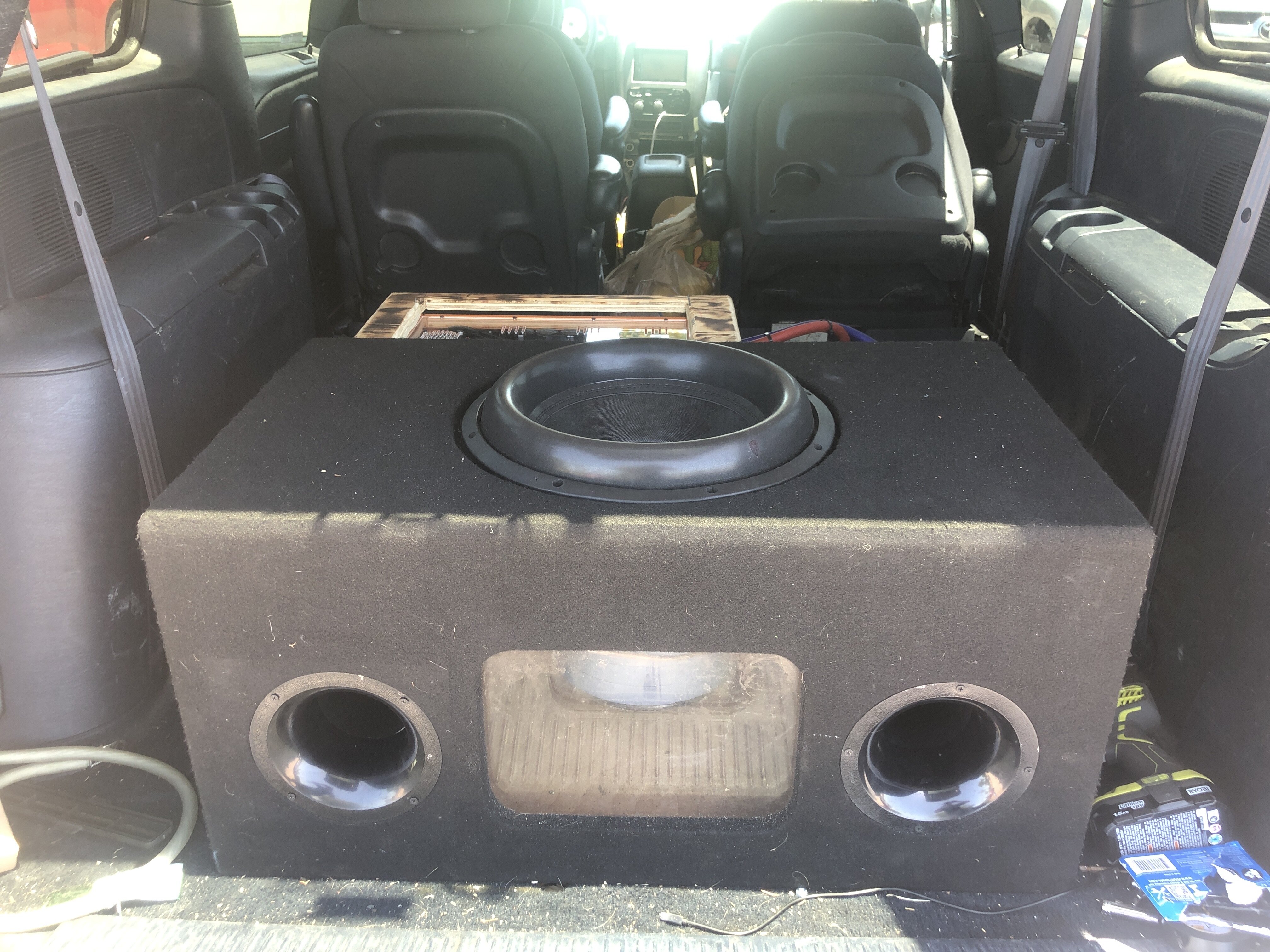

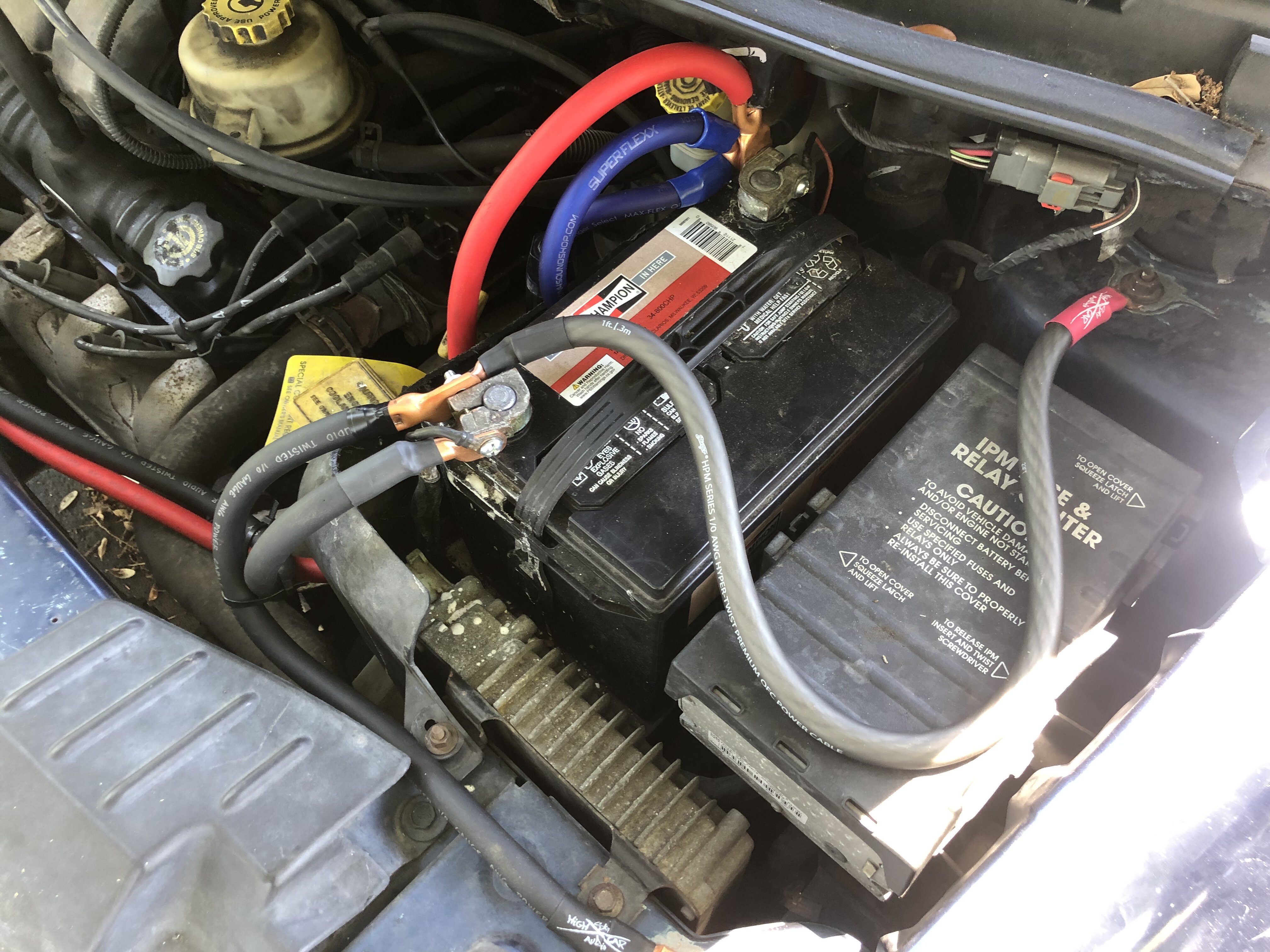

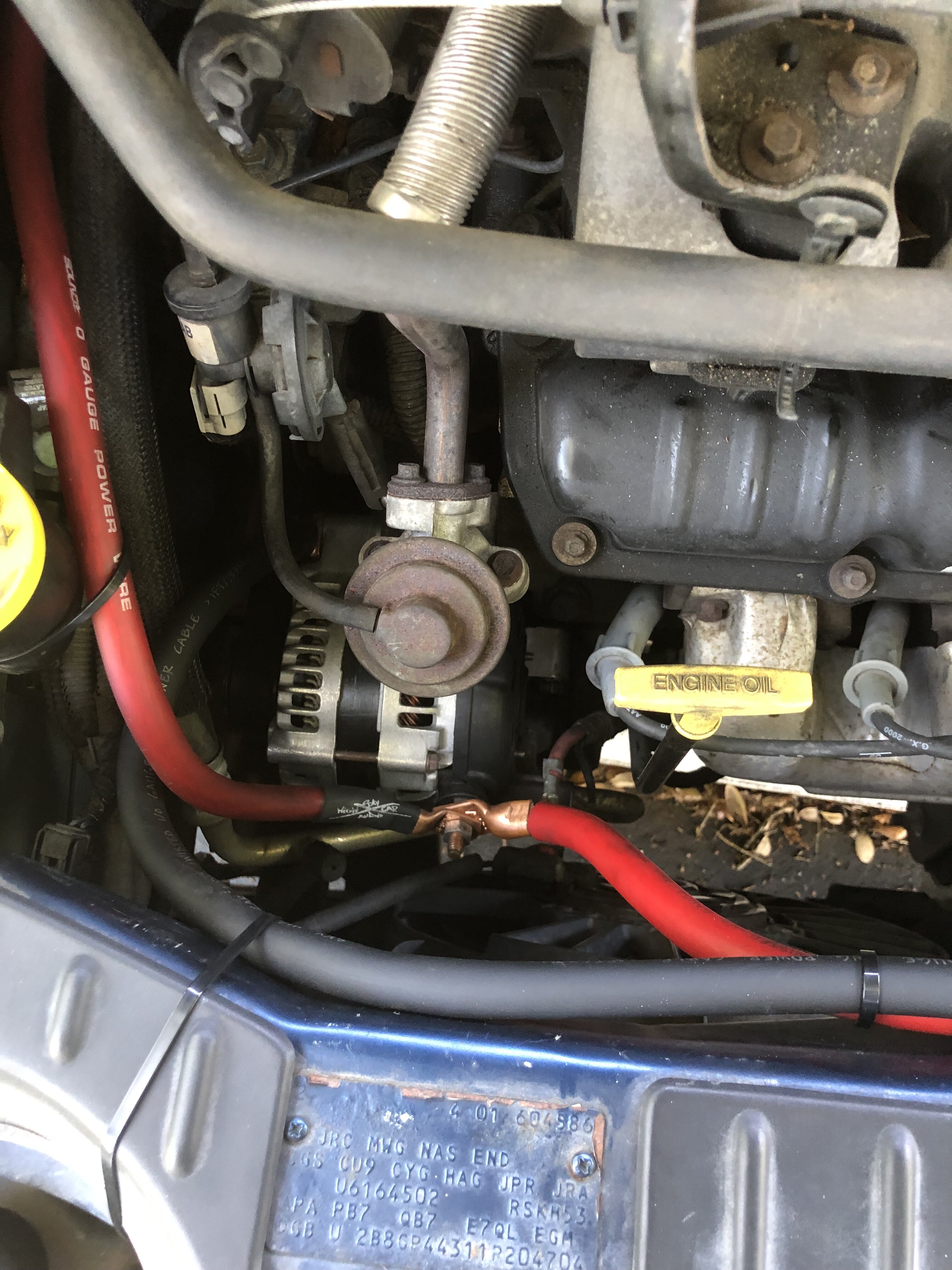

Thompson358 Posted May 8, 2022 Report Posted May 8, 2022 After months of fixing things I rushed the first time around and learning allot my build is almost done just gotta install my external voltage regulator also the box is temporary for now it’s a little small 2001 Dodge Grand Caravan -sundown zv4 with fresh rebuild all NSV3 parts from audio apex -jp43 on the sub -sfb200.4 on mids and highs -stinger 2250 -390amp alfha audio hairpin alternator -4 skar 6x9s and a set of Mtx thunderbolt components up front -2 runs of 0 guage to the back 2 engine grounds 3 grounds to the frame 3 ground to the battery i think that’s all I’m really enjoying it my first ever build let me know what you guys think!
1point21gigawatts Posted May 8, 2022 Report Posted May 8, 2022 That’s nice. The only thing that I would change about it is the prefab enclosure. Joe x or I could help you with a nice subwoofer enclosure design. Other than that, it’s looking nice. “How can we help you?” “And don’t forget to tell them that the customer isn’t always right.”

1point21gigawatts Posted May 8, 2022 Report Posted May 8, 2022 if you like aeroports then 5 cubes on an 8” aeroport is nice. “How can we help you?” “And don’t forget to tell them that the customer isn’t always right.”
1point21gigawatts Posted May 8, 2022 Report Posted May 8, 2022 6 minutes ago, Thompson358 said: I appreciate it yeah that enclosure is temporary just so I can satisfy myself until I can afford to buy some materials I can understand that. I’ve done it in the past just to have some bass. “How can we help you?” “And don’t forget to tell them that the customer isn’t always right.”
1point21gigawatts Posted May 8, 2022 Report Posted May 8, 2022 just want to know if you know that 2 4” aero ports is no where near equivalent in port area to 1 8” aero port? You probably already know that. I was just checking. Port area on that much rms and that size subwoofer enclosure is restricting the output of that subwoofer immensely and cooling isn’t as adequate as needed. Inverting that subwoofer until getting a custom subwoofer enclosure would help a bit on cooling. “How can we help you?” “And don’t forget to tell them that the customer isn’t always right.”
Thompson358 Posted May 8, 2022 Author Report Posted May 8, 2022 Yeah I wana have a custom box built as big as I can go with as big of a port as I can have lol need to make up for all the extra room in the van and I plan on inverting it when I get the external voltage regulator on because the gain is all the way down right now my van only charges at 13.4 so I get down to low 12s pretty quick unless I’m driving ☹️ And quick question can I set my external regulator to charge at 15 volts would that be safe?
1point21gigawatts Posted May 8, 2022 Report Posted May 8, 2022 I’ve read that the alternators on that vehicle and similar vehicles can charge up to around 14.5-14.7v with no problems. “How can we help you?” “And don’t forget to tell them that the customer isn’t always right.”
