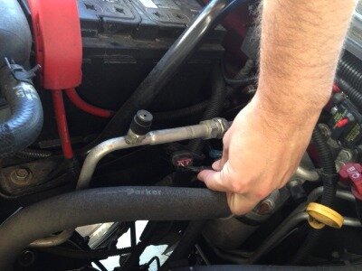

I hooked the ring terminal right on top of the negative post with the small nut on top and straight to the block. I wasn’t talking about unplugging the alternator. Right below the battery tray there is a plug. That’s the rvc sensor. You can unplug it and get no dash lights and it will charge like a normal charging system. No fluctuations. So if I’ll be good with just a single upgraded battery then I’m going that route. But I don’t want to spend money on the battery and still need the alternator later on. I guess I could do the battery and if the alternator was needed down the road I could go with the 160a stock alternator since mine is a 145a. I was originally going to go with a 250a HO alternator.
Here is a pic of that plug. That’s not my truck in the pic. I saved it off the internet. The plug on my truck was in the same area though.
Yeah, that plug is plugged into a plastic ring that goes around the ground wire from the battery negative and the block right?
