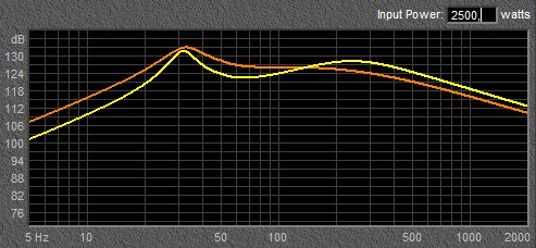

So this is what happens, 15 onyx in yellow, 18 platinum in orange, boxes 4 and 6 cubic feet net each both tuned to 32Hz:
You see that 15 almost matching the 18 but just at tuning, the 18 more musical, and likely able to go to 7 net.
Bear in mind that if 28 is for height, that's tall and close to the roof.
So stronger motor can get close but cone area is better overall.
The aim is not to upset he roof, the answer is as far as you can,  or as close as you have tested not to cause flex,BTW port area needs to be at least 75 square inches, software is bassbox.
