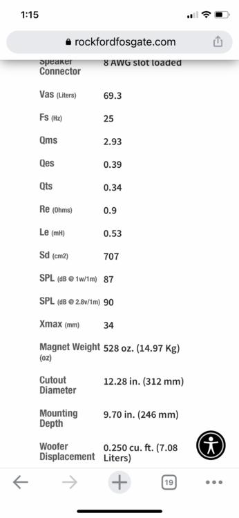

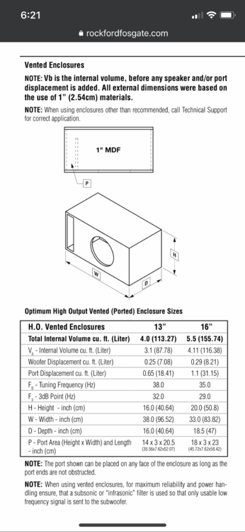

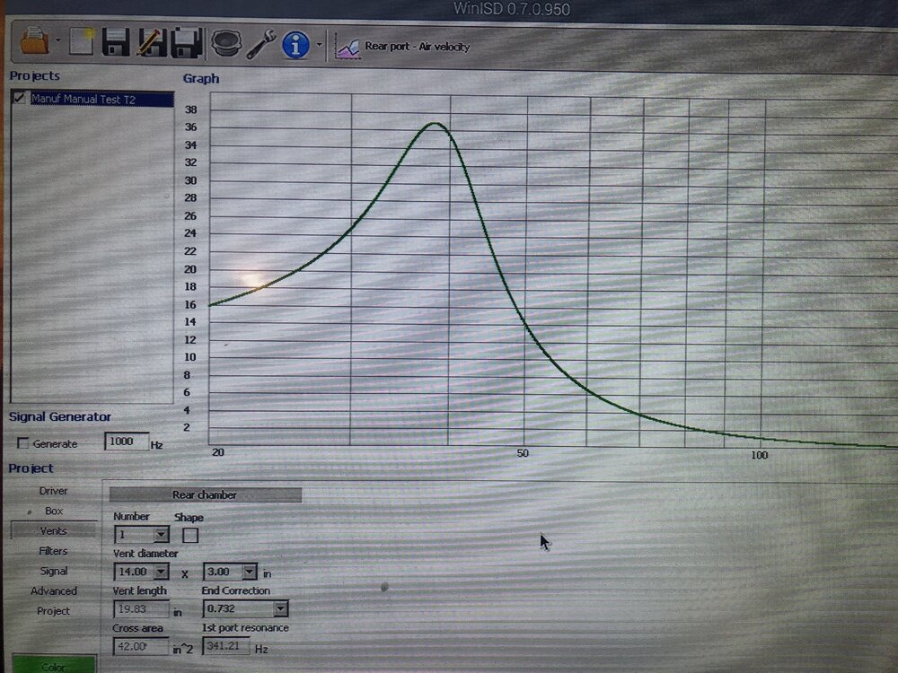

SirCake Posted October 20, 2022 Report Posted October 20, 2022 Could use some help. Building a box per the manufacturer specs for a Rockford Fosgate T2S1-13. The port velocity looks very high (36m/s) but these are the manufacturers specs. Any thoughts or advice? I don’t want this $1000 sub to be chuffing lol.

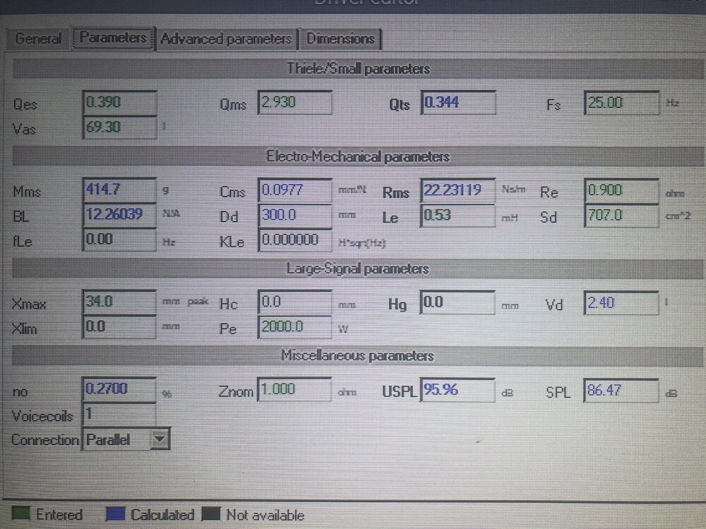

SirCake Posted October 21, 2022 Author Report Posted October 21, 2022 Does anyone mind modeling this sub per the manufacturer’s specs to see what results you get for port velocity? 2000 watts of power, everything else is exactly like RF says on the site.

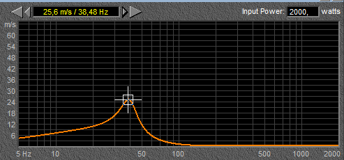

Joe X Posted October 21, 2022 Report Posted October 21, 2022 Here's the analysis with better software and correct input of data: As you might expect the manufacturer knows what it's doing.
SirCake Posted October 22, 2022 Author Report Posted October 22, 2022 I entered the numbers exactly as shown with the correct units and everything. Do you think it’s a WinISD thing?
Joe X Posted October 22, 2022 Report Posted October 22, 2022 I don't really use that program, check with someone who does to see where a mistake can be found if there is one. If there is no mistake then make your mind about using that program, as before the manufacturer would just hurt itself by issuing a malfunctioning spec, be sure they tested what they sent to print very well.
Joe X Posted October 23, 2022 Report Posted October 23, 2022 Check if you used the gross volume of 4 cubic feet instead of the net volume which is 3.1 cubic feet.
