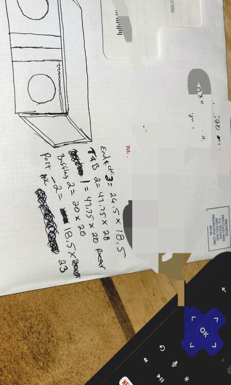

Cory2G Posted November 3, 2022 Report Posted November 3, 2022 First off new to the forum. Sure yall see this sort of question alot. Hopefully I can get some good feedback. I got a pair of SA E15 V.4's I have designed an enclosure for but would like if someone could give any advice as I have no access to a better enclosure calculator. Sorry in advance for the scribblage
Cashdollar2009 Posted November 3, 2022 Report Posted November 3, 2022 Hey Cory, welcome! Is there a reason why you are drawing it up as two separate chambers/boxes instead of a shared chamber for both subs? Also, what amplifier are you running? Either way, I am coming up with the following based on your dimensions pictured: Net Volume: 3.72 ft^2 Tuning Frequency: 39.76 Hz Port Area: 64.75 in^2 On 6/30/2011 at 1:11 AM, 'Ray' said: Acoustical energy is free. Electrical energy is not.

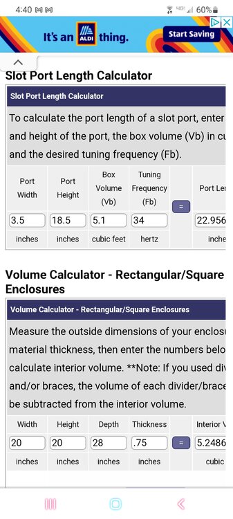

Cashdollar2009 Posted November 3, 2022 Report Posted November 3, 2022 If you were set on running two separate chambers, the following puts you right around Sundown's suggested numbers: 20H x 20W x 27D Port Dimensions: 18.5H x 2.75W x 30D Net Volume: 3.27ft^3 Tuning Frequency: 34.19Hz (The tuning frequency you requested above, Sundown suggests 32Hz tuning for these E15's) Port Area: 50.88in^2 If you built two of these and joined them together as it looks like you were trying to do above, you'd only need 40W x 27D for the top and bottom pieces. On 6/30/2011 at 1:11 AM, 'Ray' said: Acoustical energy is free. Electrical energy is not.

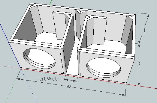

Joe X Posted November 7, 2022 Report Posted November 7, 2022 I would recommend you the shared port design:
