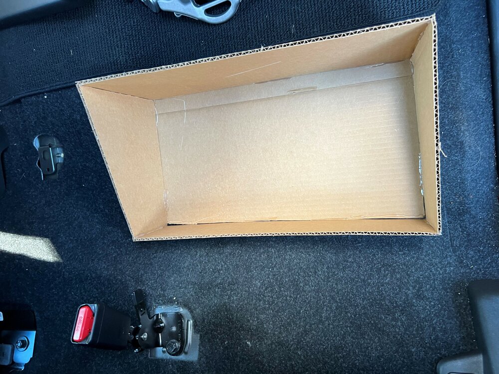

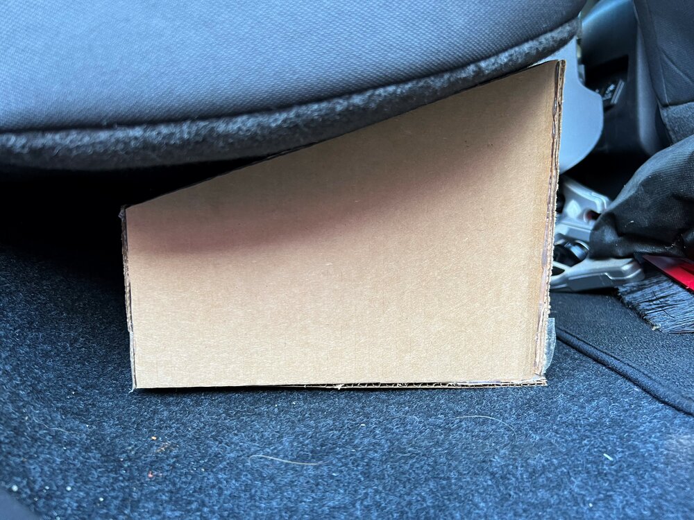

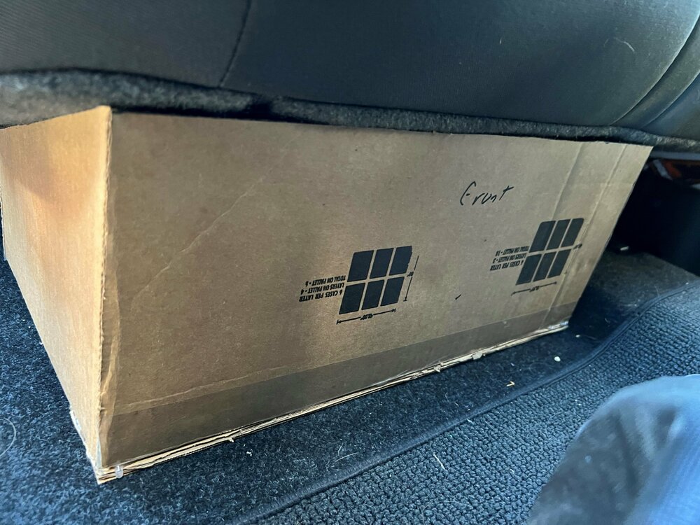

i want...no i NEED some bump back in my new truck. problem is there's almost zero space...
i did some measuring and the max amount of space in a normal sized box i could do is .333
in a 17x9x7x4 box. wedge shaped.  and i have no idea what to do about a port.
which leads me into the 6.5 group of subs.
my problem is im scared to go through with buying everything and it not sounding good.
is a box that small and little sub able to do what i need?
ive used 8s 12s 15s in my previous vehicles so im worried that the tiny guys wont do me any good...
maybe someone will have an idea or opinion for me.

this was my first thought. but getting the shape is almost impossible because the middle bit would be like 2 inches wide and the other side would end up like 4... theres no under seat room in these without fiberglassing the bottom.
cant remove a seat. kid has to go back there, which also kinda eliminates poking the box out. it would get tore up and take away from his leg room.
these little trucks didnt come with much aftermarket sound space.
ill probably just end up going for it and see what happens...
