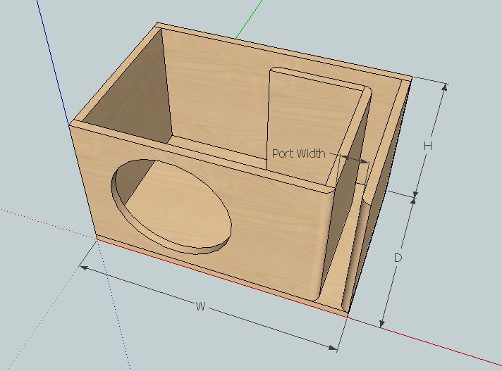

Hey everyone, I recently bought and installed two Rockford amps, one 4 channel for the speakers, and one mono for the sub. I bought a 12" DD SL600 as well and have it in a sealed box because the ported box the shop offered were all massive. Is there anything else I might need? The shop did talk to be about the potential sound benefits of having it in a ported box but I couldn't find one that was small for a 12" sub, what're your thoughts?

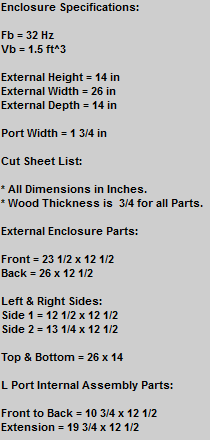

Ported enclosures are louder for the watt than sealed enclosures like you have, so I guess your question is if there is something in between the large ported boxes and a sealed, so I came up with a smaller ported box for your sub that still let you experience most of the benefits of ported designs while not being as bulky.
If size is suitable and you have a trunk car you can build or have someone build the following:
