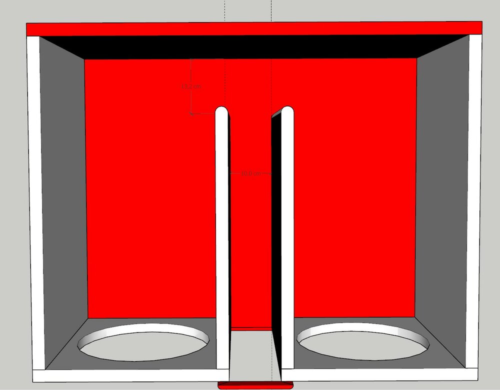

Hi, can I do my slot port like this?
I readed something about divider but If i have two exactly same subwoofers and one amp, do I need to split this port?
12.2 > 10 so you are far enough from the back wall for it to work properly. You can just build it like that.
