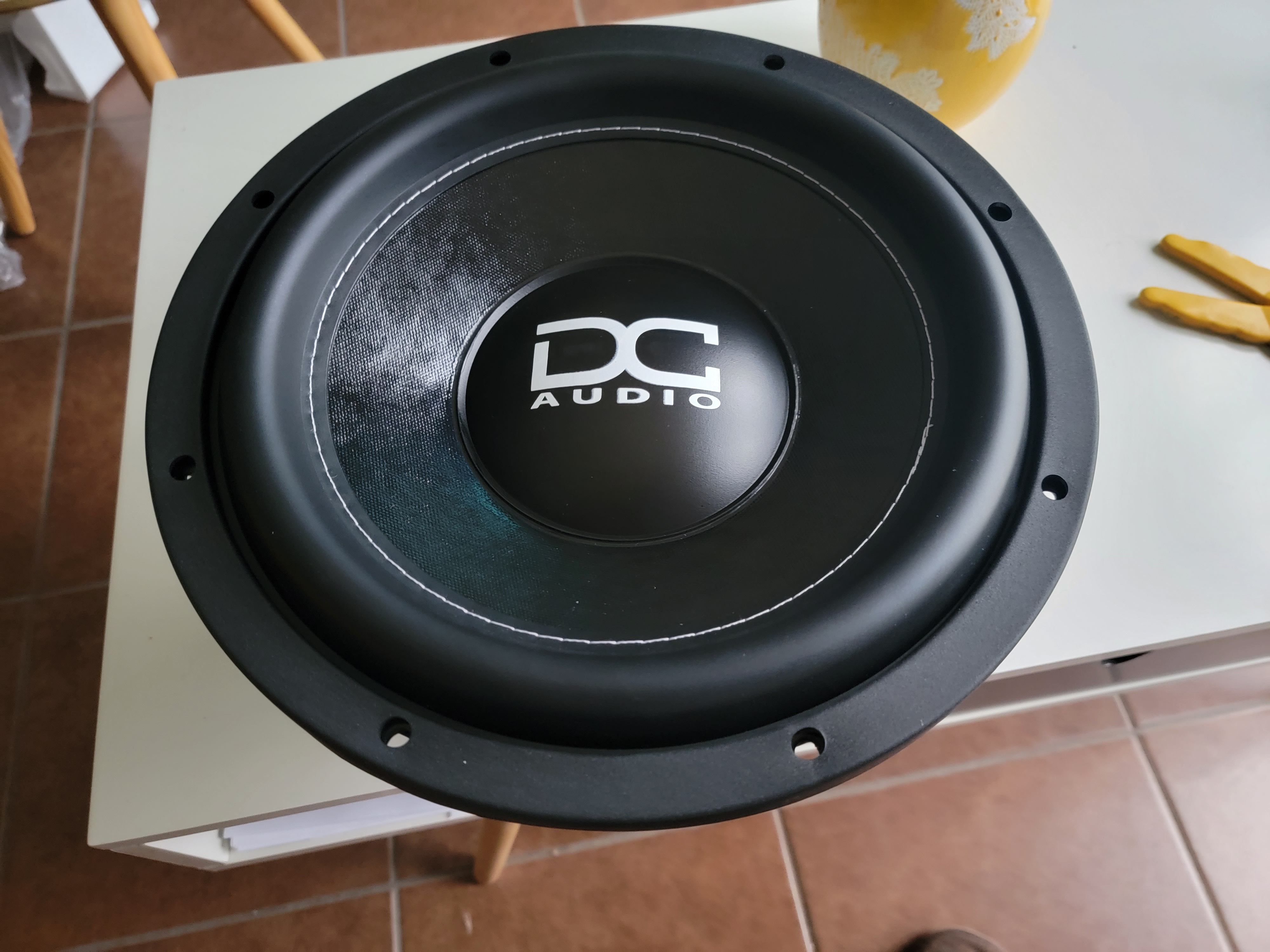

Subwoofers - 4 DC Audio Level 1 12s D2 wired to 1ohm, tuned to 33.5 Hz

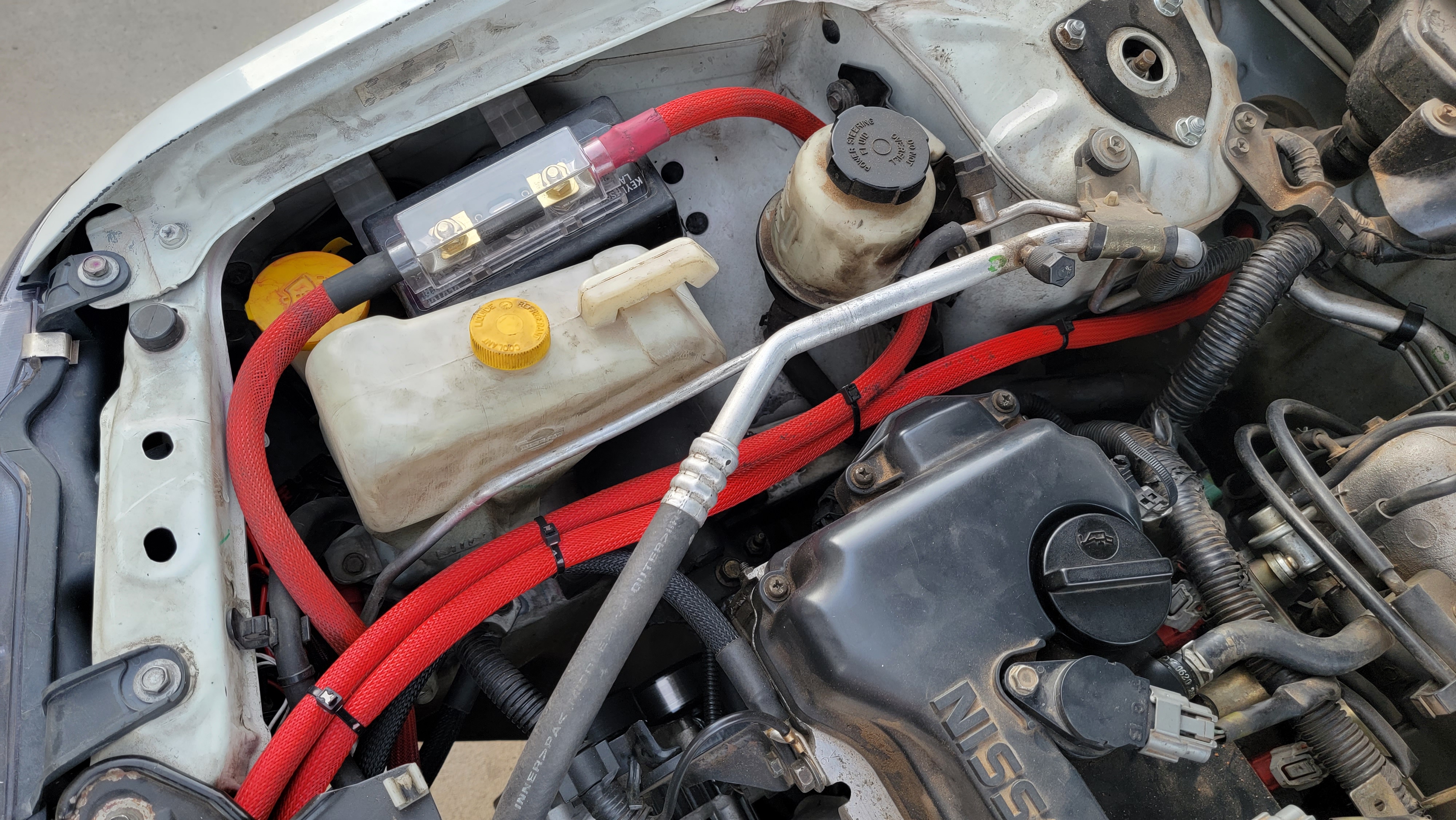

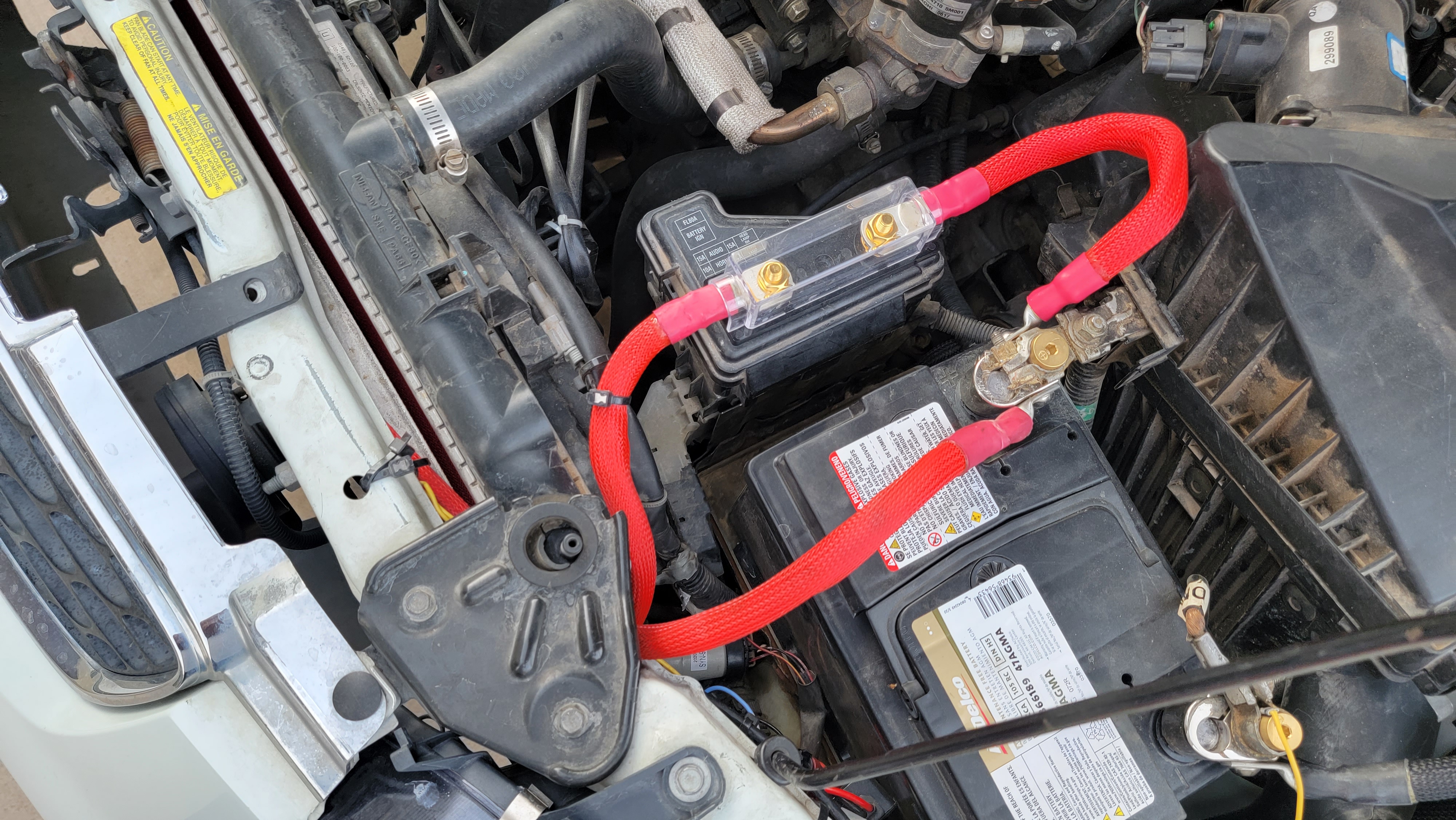

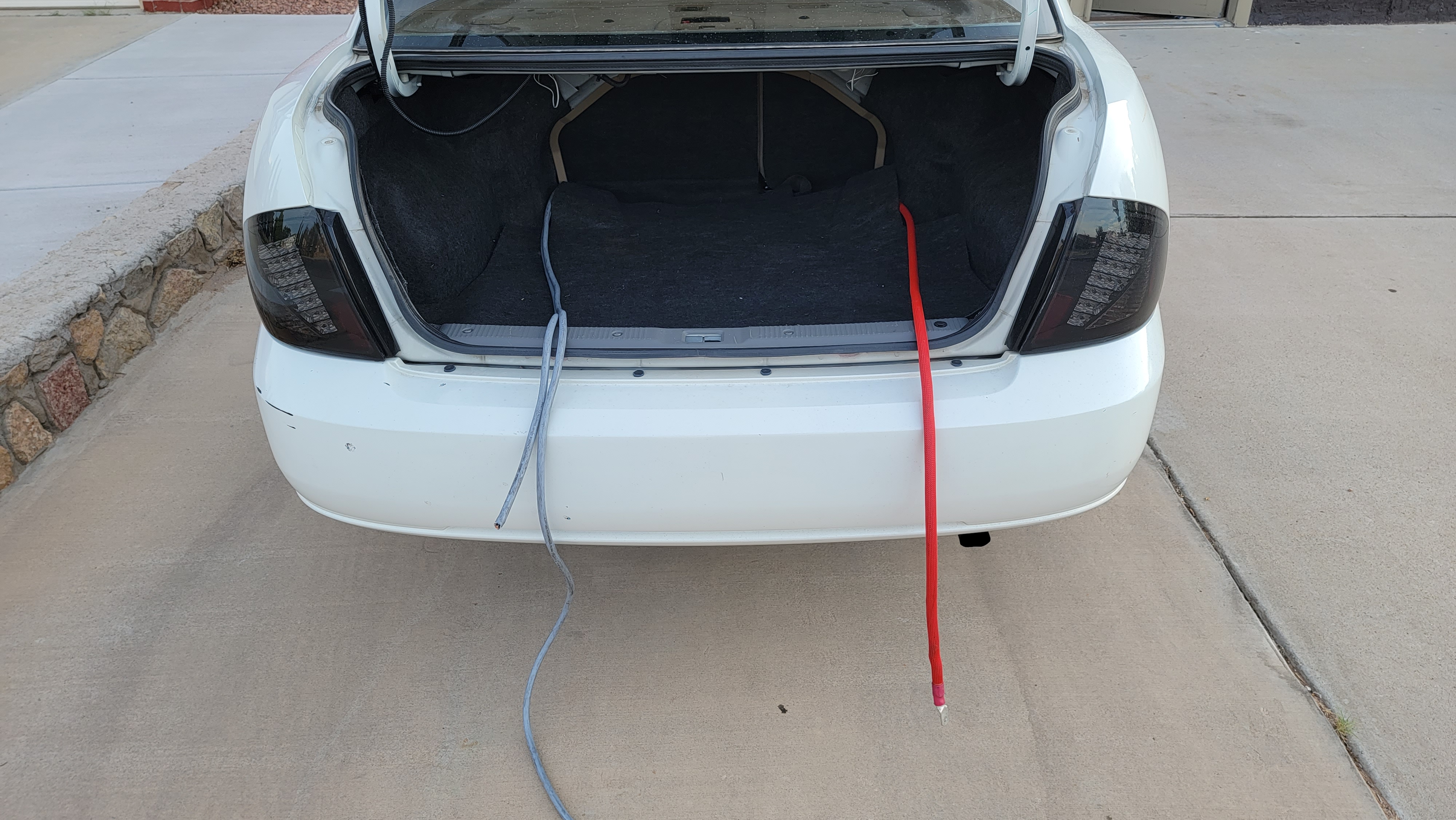

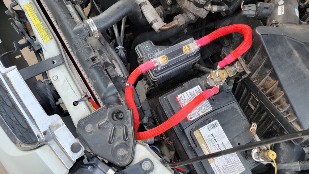

Installed a 250 amp I powered alternator and a 60 amp hour AGM battery under the hood. I ran 2/0 welding cable from the alternator to the battery and then to the rear of the car. I did the big 3, fused shortly after the alternator and shortly after the battery.

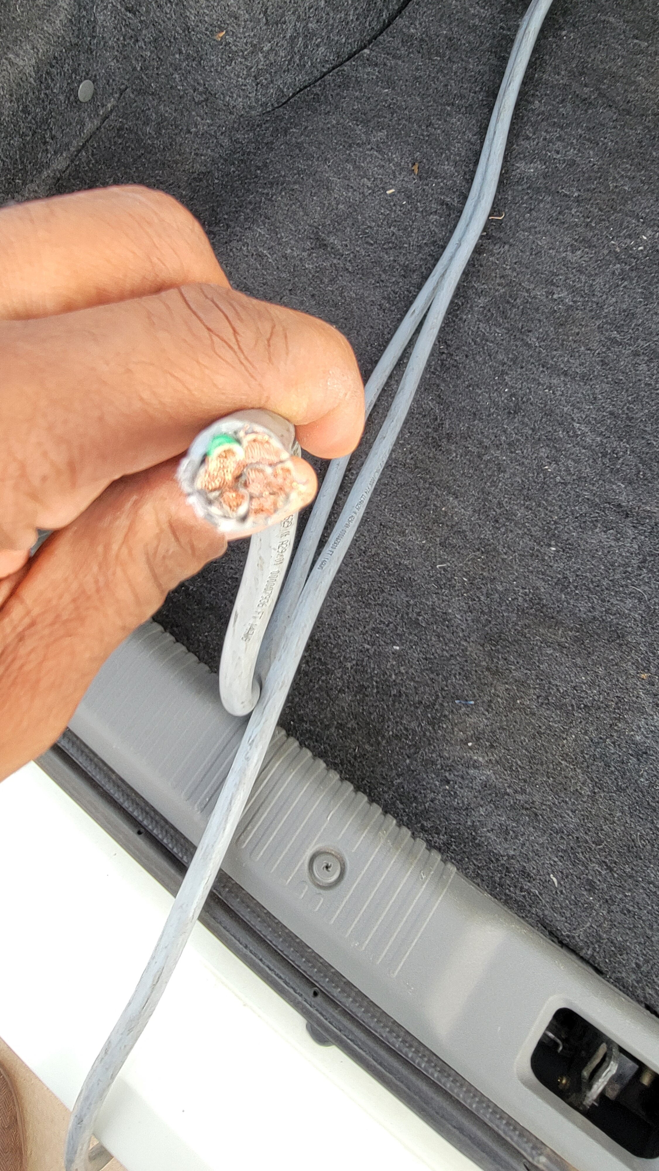

I also ran speed wire from the front door panels to the rear which has seven 14 gauge wires contained within the gray jacket.

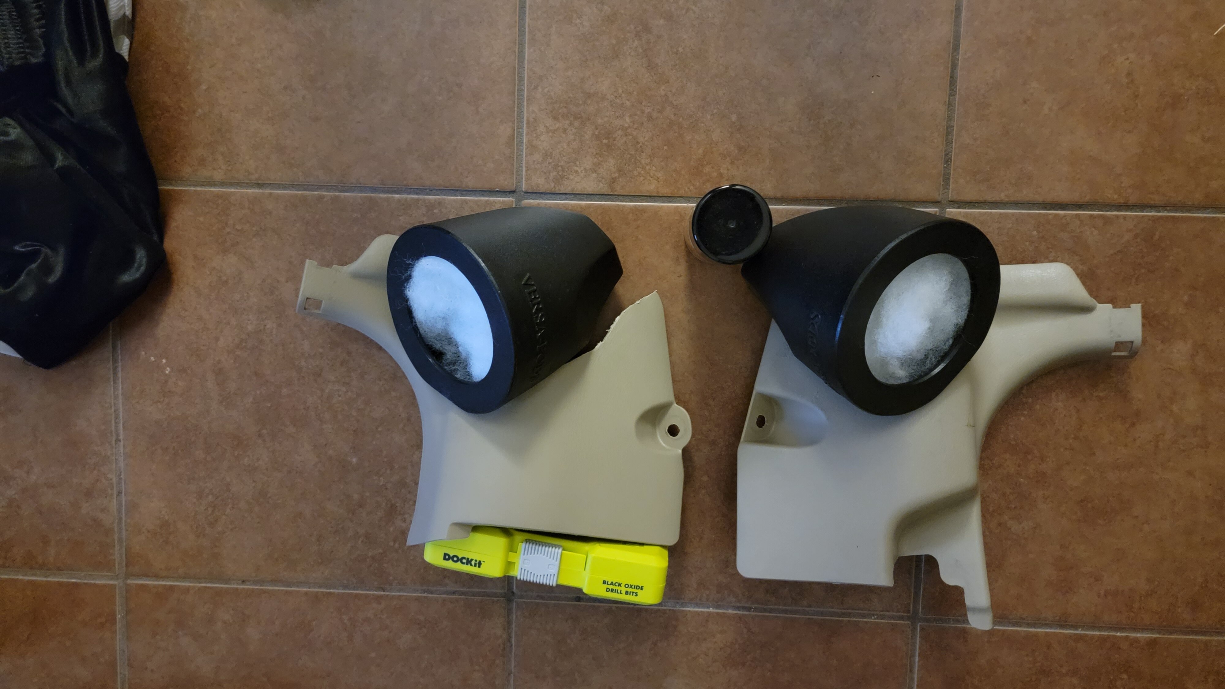

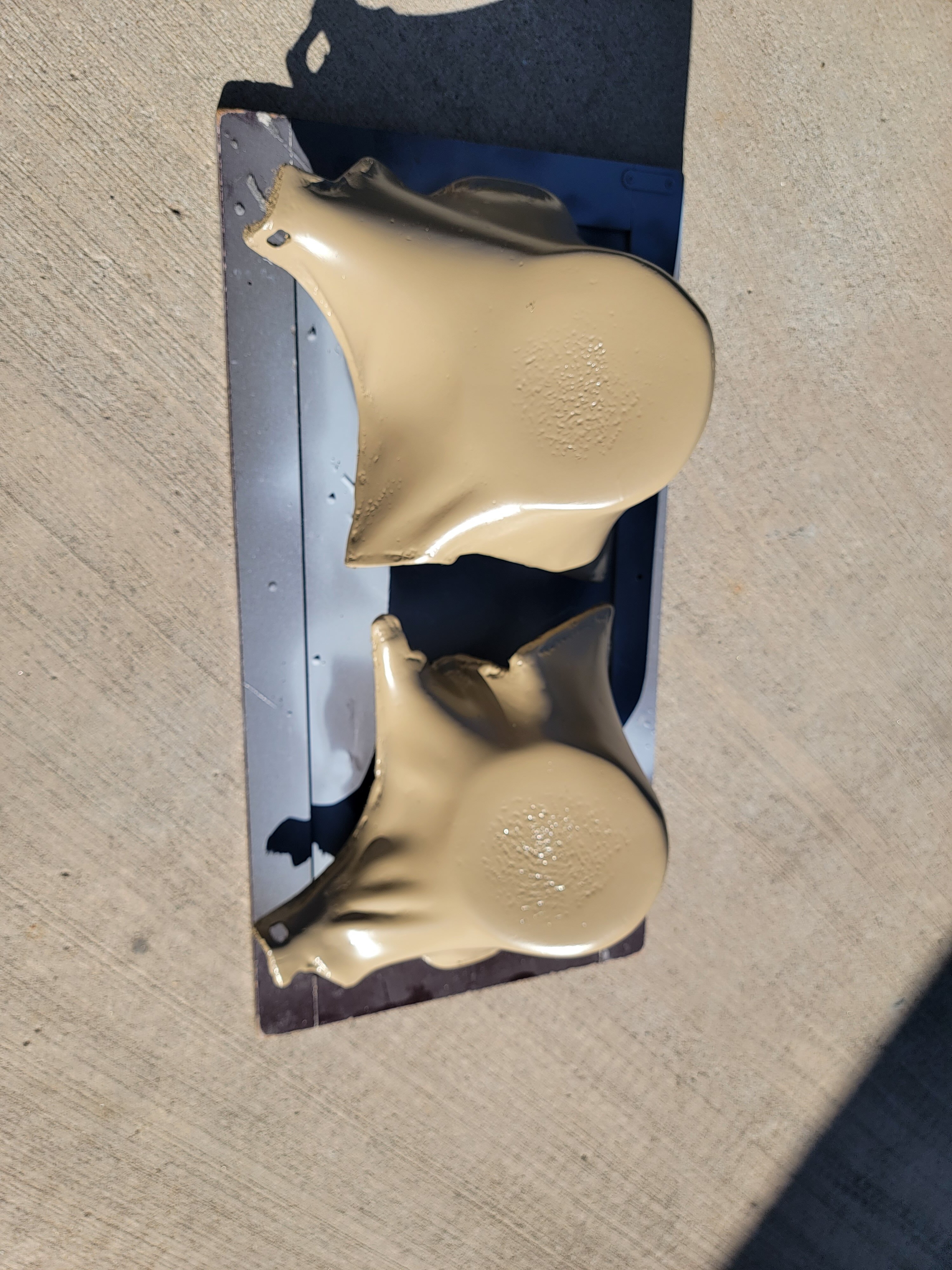

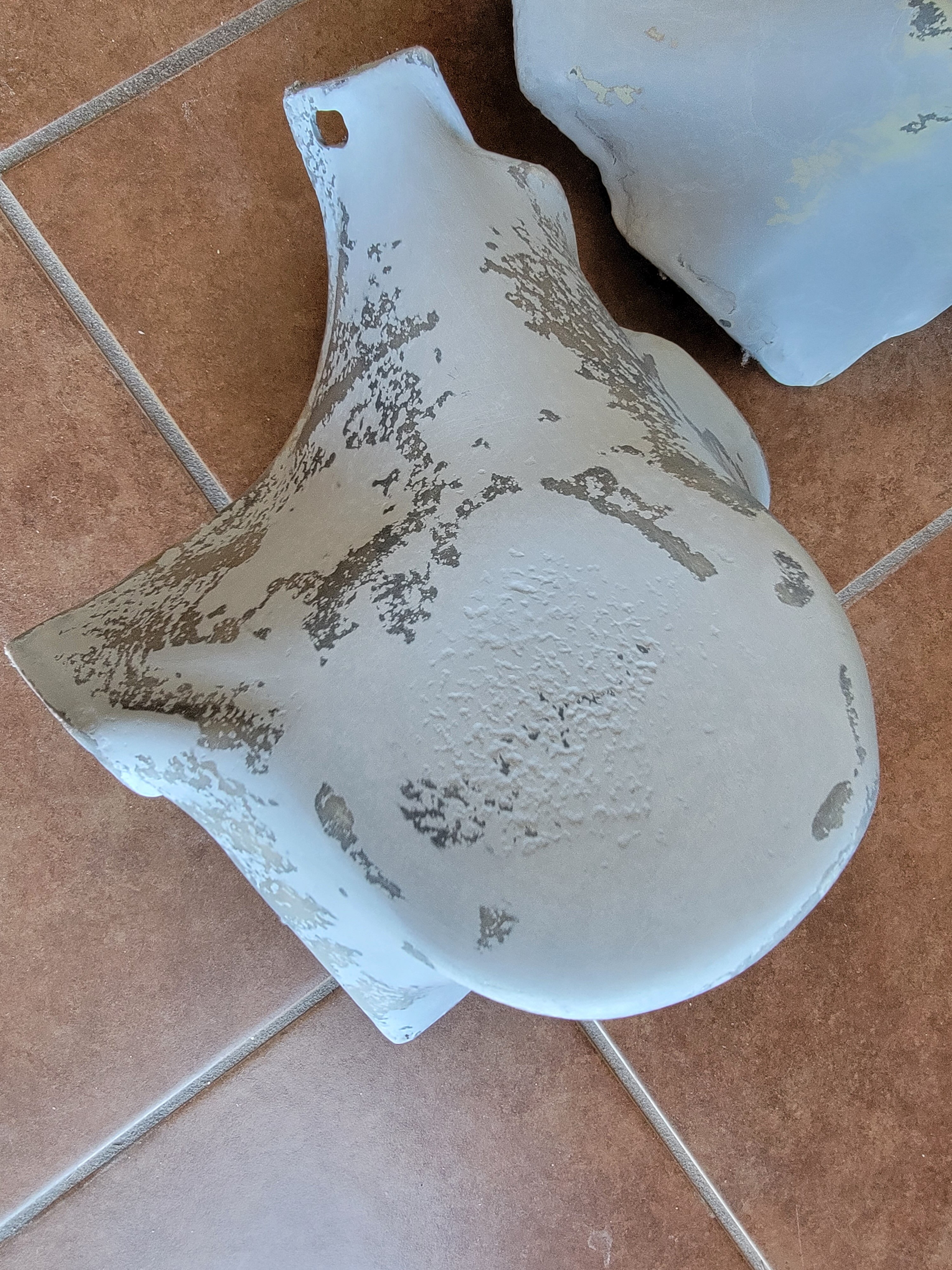

Speaker Pods:
I drilled holes in the sail panels sanded them down and molded the tweeter housing to fit within.
I also made custom fiberglass kick panels.

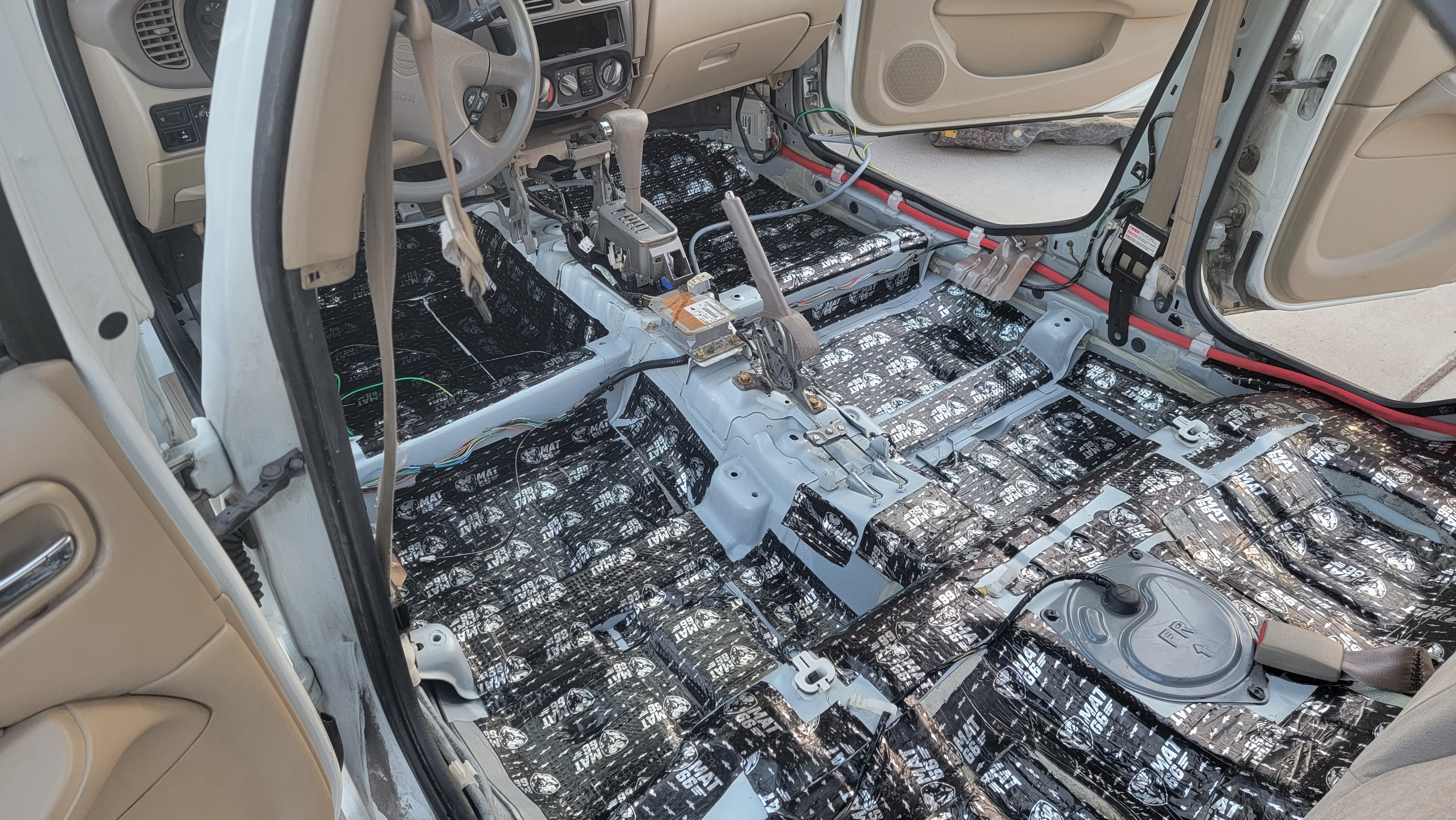

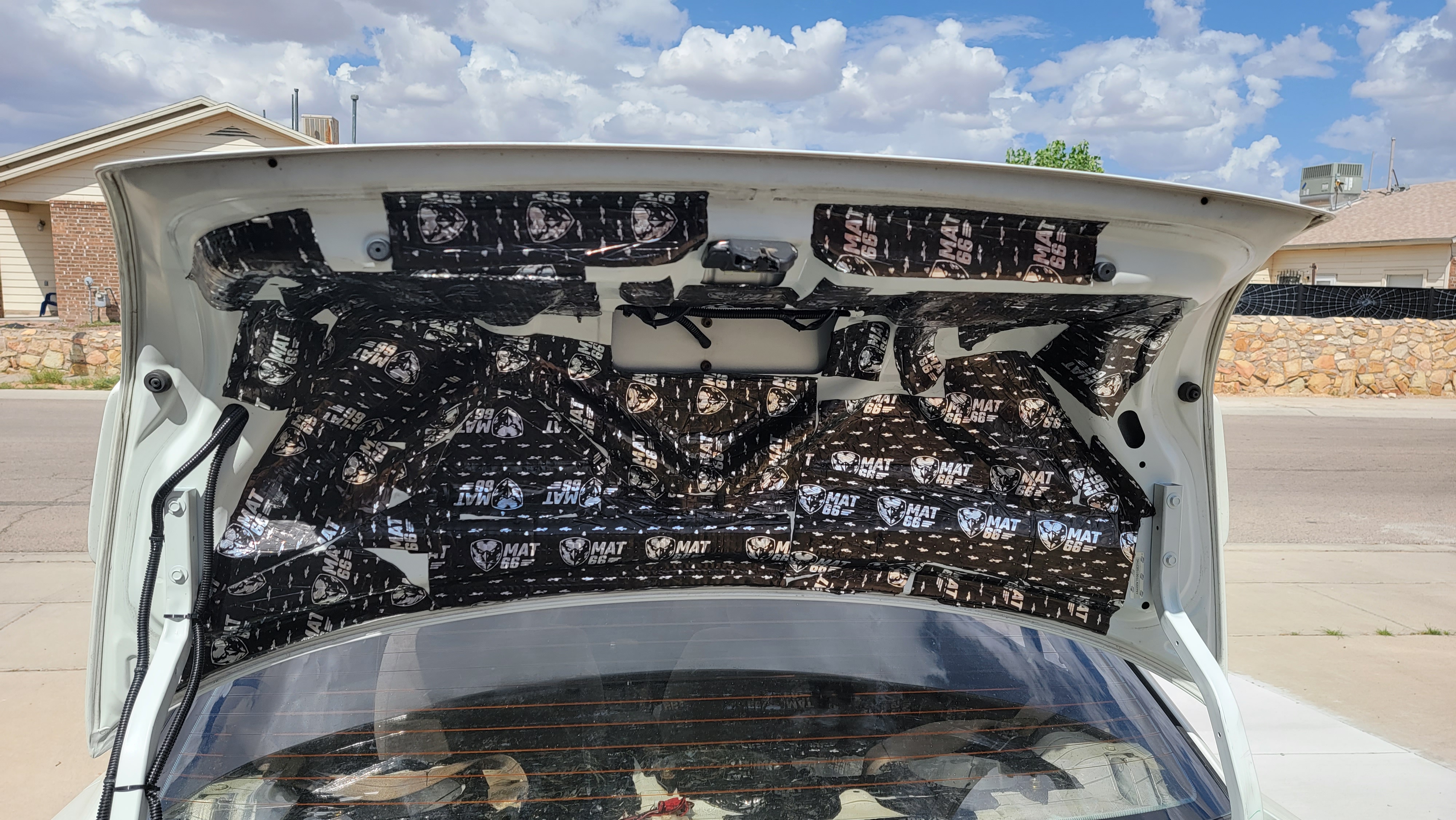

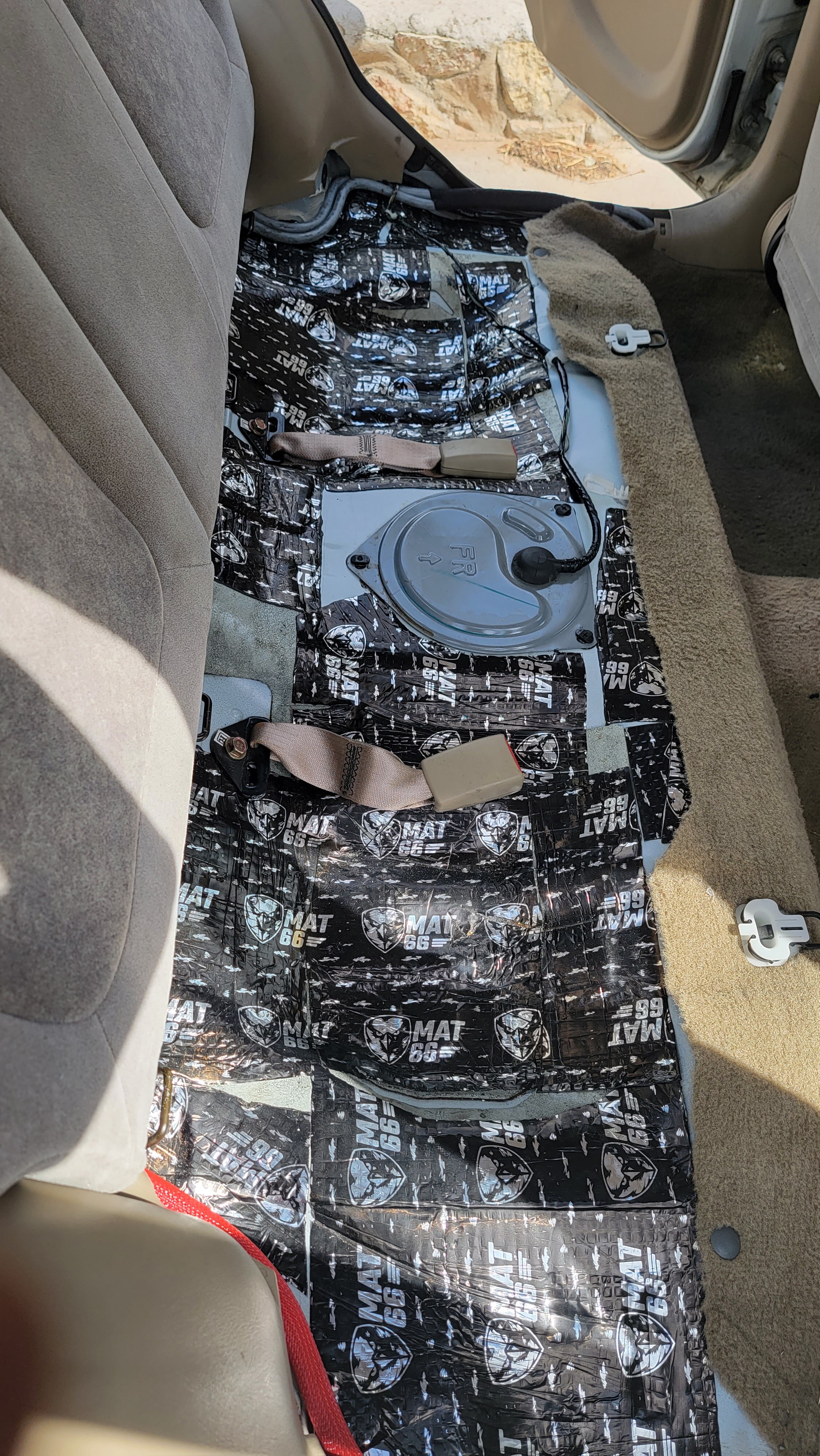

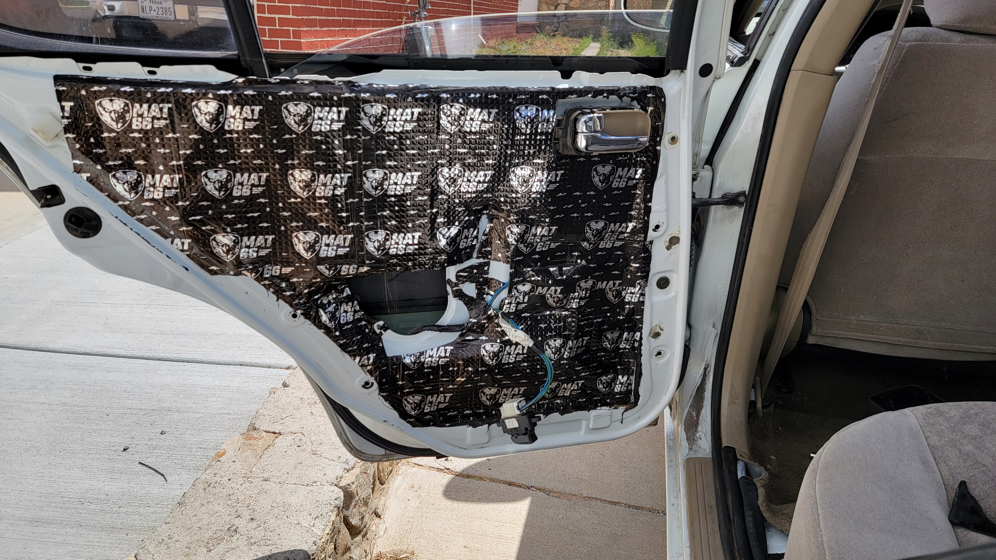

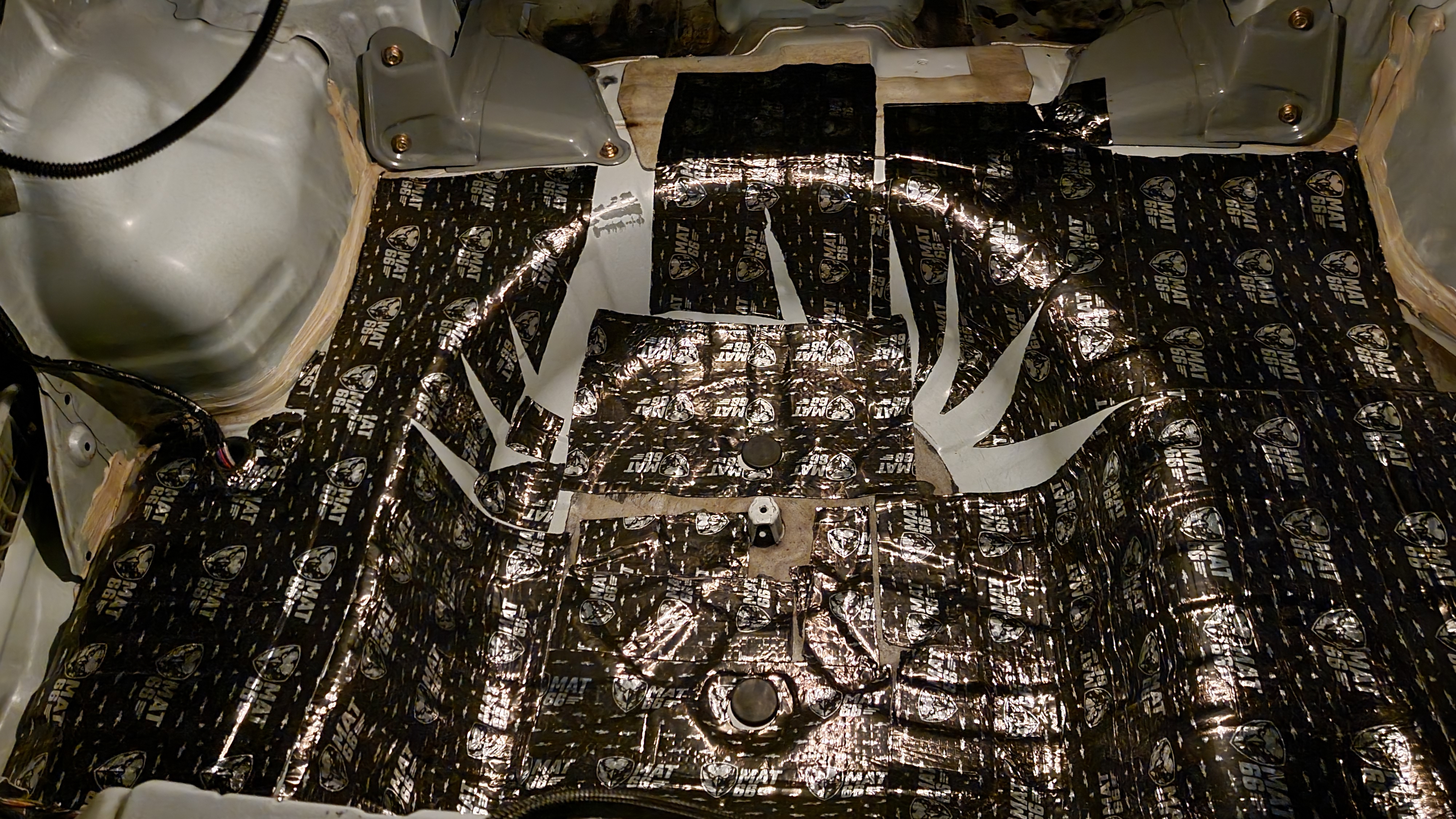

Sound deadening:
I took the entire car apart:
20220806_212726.thumb.jpg.31f4c4e6bf4385ed41803c17666a3baa.jpg20220807_152714.thumb.jpg.a72c6ccbc8e1856dae49026a8286149d.jpg20220809_153218.thumb.jpg.ce4c04fb5d14cb3b3fbdaa7bb4e0d92e.jpg20220812_151713.thumb.jpg.ffd4bbccdc162d69b7acc2cbc0795f5b.jpg20220813_191919.thumb.jpg.f2d3cada54e133d4dabb39186f87cf1f.jpg
I did the doors, roof, and the entire interior. Once that was done I installed the speakers and the kick pods.
I'm waiting on the amps to arrive so I can make my amp rack. Next I'm building the enclosure for the DC Audio subs.

FYI the entire car is deadened. The trunk has a double layer. Because once I get another $1000 I'm dealing the level 1s and getting level 3.
