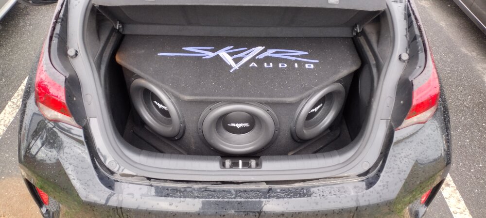

Kreg Posted March 2, 2023 Author Report Posted March 2, 2023 I am running them in a Skar box (SK3X12V) in a 2019 Hyundai Veloster. The real question hear is do you think the 3 EVL's or the 6 SDR would sound better / Hit harder?

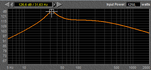

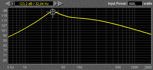

Joe X Posted March 2, 2023 Report Posted March 2, 2023 Can't directly answer your question but here is a comparison of each sub in the same box (2 cubic feet @32Hz 25 square inches of port area) on their respective rated power SDR 12 EVL 12 The numbers are not important but the difference is. It's 3.4dB and it's mostly due to the higher power handling of the EVLs so you are doubling power but cone area remains the same. In the second case you are doubling power but also you are doubling cone area, in this case the gain is 6 dB. Roughly the 6 SDRs would be 2.6 dB louder than the 3 EVLs and that is not a very great difference at all but a difference still. Now I think that the super small 3 sub box is by itself holding back your performance and using two of them if they even fit at all sound like a bad idea. In such a vehicle a 6 12' box should be a wall really.
Kreg Posted March 2, 2023 Author Report Posted March 2, 2023 If I did go with the 6 then a second box was the idea and it would fit but would just about be a wall as they would have to sit mostly in the back seat but I will probably go with the EVLs with future plans of doing a wall with 3 more EVLs or something along them lines but now I am even debating on the change to only pick up 3-4 db over what I have I will have to ponder over it . I thank you discussing it with me hear is what it looks like now if you wondered
Joe X Posted March 2, 2023 Report Posted March 2, 2023 Looks great as is, maybe some VXF 12s could get you closer to a respectable gain, unhappily accurate specs for that box are not available, also there are DC audio which are higher tier subs that work on small boxes and handle a lot of power.
