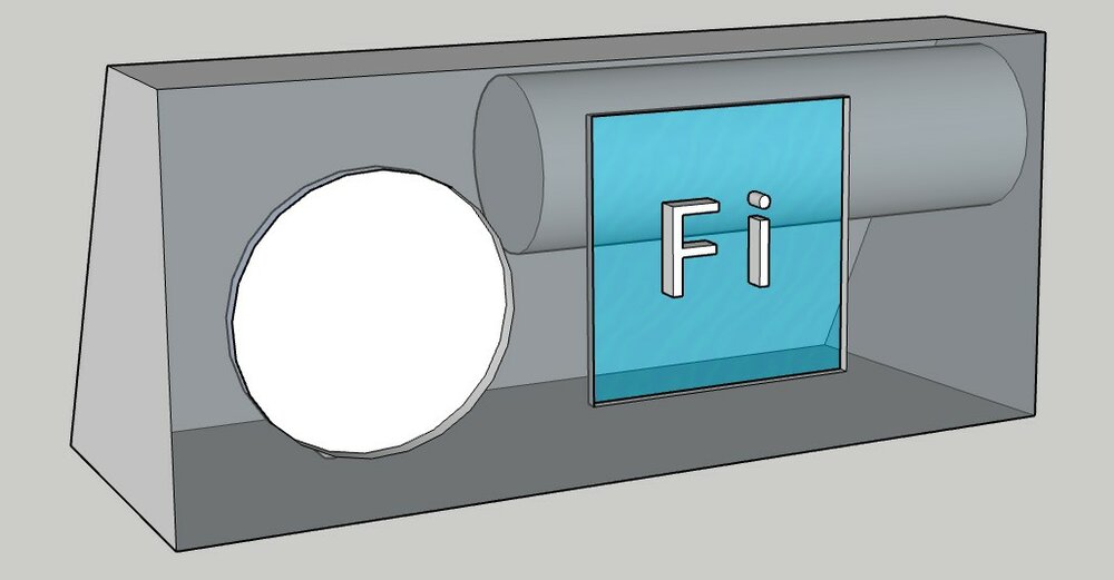

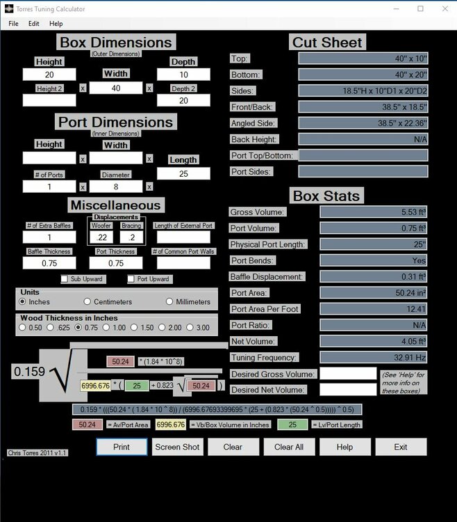

Hey what's up guys, I am trying to get some input on a box design I'm working on in Torres/Sketchup.
I had designed a box with Led lit plexi that fit over the wheel well in my 4runner, but I want to try something a bit different this time.
Can someone with experience lmk if anything about my design numbers should be tweaked?
The 1st rendering I was thinking about invert mounting the team on the side, but I think i'd give up more air space than it's worth by making the box narrower.
The 2nd is what i'm leaning more towards is a rear firing with side port.
I have big 3 done with 250 brand x. Saving up for a few banks of yinlong and a surge 7k, so in the mean time i'm trying to get the box done.
I'll have to get a better estimate of bracing displacement, 45's/Dowels.
The inner end of the port should be as far as possible from the sub,  the first design looks like really asking for trouble.
