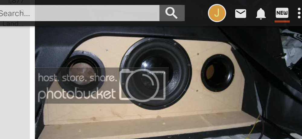

Joshuadrake Posted March 9, 2023 Author Report Posted March 9, 2023 I’d like to have the sub facing forward with the seats down with the box sealed off from the trunk. Kind of like this
Joe X Posted March 9, 2023 Report Posted March 9, 2023 Your only option to do that would be two very long (20.5") 4" round port but that would not be enough port area for that sub on that power. Two 5" PVC pipe (not easy to find) would work but each of the ports would be need to be about 33".
Joshuadrake Posted March 9, 2023 Author Report Posted March 9, 2023 Yeah, I thought the arero ports probably wouldn’t work with what I’m trying to do go for. Would two slot ports work better or is this design just not realistic and best to stick with one slot port?
Joe X Posted March 9, 2023 Report Posted March 9, 2023 You can do anything you want if you think it's worth the effort, the simplest and best solution is doing a single slot port on the side with the box moved a little back to give the port clearance to breath properly. Anyways here is 4.5" metallic pipe you can use, two of those wold give you enough port area and the ports wouldn't be a long as 5" pipe. https://linedividers.com/products/4-1-2-od-schedule-40-steel-pipe-x-7-0 You could do two slots which would be inefficient and the inner end would probably meet on the back of the box or U turn them and add more efficiency problems. You could do octoports if you have the tools and you know your way using them,
