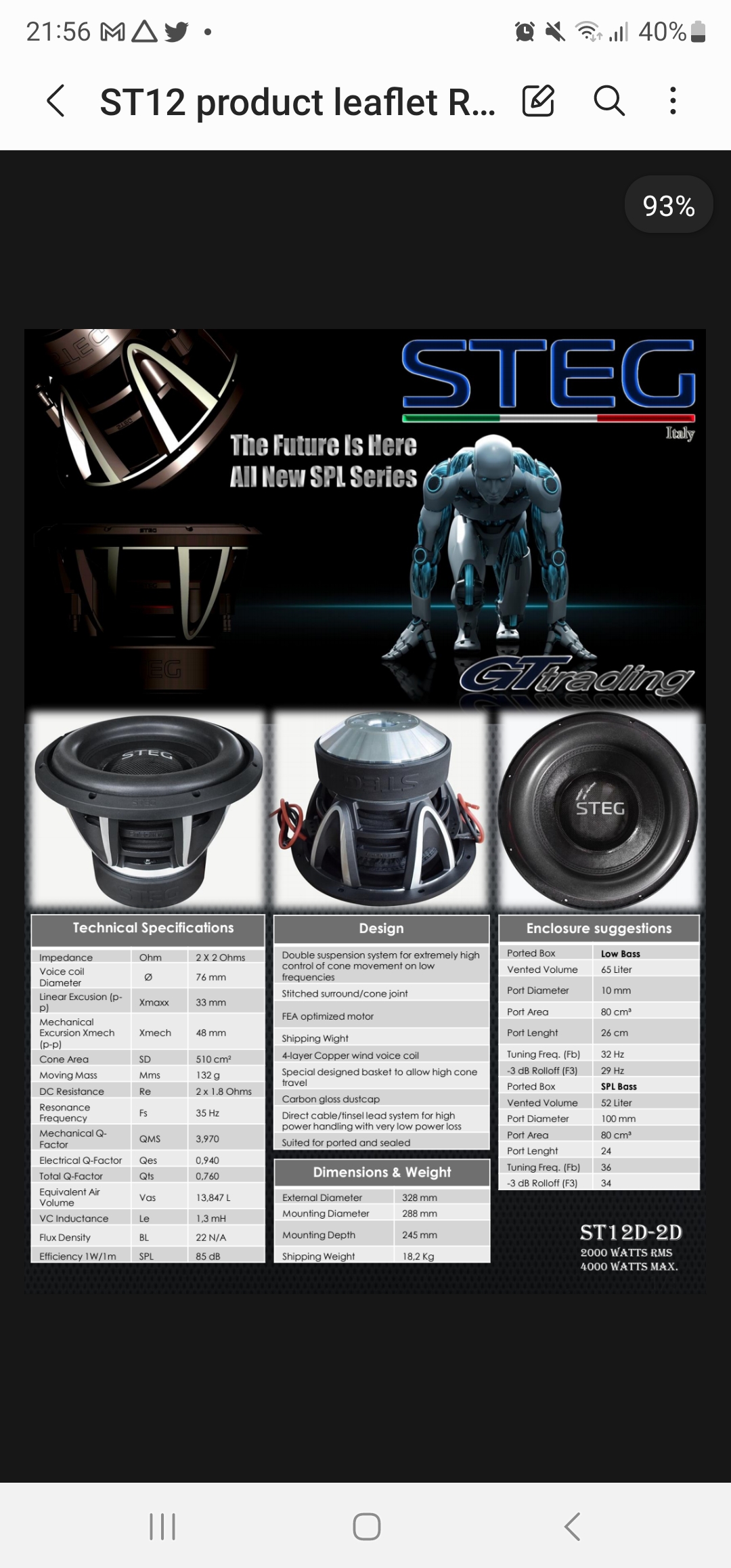

beau123 Posted March 21, 2023 Report Posted March 21, 2023 Hi I want to build a ported box for the steg st12d2. I want to build the low bass one but dont know how to calculate everything. It is going in a seat leon cupra 1p It is the same platform and size as a vw golf mk6 ST12 product leaflet REV01 (1).pdf
Joe X Posted March 22, 2023 Report Posted March 22, 2023 Port area in cubic centimeters?? Anyways I can figure that one out but I do need your max dims for a box, ( trunk measurements: height , Width, Depth) as I don't have that information for your vehicle or the Golf MK6. Also need to know available wood thickness in your country, in countries that use metric units 18mm should be available but you need to confirm that.
