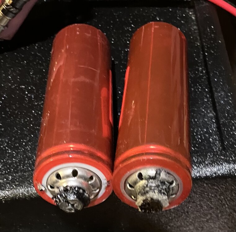

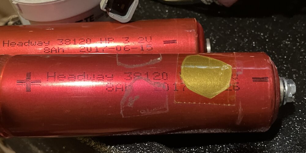

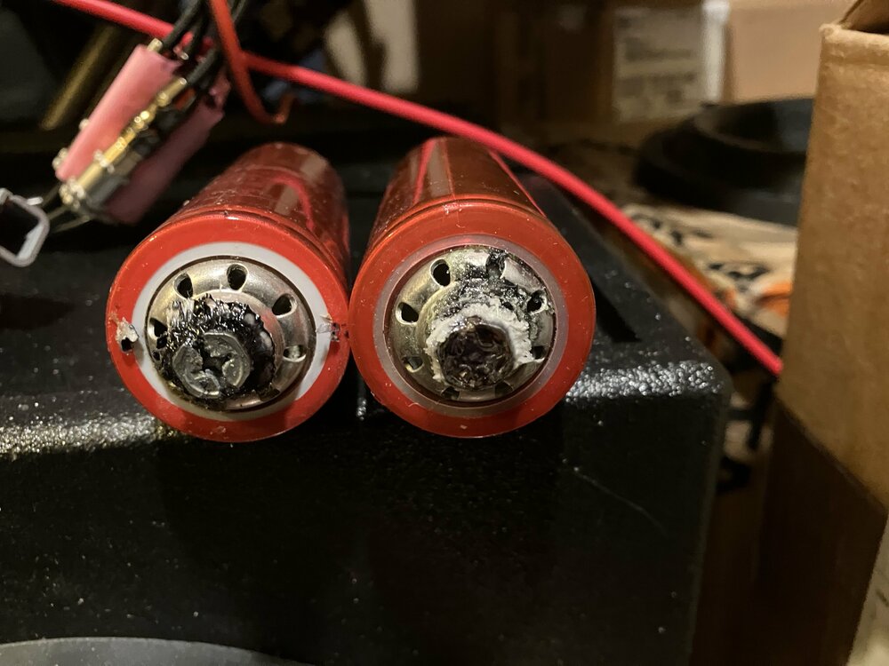

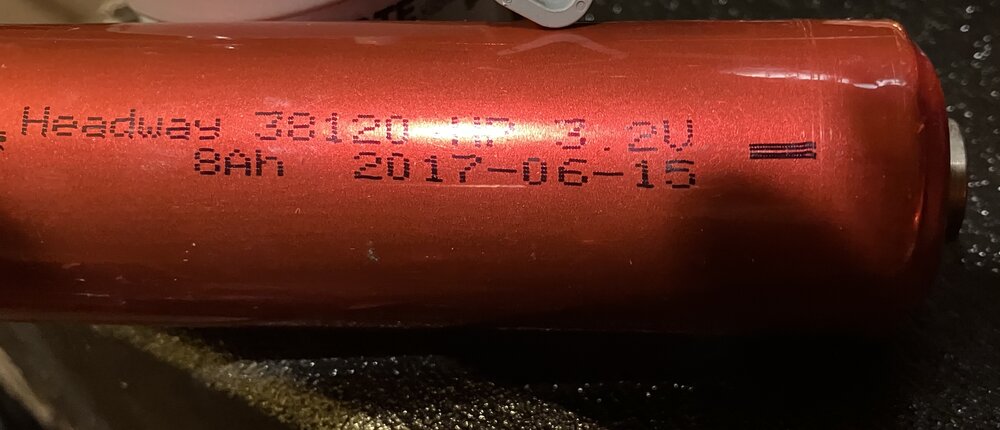

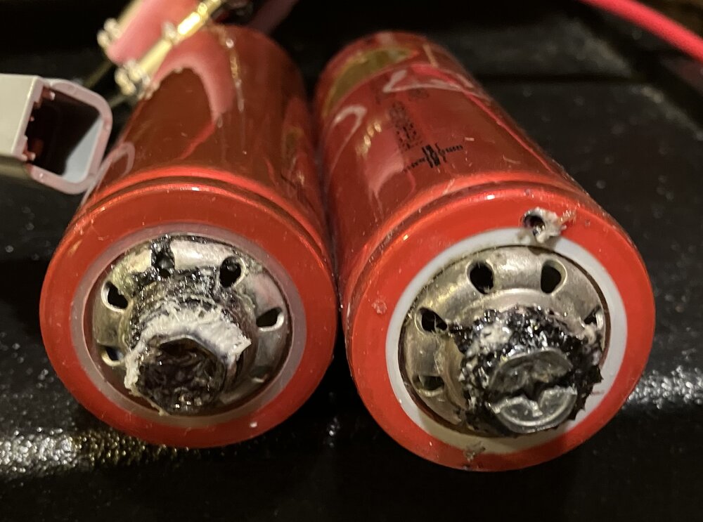

dasfriek77 Posted April 10, 2023 Author Report Posted April 10, 2023 2017 wasnt a good year for Headway cells. I had 2 unopened box’s of headway cells for sell/upgrade with, These 2 were in that batch so i had to inspect every cell i had. I did notice an odd smell in my bench test area, It smelled like a musty electrical smell. I will be double checking my 96AH headway build thats installed in my car. Doesnt say much for cell life. Quote
SnowDrifter Posted April 10, 2023 Report Posted April 10, 2023 Confirm unopened? If so, those things were used, abused, and put away wet before they ever made it to your doorstep. Yikes. Quote ~~~~~~~~SAY NO TO PHOTOBUCKET~~~~~~~~ Snow's DD-1 tracks here: https://www.stevemeadedesigns.com/board/topic/167433-snows-dd-1-tracks/ My take on OFC vs CCA: https://www.stevemeadedesigns.com/board/topic/110381-things-that-piss-you-off-in-the-car-audio-world/?do=findComment&comment=2461444
dasfriek77 Posted April 10, 2023 Author Report Posted April 10, 2023 I know i didnt open them and they were sold to me around Christmas from Batteryhookup. They were to be used for a project i was helping someone build, But he swapped his Headway cells to me for LifePo4 prismatic cells. Ive never gotten a bad cell before and they had to see it wasn't right. But every time i order Headway cells i always get 2 extra for occasions like this. I better not find any cells like this in My Headway 96aH battery already in my car. But im going to inspect it. Quote
