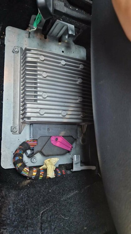

I own a vw scirocco R 2010 which has dynaudio speaker system and an amp under passenger seat

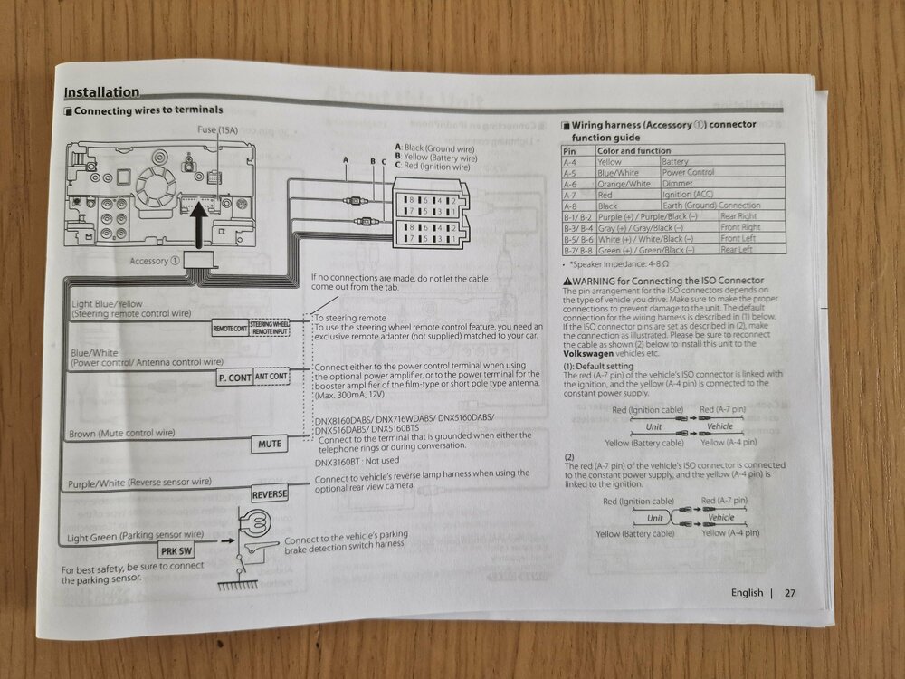

I have bought a kenwood DNX8160DAB HU

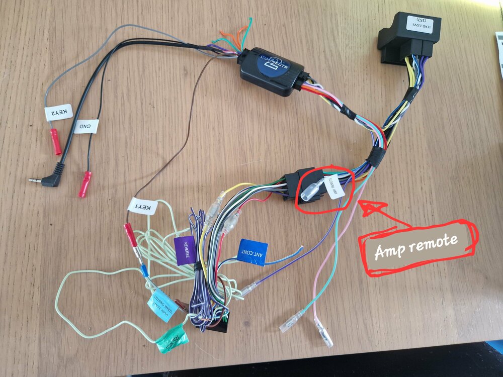

I'm not sure if I'm getting signal to amp or not?? It's just the factory standard amp under passenger seat, I don't hear it fire up but also don't hear it fire up with my factory HU (RNS510) So I'm unsure if it's connecting with new HU or not??

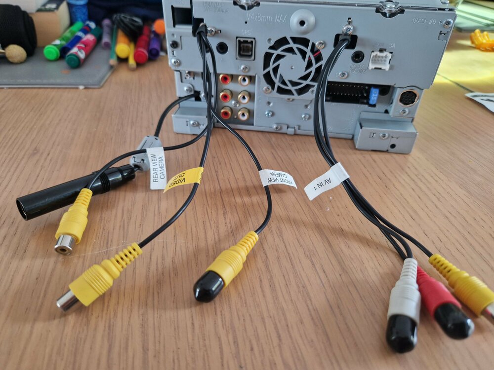

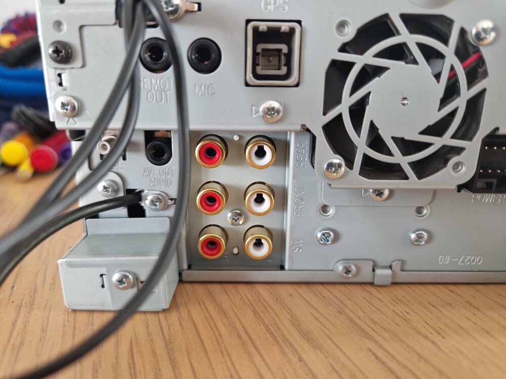

I'm hoping someone can help as it's beyond me, I have taken photos of my wiring and connects2 info and my kenwood wiring book

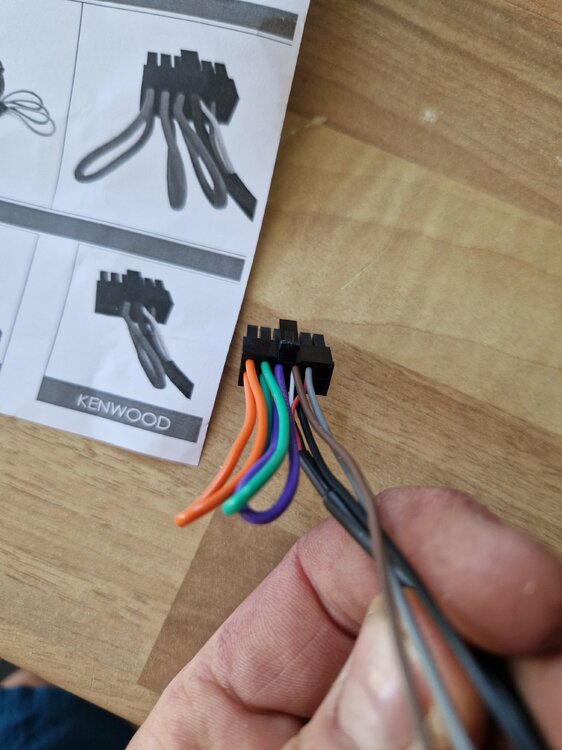

I have the patch lead for connects2 set to kenwood by cutting the green and orange wires as this is what YouTube video said do, like I say my controls on steering wheel work fine just no sound

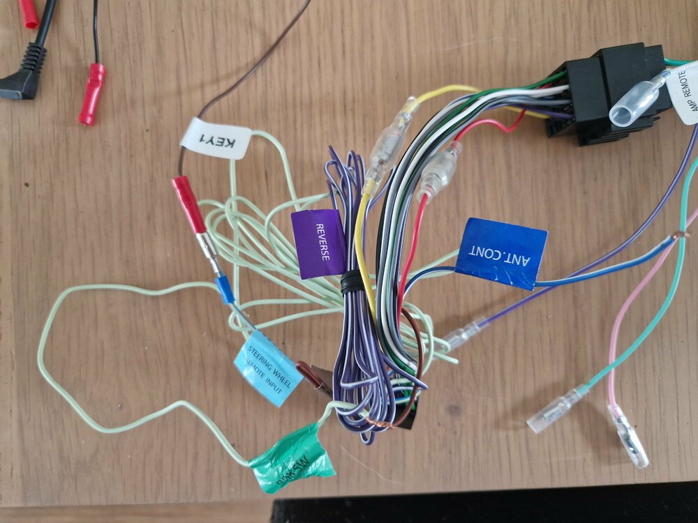

I notice 'amp remote' isn't plugged into anything? I have tried the blue 'ant cont' lead pushed inside the connector but nothing??
The main photo of the wires are how it's set in car, the loose wires aren't connected as connects2 just said link key1 so GND isn't linked but didn't advise?
