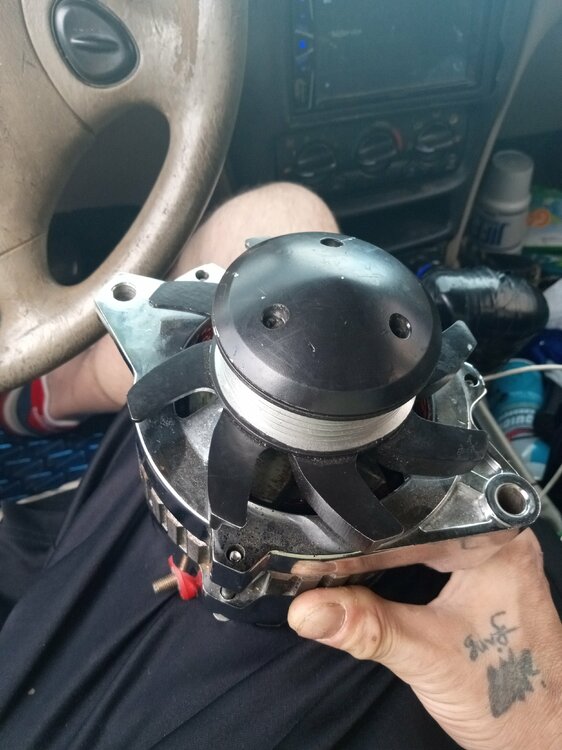

hackettj87 Posted July 7, 2023 Report Posted July 7, 2023 I have a 01 Malibu with a smart 3 bass and so far but not for long a Orion 10" hcca dspl and the guy I bought the sub from he had given me this high output alternator but it isn't for my Malibu. What do I need or what do I need to do to be able to do to mount it in my car?
SnowDrifter Posted July 11, 2023 Report Posted July 11, 2023 Probably more effort than it's worth, honestly. Arm chair refereeing: Not sure that alt would be worth using even if it fit. Large pulley on the front means low idle output (if it even is a HO alt and not a show piece). Front mounted fan is less effective at cooling the rectifier, so it would be more prone to heat issues. Especially with the large pulley spinning it relatively slow - less airflow. ~~~~~~~~SAY NO TO PHOTOBUCKET~~~~~~~~ Snow's DD-1 tracks here: https://www.stevemeadedesigns.com/board/topic/167433-snows-dd-1-tracks/ My take on OFC vs CCA: https://www.stevemeadedesigns.com/board/topic/110381-things-that-piss-you-off-in-the-car-audio-world/?do=findComment&comment=2461444
