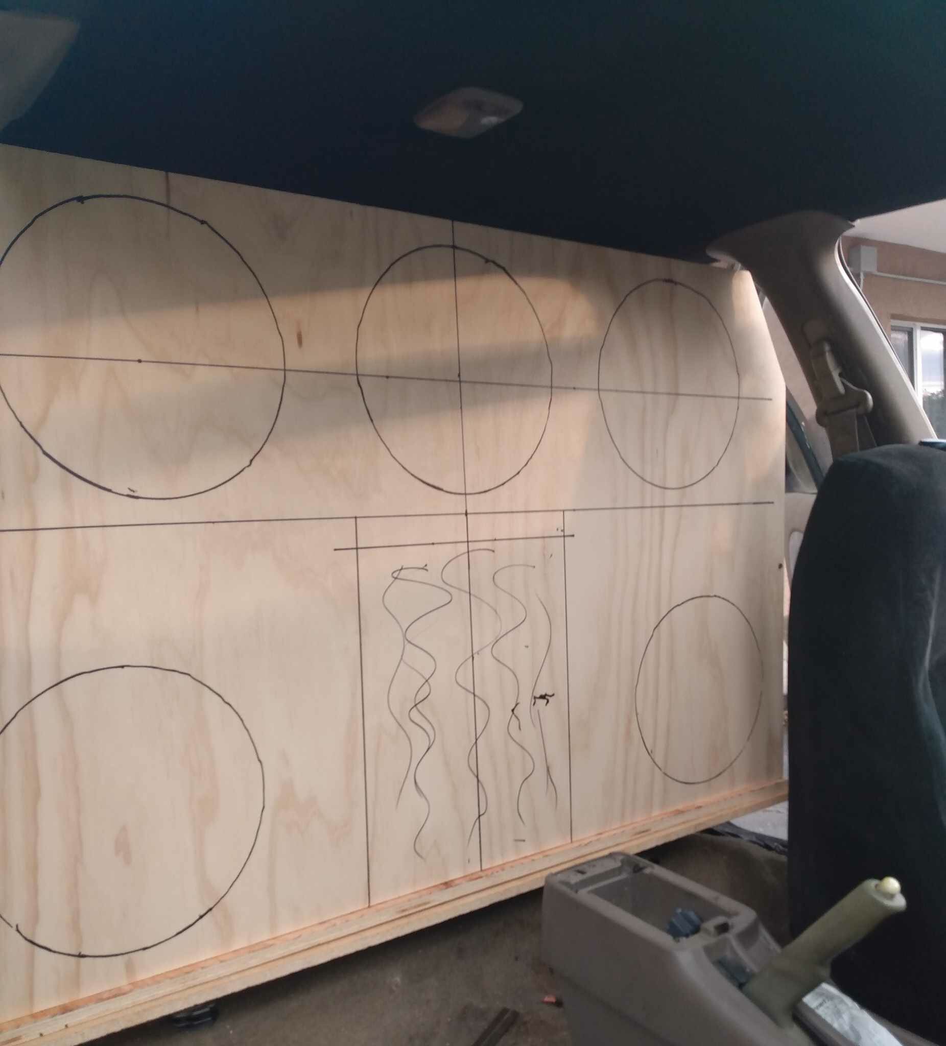

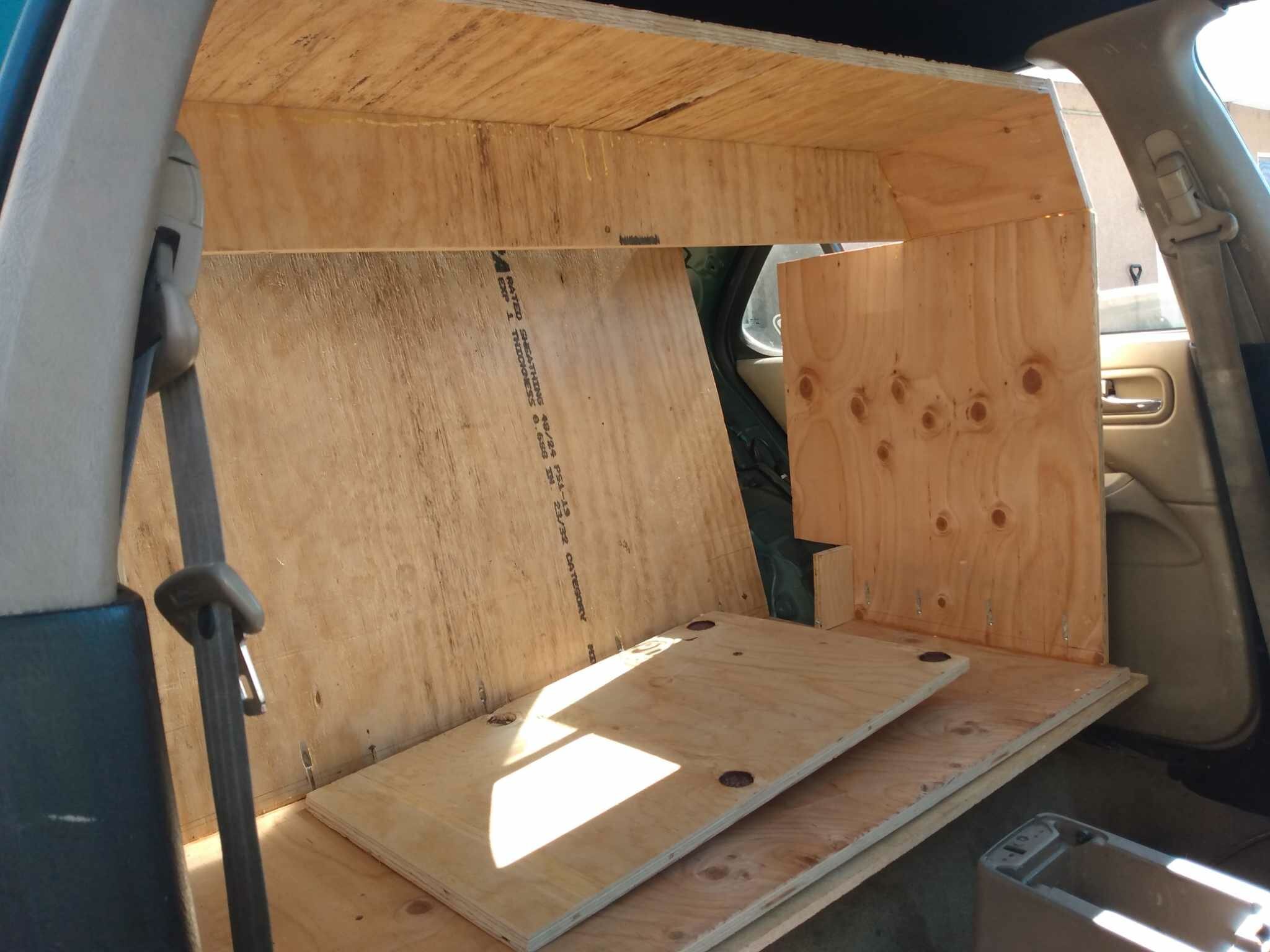

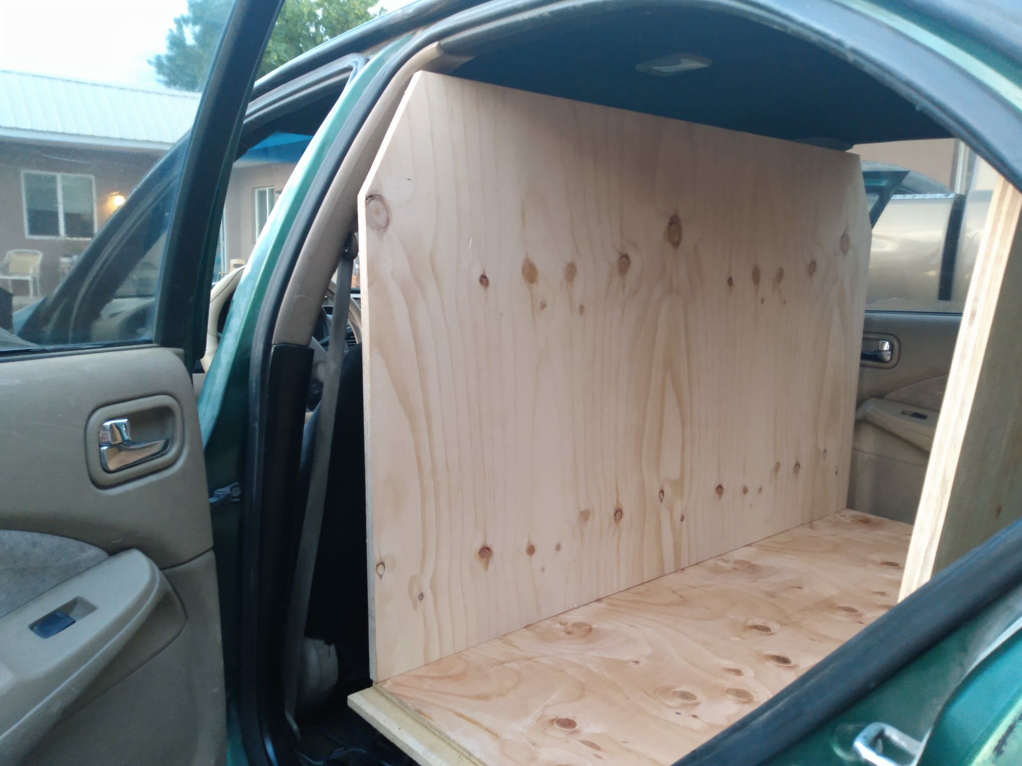

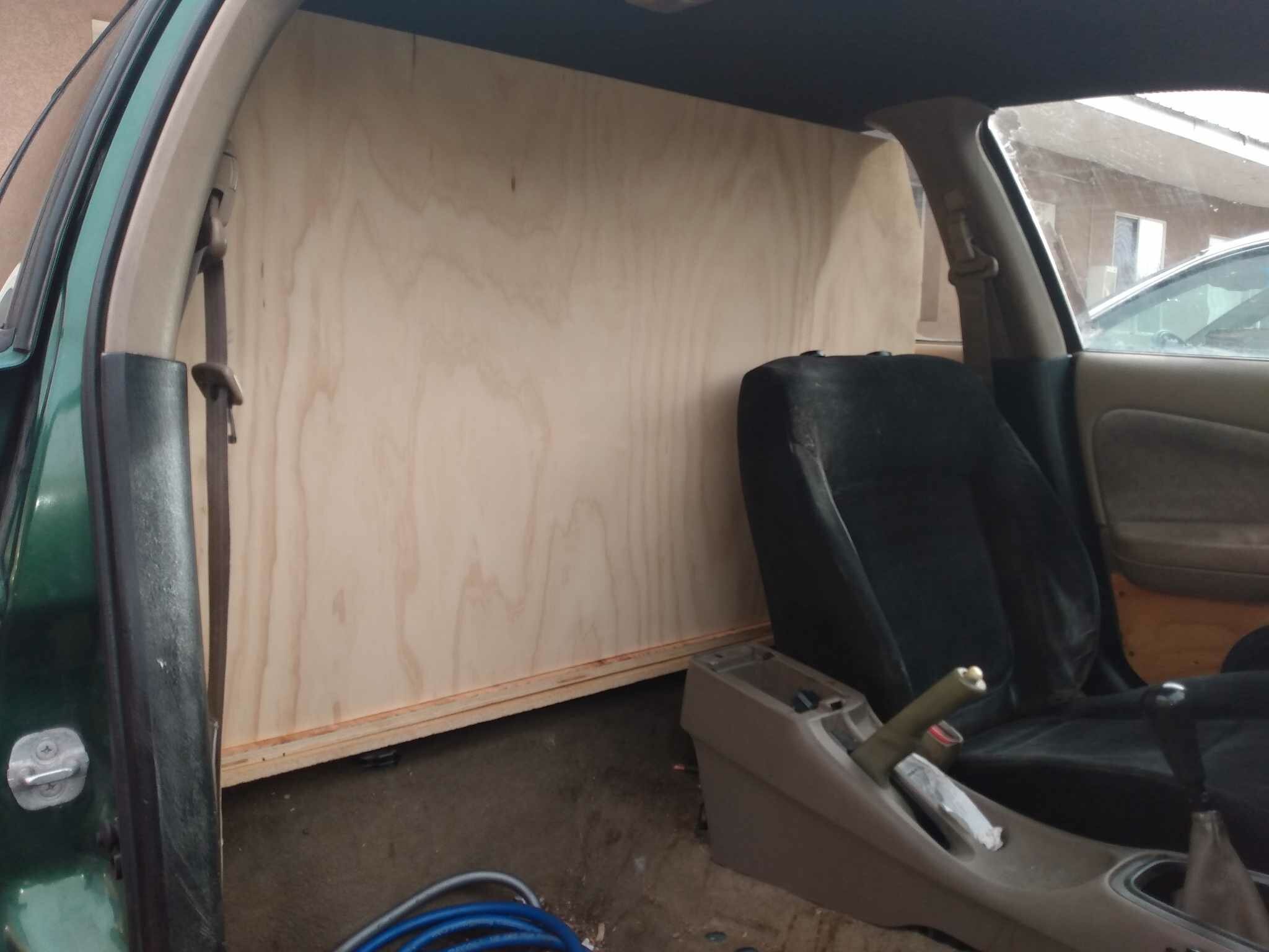

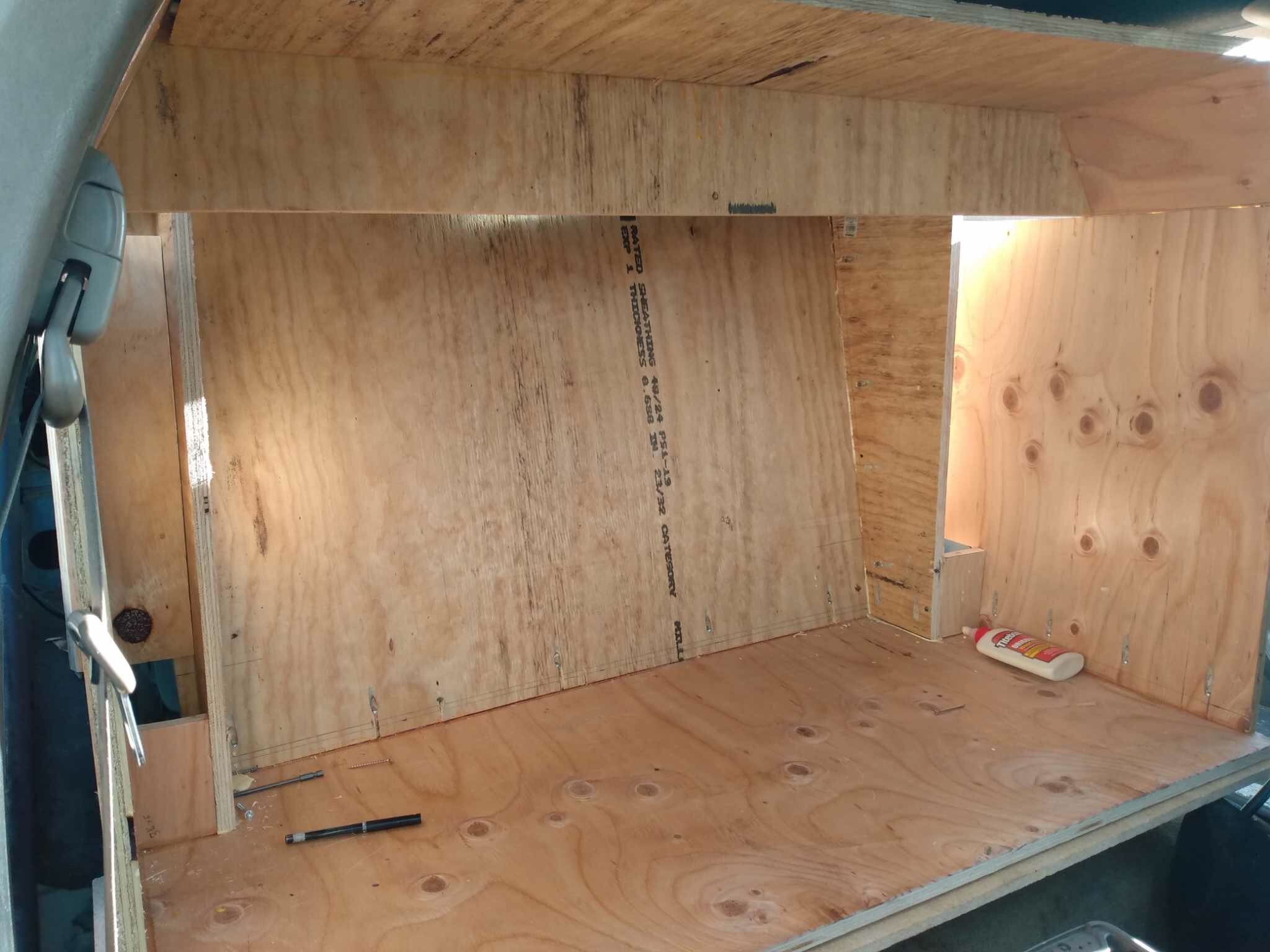

finally got started on it heres some pics form today tipping out the trunk build and starting to mock panels up
front baffle will be tripple thick with dbl layer everywere else
inner panels are a lil bit cheaper ply with the outer layers being 13 ply

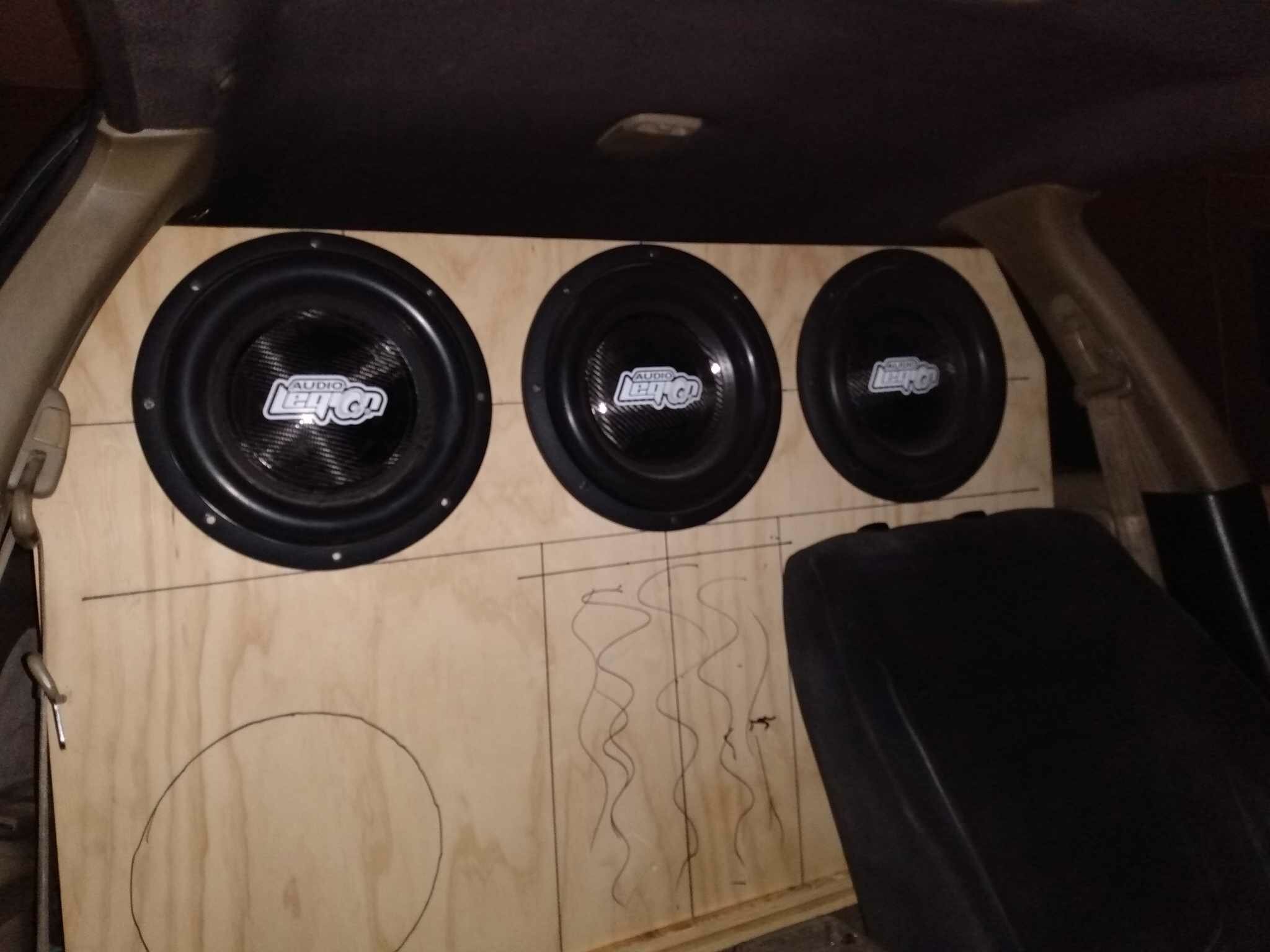

layout is going to be 3 subs across the top , and 2 on the bottoms on left and right of the baffle with a 225sqin swapable slot port tuned for 28hz for daily use and more then likley 45hz for burping

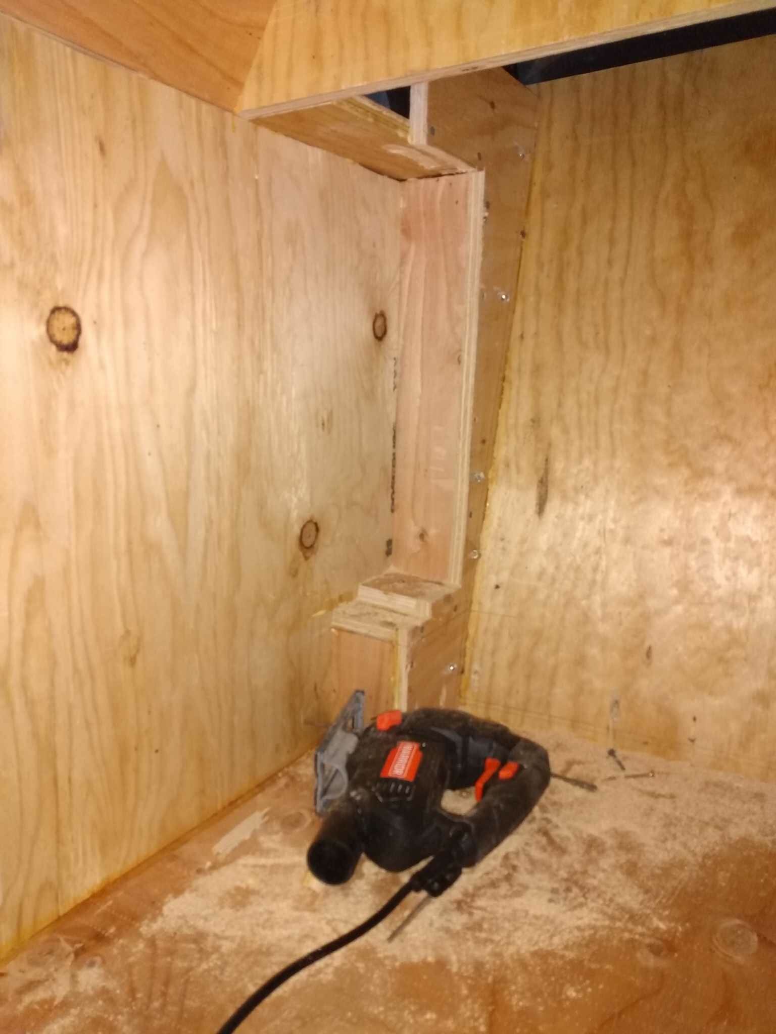

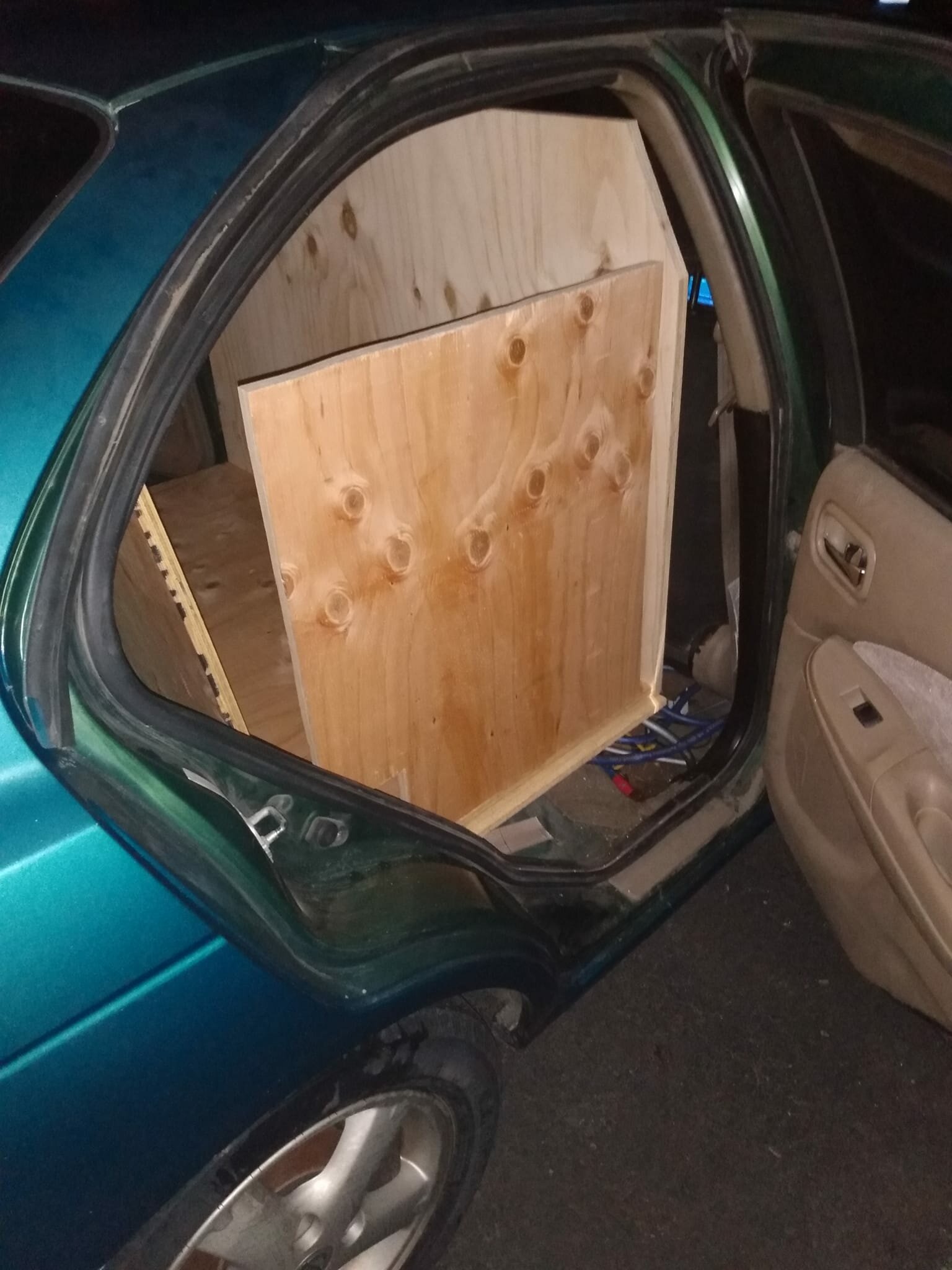

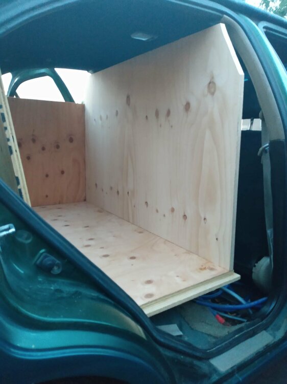

got the excess cut fromt he corners and had to call it a night ran out of daylight , i have 2 panels to install in the top of the box tommorow morning and then i can work on fiberglassing and sealing the inside before i put the outser layers on
closer , waiting ont he first 2 baffle layers to dry and then i can glue this one to those and install it for real

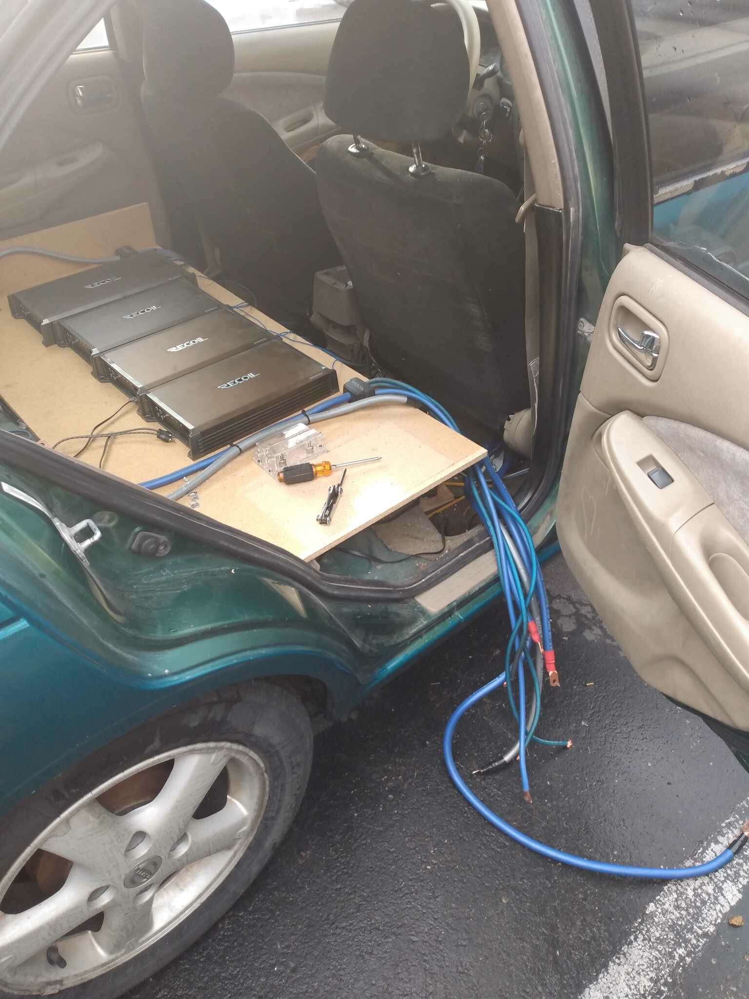

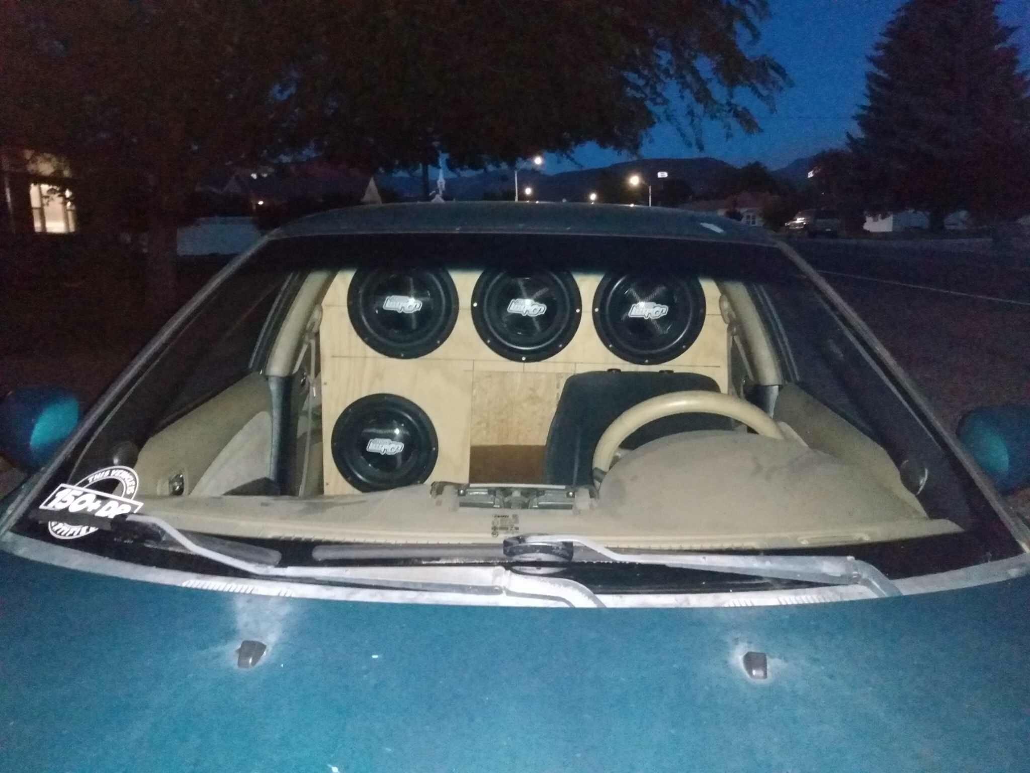

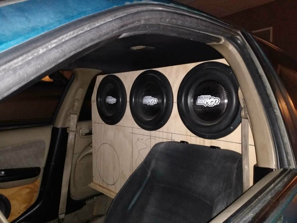

progress is slow but i got the port cut and in today for testing and 3 out of the 5 sub amps installed  its enough for some low power testing /checking making sure the enclosure doesnt have anything loose etc
hopefully ill have enough time this weekend to get all 5 wired up and playing
just did all my volume calcs now that installed all my corner 45's and bracing with all my displacements this puts my wall at 13.1cft net which puts me right at 2.62cft per driver close enough for me i was aiming for 2.6 -2.7cft
