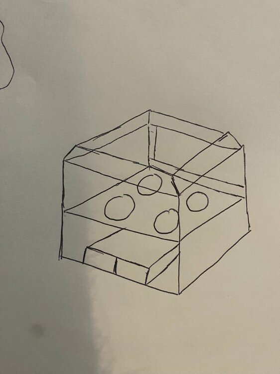

Ok right now I have 4 12 subs in a ported box . Sun firing up port to rear . The problem I have is my sub has huge windows on the back side and my 3 door rear hatch. When I am playing I feel like I am losing a lot out of those windows . What would happen if I turned the box around and put side top and back on the box so everything was having to go forward . Would it sound like crap . I thought about building a wall but I like to see out of my side and rear glass .

The box is net volume of 10 cubic feet with 120 square inches of port. The subs are firing up port back .

This is what I was thinking about doing at the c pillar. I have never built a 4th or a 6th and there is no good info on how to do it right . I have talk to some people but they want 160.00 for the design . So I thought maybe this would work or just do a ported wall and go with 6 twelves.
So it’s basically just turning the box around and ding sides and top and back to try and seal it off at the c pillar . Would this just be a waste of time .mom. It sure I have never done one like this before . But building a c pillar wall would be easy.IMG_3714.thumb.jpeg.13eccf240c7bbb90cbe3160324c55416.jpeg
