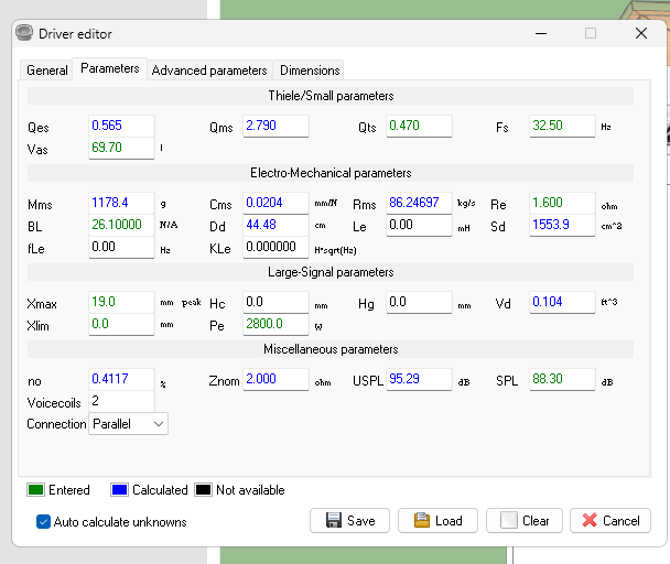

callum Posted October 31, 2024 Report Posted October 31, 2024 On 10/29/2024 at 7:31 PM, Joe X said: Using WinISD version 0.7, I entered the available parameters and no errors found. Do these values look right to you this is for the 3015r the cone area seems really big but this is using the values from deaf bonce

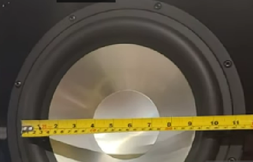

Joe X Posted October 31, 2024 Report Posted October 31, 2024 Press the clear button and then uncheck the "autocalculate unknowns" checkbox. Enter Fs, Qts, Vas, Pe and Xmax parameters that they give you. That should be enough for basic modeling, except you don't get cone excursion. If you want most of the other parameters, measure the cone diameter from the center of the surround on one side to the center of the surround on the other as shown in the following picture: About 10 inches is the diameter of the cone in the shown subwoofer. Post that number and I can give you most of the missing parameters.
