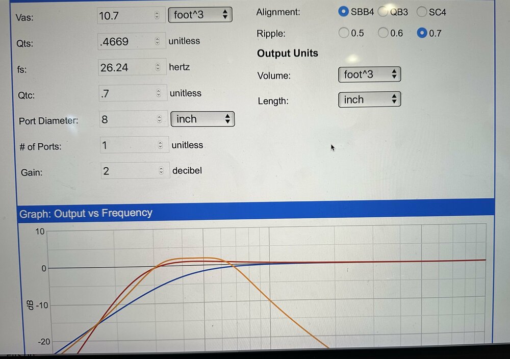

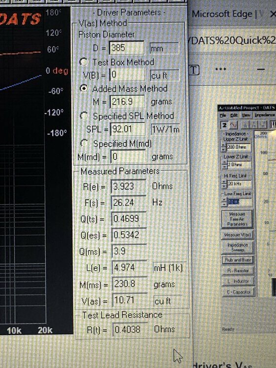

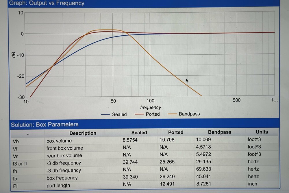

I measured the XLC parameters with a parts express DATS V2, and tried modeling a largish 4-th order bandpass for it (going in an oldschool OBS suburban, so have room). The weird thing is that it doesn’t model wider, deeper, or more efficient on the whole than a plain ported enclosure of similar volume.  And the 4th order I had for the Kickers waaay back in the day models a decent gain in efficiency while still going nice and low.

I’m attaching pics of the measurements, and the simulation I’m thinking of going with graphed with sealed and ported enclosures of about the same size for comparison.
Oh yeah, I like deep bass, electronica, old school bass like dj magic Mike, techmasyer peb, etc. Would also like to have good kick drum kick if possible, is why I’m thinking larger, lower efficiency, and wider pass band may be where I need to be.  Constructive input is welcomed. IMG_5959.thumb.jpeg.ac9cd14f20bdc13328058cb0ea0c2503.jpegIMG_5958.thumb.jpeg.851f4cf757e65d1bc07441e83f4fd6d9.jpegIMG_5831.thumb.jpeg.1f2a4e2308f95549aea86434e4e76835.jpeg

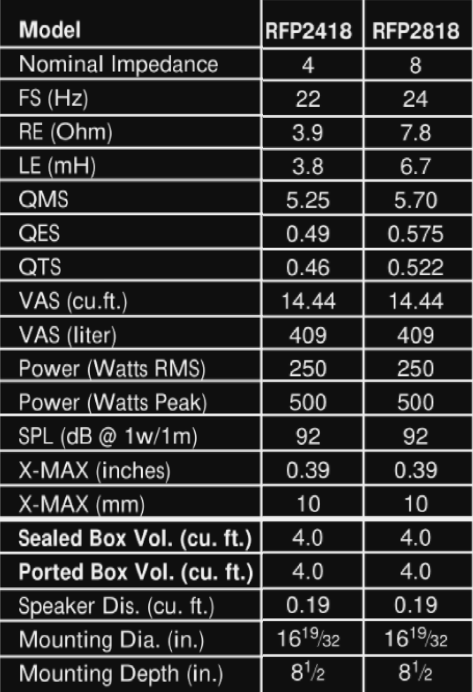

These are the official params for your sub:
From what you measured it looks like your sub is stiff either because of not getting broken in or due to possibly aging.
I came with 2 specs, a 4th order bandpass ( in blue ) and a ported ( in orange )
Specs for each are:
BP4:      4, 6@47Hz 50 in2
Ported:   6@30Hz 30 in2
Ported would be the enclosure of choice delivering a nice relatively flat performance with low group delay, good for sound quality.
The bandpass is just too big with just marginal gains in output.

Thanks Joe.  Why does the frequency response for the 4th stay so flat, so low?  Is cabin gain added in that curve?

Yes exactly, cabin gain is added to those curves, it is a generic form so do not expect exceptional accuracy, still, adding a generic cabin gain results in a better representation of what you will be getting than adding nothing. Anything below 20Hz in those plots you can ignore.
6th order would be much larger than ported and 4th bandpass even if that happened to work out it would not be worth to build, modern subs work in so much lower airspace and yet you don't see everyday someone building a 6th order with 18 subs.
