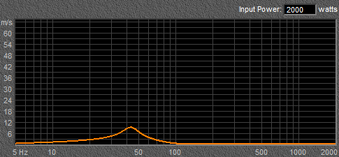

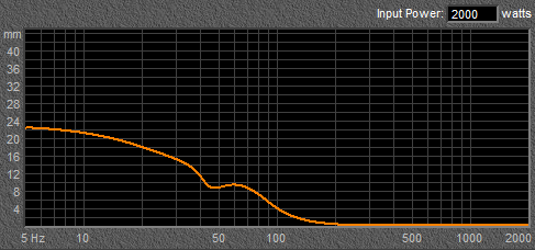

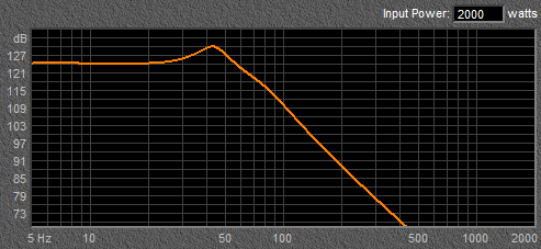

Joe X Posted February 14, 2024 Report Posted February 14, 2024 Went for a 2.5:1 to save some space, 2 cubic feet per driver for the rear chamber: projected frequency response: Cone displacement: Vent airspeed: TOTAL BOX SPECS: 4, 10@45Hz 240 SQIn of port area. Bear in mind that this type of enclosure needs strong midbass drivers on your front stage, it is not like ported. Also the port must be removable so that you are able to re tune if necessary. Finally the sundown design is set for maximum output so if you are into sound quality you may not be impressed.
