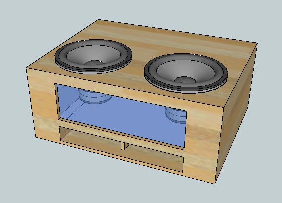

For RF you can go with a larger net volume than suggested and tuning should be within 30-35Hz, subs up / port back for your type of vehicle, something like in the figure below:
Thanks Joe, Ill try a box like that, really appreciate it, my actual is with aeroport and is about 32Hz I think, so I am not that bad  I just wanted to be sure that everything was OK and getting the best for those subwoofers
