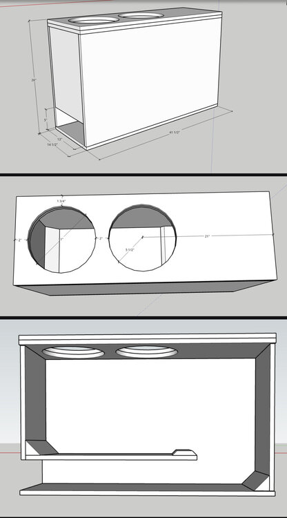

I assume that box is for an ext cab, if the port direction is damaging your output will be because:
1) The port is less than 5" from the door.
2) the door is flexing bad.
Said that 30Hz is rather low tuning which makes the the box play really low but loudness to the ear is less.
The other causes are improper electrical or your amp and system settings (gains and such) are not correctly set.
Subs themselves are also power limited if nothing helps you could upgrade subs too.
Your port is choked at 3" much worse if it's 2" so you are no good there, you should at least have 5" which is the port width as shown in your sketchup.
I generally tune 33-34Hz for a louder experience with enough low end, obviously if you hear slowed stuff you will still want those lower tunings.
At the same time if you are into those deep low ends, you pick something like the Sundown X, the SAs are more adequate for regular music. That is the X series takes more advantage of the low tuning, for those Sundown will recommend 32Hz.
