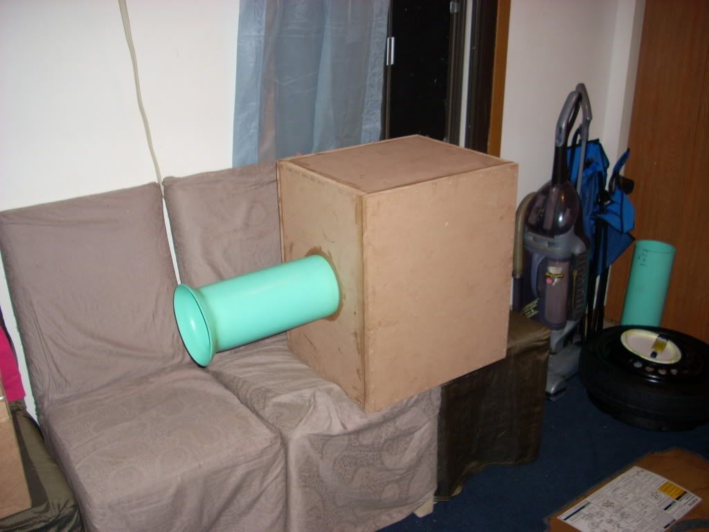

Motasolo Posted August 4, 2009 Author Report Posted August 4, 2009 I didn't get any negative feedback yet on the rear port straight out the back. So the plan tomorrow is to flare some 6" PVC i picked up for 15$ It's the Schedule 30 green sewer piping, and I am hoping it heats up and bends ok. If it fails I will have to find some of the regular white schedule 40 in a 6" somewhere. I will post some pic's after* 00' GP GT 12" Fi BTL Build log with pic's :]

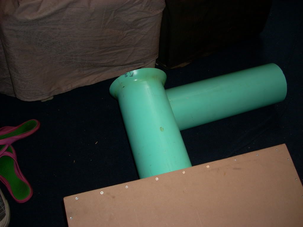

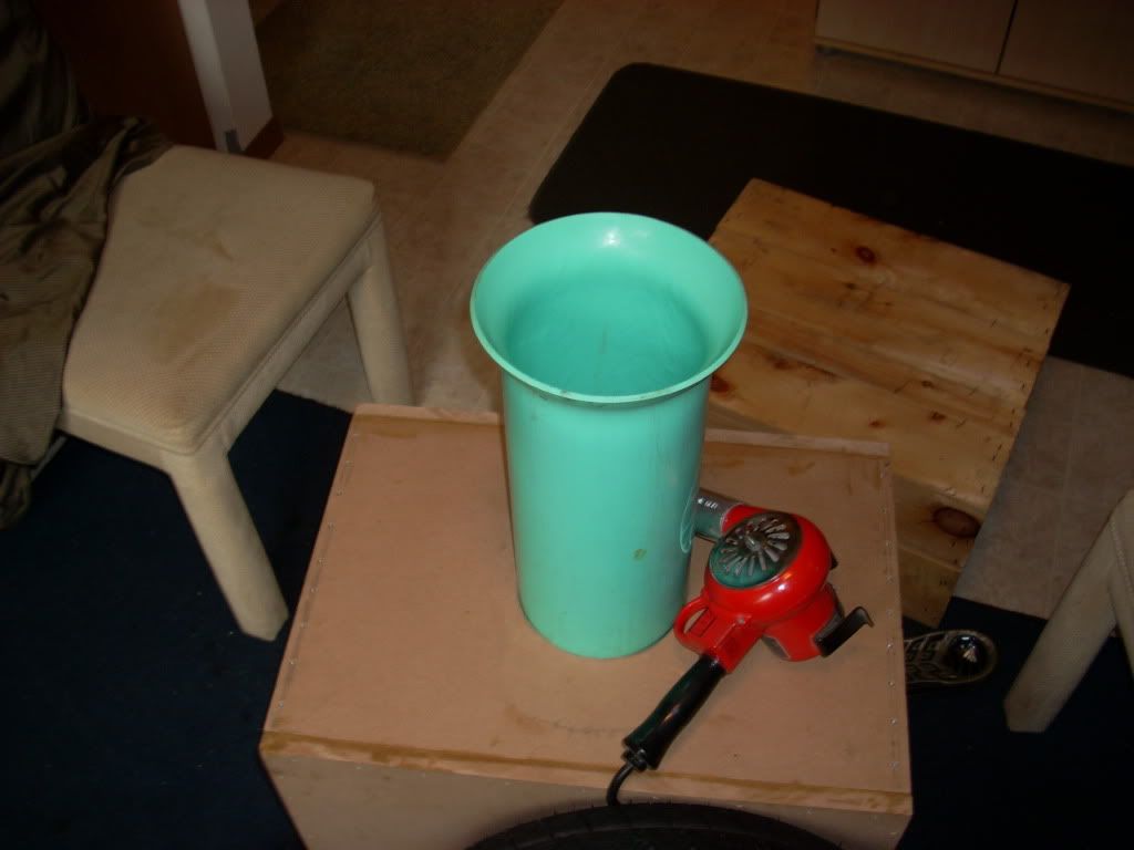

Motasolo Posted August 5, 2009 Author Report Posted August 5, 2009 the 3ft pipe before first stretch, this stuff is crazy tuff side angle second stretch on tire rim, needs some re-shaping yet, and also cut to length. inside flare can be a lil smaller from what I read. Going try a one piece port lol. I will post more pics tomorrow. Peace~ 00' GP GT 12" Fi BTL Build log with pic's :]
sounddesires Posted August 5, 2009 Report Posted August 5, 2009 that lil port flare job is badasss...cant wait to see more

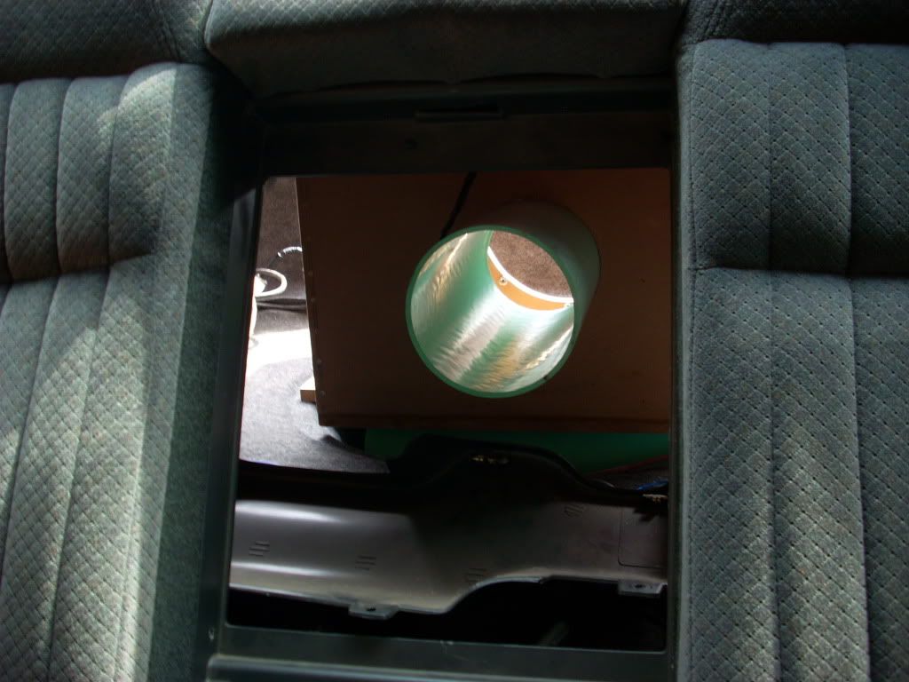

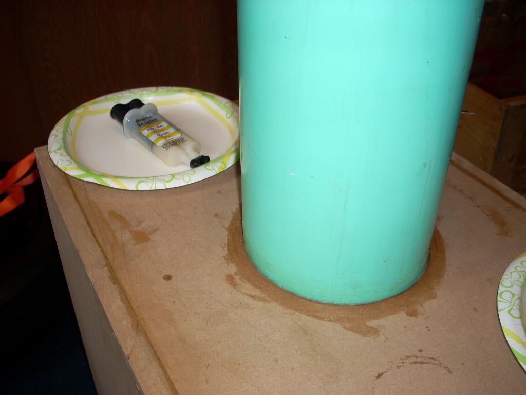

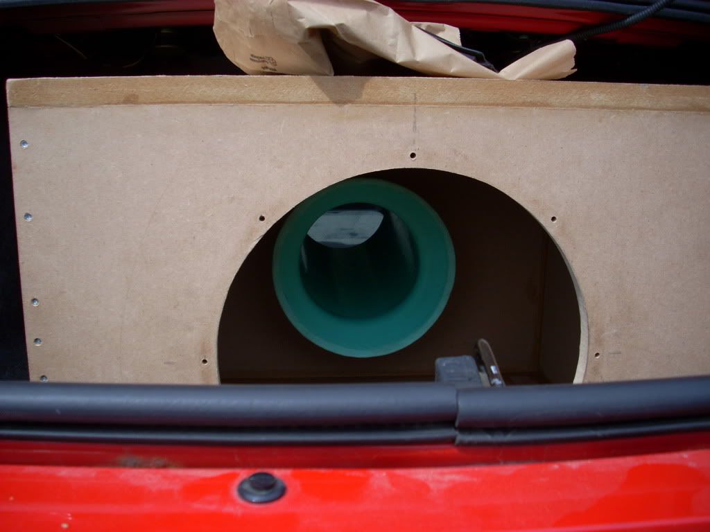

Motasolo Posted August 8, 2009 Author Report Posted August 8, 2009 Finishing the port, sort of... cut to length test fit went ok Schedule 30 is thick and hard to flex, I might try again down the road on some PVC40 Wiring the sub in the box after bonder cures more pic's coming, looking for amp to break in sub till I can afford a sexy DAT amp! 00' GP GT 12" Fi BTL Build log with pic's :]

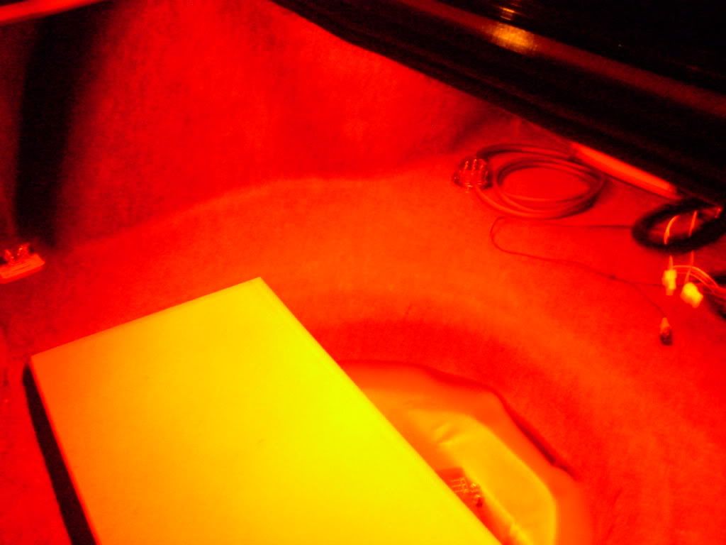

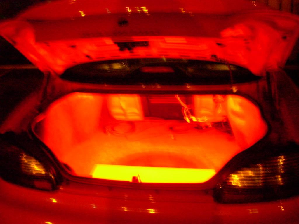

Motasolo Posted August 8, 2009 Author Report Posted August 8, 2009 Trunk light burnt out and I had a 12v LED strip. Zip-ties to place then hot-glued! flash was on first pic so fun I jumped jk forgot to hang the wires up Pretty bright at night, there was a small resistor in the old trunk light wiring... Wonder what that did... Peace 00' GP GT 12" Fi BTL Build log with pic's :]

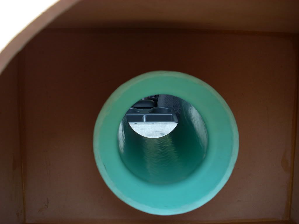

Motasolo Posted August 9, 2009 Author Report Posted August 9, 2009 More pics, made a bottom board to cover the spare tire hole and mounted brakets almost done! are we spose to blur the plates? I dunno heh Nikon CoolPix, always gives me a blurred pic any ideas? I tried faster shutter speed... Port right where I wanted! I need to paint and silicone it yet after I find some $$ Peace 00' GP GT 12" Fi BTL Build log with pic's :]

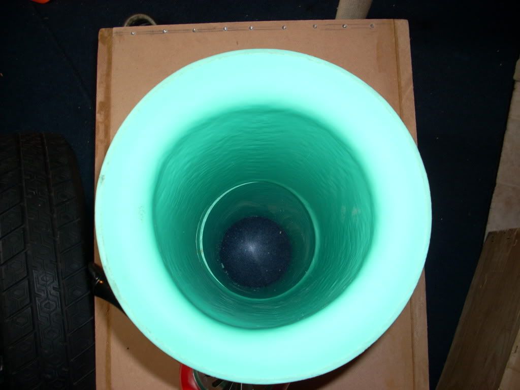

Motasolo Posted August 12, 2009 Author Report Posted August 12, 2009 Port Paint and misc.. was the first coat, looks better now cont... 00' GP GT 12" Fi BTL Build log with pic's :]
