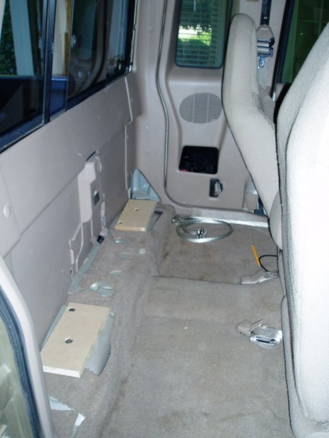

here's what i did, don't know what year ranger you have, but if you have the jump seats like mine, this might help. i used 3/4 mdf and countersunk it into where the old seats were. then put the box ontop the mdf blocks and screw it on through the inside of the box. i also removed all the trim on the back wall and it gave me another inch or so...
edit: forgot the pic...
