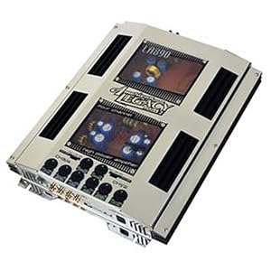

CrankedPhelo Posted May 23, 2010 Author Report Posted May 23, 2010 can probly bridge ch 3&4 for sub and use ch 1&2 for front highs or rear highs. If you bridge the amp make sure you cange any switches accordingly (if any)! I think we'll go with this^^.Here Is the amp its a 4ch with 1200watts. i dont understand whatcha mean by switches. like if i bridge the sub on 3rd and 4th chann and use the 1&2 for 6x9s will there be to much power to the 6x9 to get em blown? I caught a 18" Bass once, it was about 5lbs. Fried that biatch up, good eatin!! i need to vent... the room after i fart.
7jezuz7 Posted May 23, 2010 Report Posted May 23, 2010 I think we'll go with this^^.Here Is the amp its a 4ch with 1200watts. i dont understand whatcha mean by switches. like if i bridge the sub on 3rd and 4th chann and use the 1&2 for 6x9s will there be to much power to the 6x9 to get em blown? All those setting knobs have need to be adjusted properly, so that channels 1&2 can play the proper frequencies for speakers and 3&4 for a subwoofer and no the 6x9 will be separate from the sub channels so there is no reason to blow them unless you turn everything up too much or wire something wrong An Audio Technix 18" Strato on a Kicker KX120.2 My Youtube Bass Vids Updates When Possible... I've bought from JBurt09, OrionStang, bcpballer64, LoudNLow931, audioman21, and CJ18 from here (as refs)
