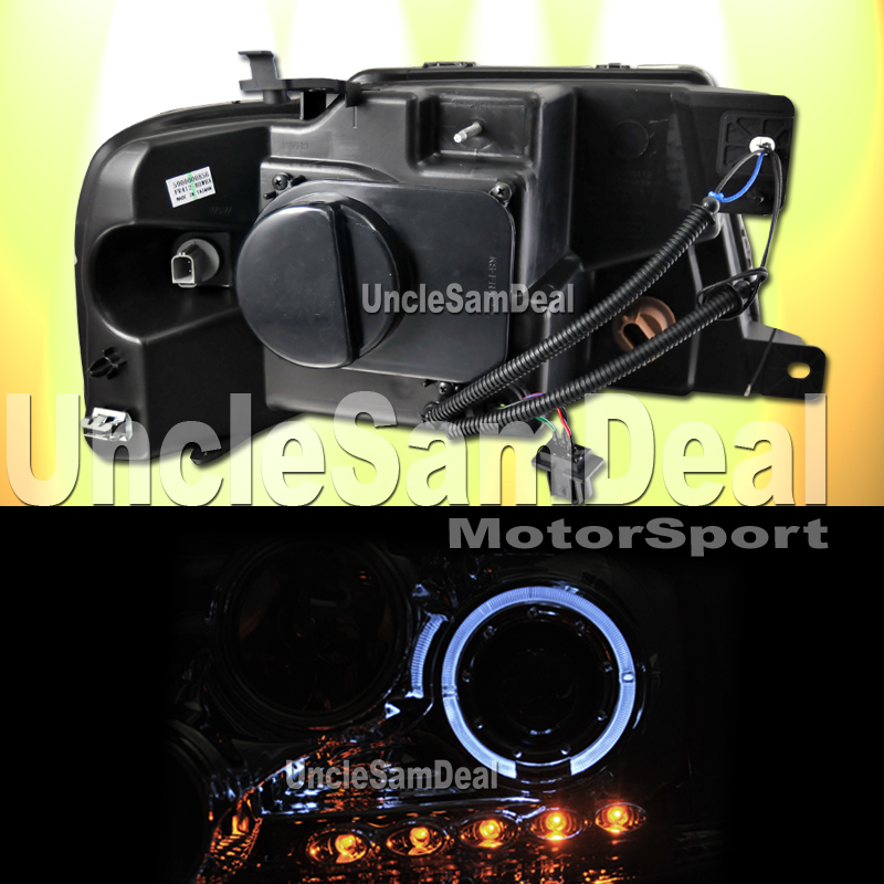

Im wetsanding my tail lights now to lighten them up but im browsing ebay for some new Halo Projector head lights, and anyone with this truck knows that the headlights are an H13 dual beam. The ones im looking at are these
http://cgi.ebay.com/ebaymotors/FORD-F150-HALO-RIM-PROJECTOR-HEADLIGHT-CLEAR-CHROME-LED-/330505881519?pt=Motors_Car_Truck_Parts_Accessories&fits=Make:Ford|Model:F-150|Year:2006&hash=item4cf3af87af#ht_3366wt_939
if you notice in the informtaiton, it says
"UP FOR AUCTION A SET ( ONE LEFT AND ONE RIGHT TOTAL TWO PIECES)
2004-2007 FORD F150
CLEAR CHROME HALO PROJECTOR HEADLIGHTS WITH LED LIGHTS
PROJECTOR LOW BEAM HALO LIGHT RIM WITH WHITE LED LIGHTS
H1 HI BEAM AND H7 LOW BEAM LIGHT BULBS INCULDED
NO MODIFICATION - DIRECT FIT/ INSTALLATION
COME WITH PRE-WIRED PLUG
has anyone had any experience with these?

junk, they usually have cutoff shields bent to much right out the box. go back to stock headlights and do this
http://www.f150online.com/forums/articles-how-tos/356836-how-paint-headlights.html

actually i have no idea what your asking.
It says its prewired for the 2 bulbs. on my dual filament car it has 2 switched negatives (one for high,one for low) and a constant +12v. the headlight switch just switched either ground for high or low beam.
in that pic you can see a female socket that has 3 wires coming out of it.its right by the 2 long wires for the LED's thats where your factory wiring would plug in, then the headlight has its own internal wiring.
