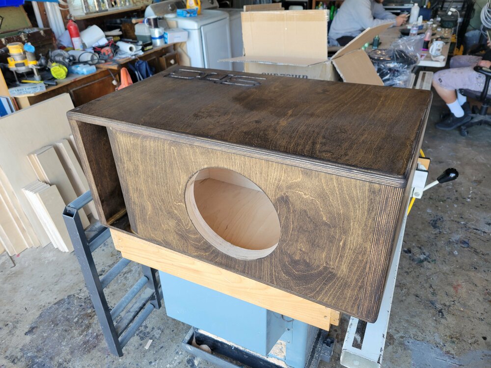

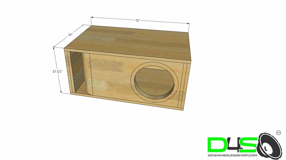

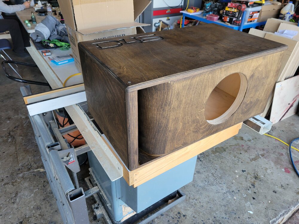

  8. my box was software modeled by down4sound. Its a 1.7 cf ported box tuned to 30 hz. im using a 10" American Bass sub with a Fs of 34hz. this box for this sub is down tuned by 4hz. Is that considered more bad or more good or not a concern at all? Im just trying to get on the right page generally speaking using the above model. how well does a 30hz tuned box pair with a 34hz peak performance sub.
