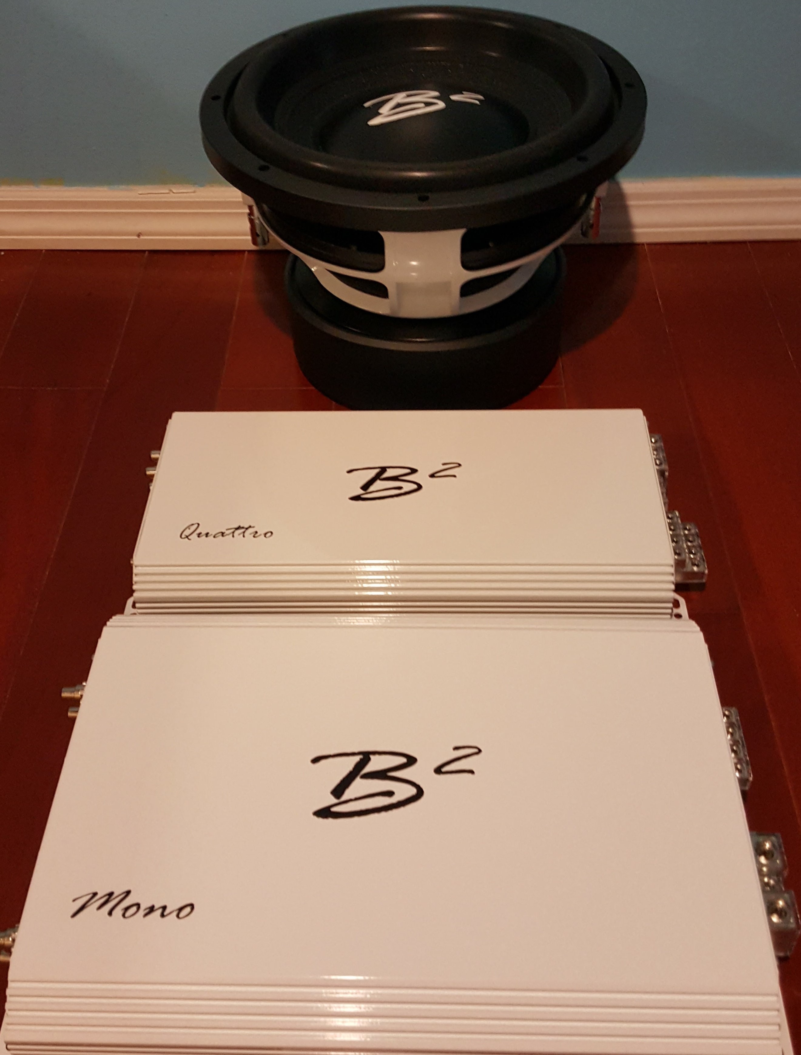

  9. Hey everyone, I have a 2014 Honda Accord with the "premium" system. I currently run a B2 Quattro for front mids and highs, B2 Mono for bass, and also a B2 MA1000.2 on pro audio drivers. I'm still using the factory touchscreen radio for my source and have a bypass/harness that grabs the signal before factory amp and converts high level into low level input that feed the amps directly. I am looking for a DSP that accepts RCA inputs but will also de-equalize and not fade out bass at higher volume. I really like how the new Zapco DSP Z8-IV-II looks and the program/app looks great to me. I was hoping someone could give me some feedback on this model and if it was capable of de-equalizing. I am also open to any other suggestions. Thank you in advance for your help.
  10. Hey everyone, its been a while since I have posted anything. I've been out the car audio game for a while. I currently have a single B2 HN12v3 dual 2 ohm powered by a B2 Mono in a 2.8ft^3 box tuned to around 33hz. I would like to build a box that would port out the armrest (ski hole). I need some help as I have never built anything that was not either a slot or aero port box. I was able to meter it and it pulled a 139.9 sealed @ 40hz. Spl is not my goal. I am leaning more towards sql. If someone was willing to help me design something or even point out how to calculate a external port I would greatly appreciate it. The max dimensions I have to work with is 15h x 30w x 18d ( if I could shrink depth by any I would be happy)
