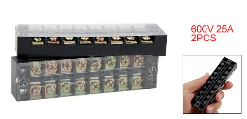

Also ordered some barrier strips to help clean up wiring:
