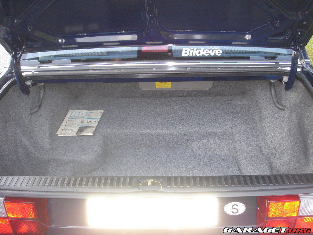

I have got me a new car recently and the trunk isent the biggest either, so i kinda need big help :)
I got a Volvo 740. I would like to have the bass facing the cabin, i got myself a skihole of what to call it in the middle, but anyway its like a hole there so the bass should play litle louder in the cabin by having it facing that way :)
The space i got there isent the biggest.... this is what i have space for:
Height= 28 cm
Width= 88 cm
Depth= 36 cm (can go 1-2cm more if REALLY needed)
And this is the tricky part.... i got a 12" bass (about 31,7 cm) so i guess it should work if the box got a 45* degrees angle where the bass is facing the cabin.
