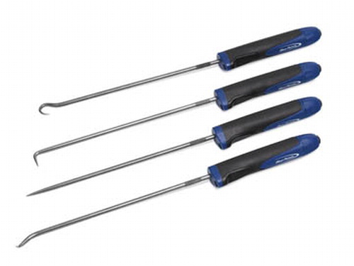

frogcase2002 Posted November 29, 2016 Author Report Posted November 29, 2016 Yea thats what im saying about "break In period" . Iv played many subs full tilt the day after reconing. . Ill try to use some kind of pick to get it out . . Just hope this shit dont happen again after I recone it . . Never seen a sub mess up so quick without even getting warm or anything. . Kinda makes me think something was already wrong with it Clarion cz702 Ssa evil mids and tweeters ppi 900.4 2 zcon 18s Taramps 10k 3 big dekas 1 xs 3 runs of 4/0 and big 3 300+ amp ohio generator 155.7 on dash at 36 (peak) 152 at 25
