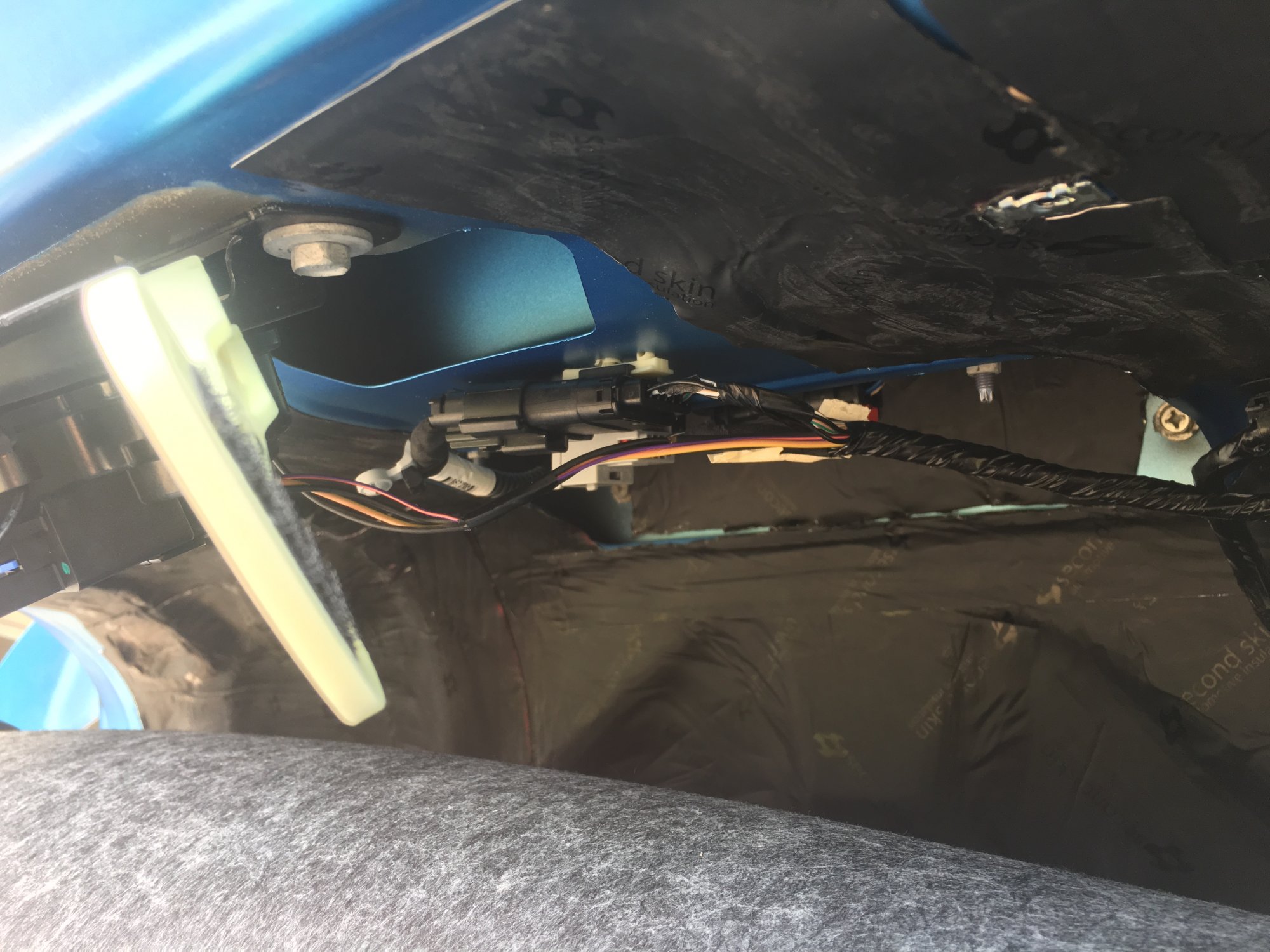

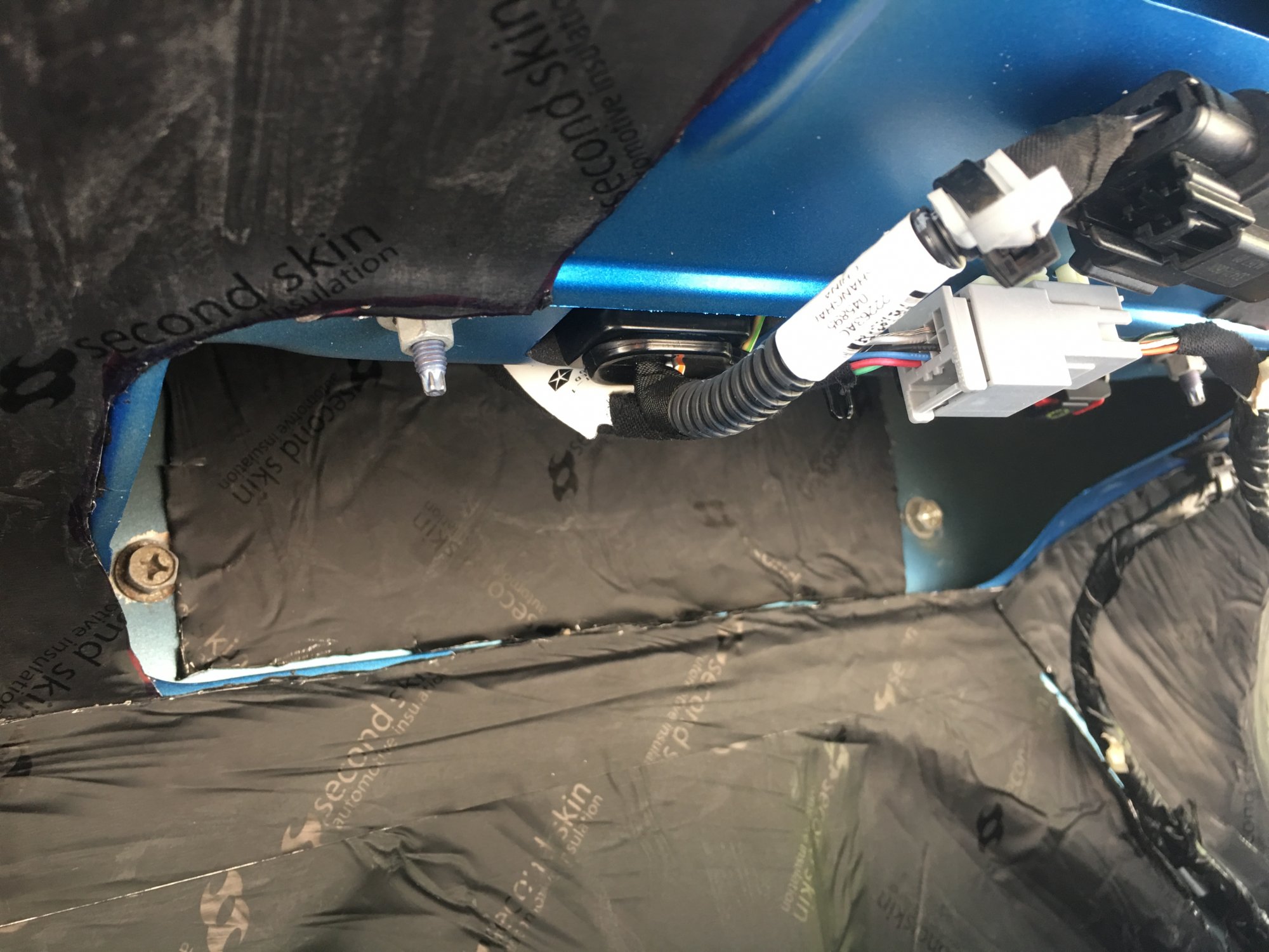

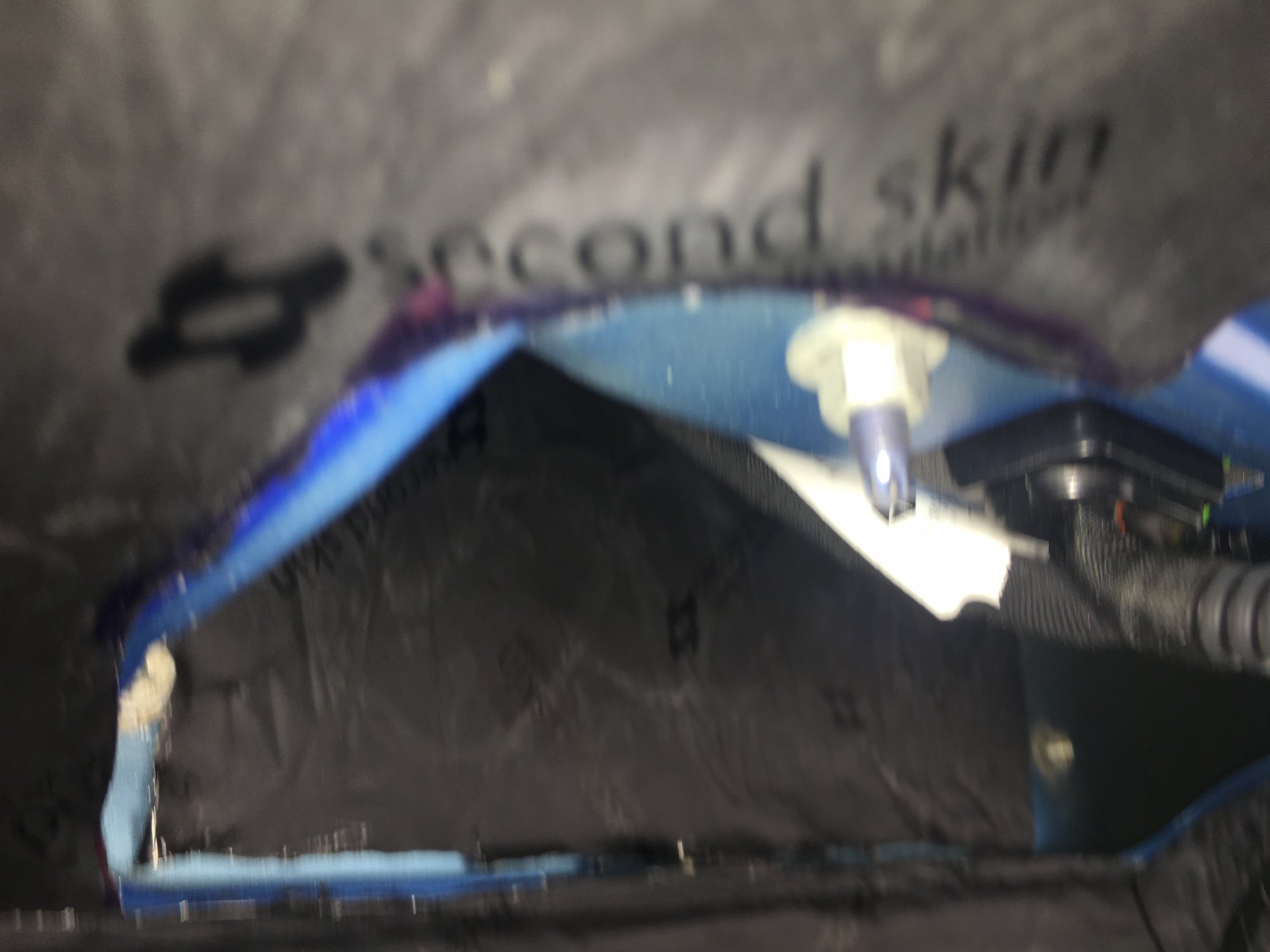

Thanks for the advice here's some pics of what I'm talking about.
Yeah, with those gaps, that is going to be the outer layer that is most likely rattling. If you can get CCF in there it would be good, but you may want to use the ideas the other poster listed, just be careful with expanding foam as it will push metal outwards if too much is used.

Any other tips for when installing the CCF?
Cut it in long strips but the width of the size of the holes and push it in as far as you can. Be careful not to bump taillight wires and cause a disconnection (and a ticket). If you keep them long, you can always pull them back out if you want to try something else. It's just going to be trial and error until you get product in between the two metals that are causing the rattle. I wouldn't even glue it in, once you get it full enough to solve the problem, just tape the hole entrance up with foil tape, so you can re-access the foam in the future since it wasn't glued in.
