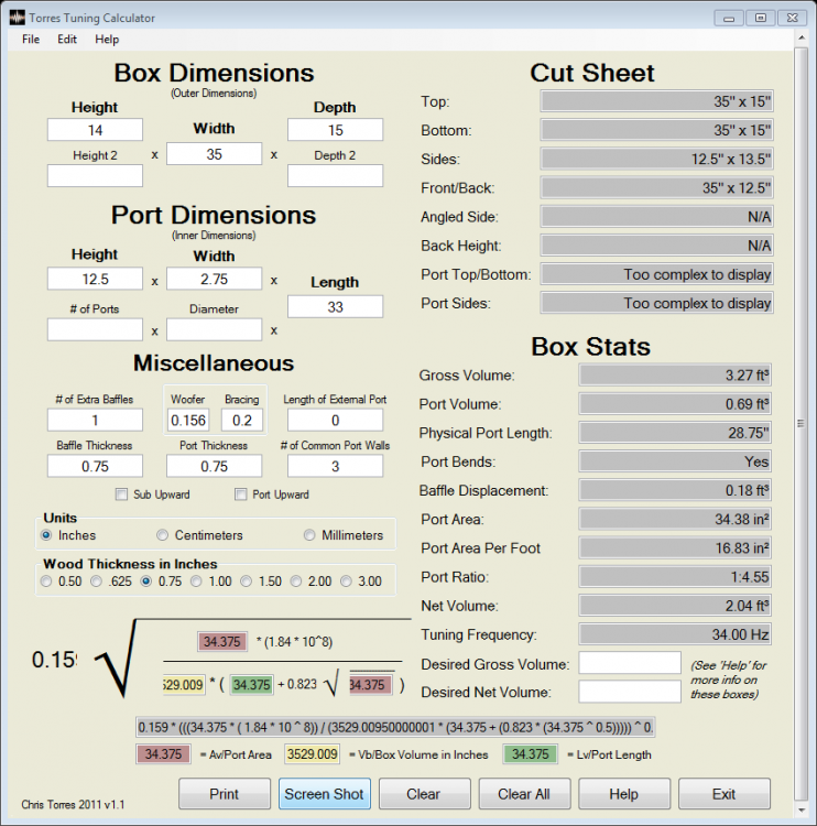

Ryan Lynch Posted March 27, 2017 Report Posted March 27, 2017 Looking for help on designing a ported box for 2x 10w6v3s. They'll be wired @ 1 ohm and ran off a Fosgate Prime r1200-d1. I know people often run these sealed but I'm thinking since they'll be getting just about the recommended power, going ported will help them be more efficient on said power. Plus, my civic's trunk is a decent size so I'm not very limited on space. Originally I was thinking of paying someone to design/build a box for me, considering all I have is a jigsaw and a circular saw but the only person I could find locally is dragging their ass.. My dimensions are 37" x 22" x 14" By the woofers I picked this is probably obvious but I'm leaning toward SQL, sounding good with decent output. With the searching I've done quite a few people have said not follow JL's ported specs. Just seeing what you guys think. Here's some winisd plots on what I'm thinking of going for (white is the JLs, red is my current single type r 10" in a preaky prefab ported box) And of course here's JLs specs plugged in: Any input would be appreciated. Thanks. Car Audio Inc | Design, Fabrication & Installation

Ryan Lynch Posted March 27, 2017 Author Report Posted March 27, 2017 How does this look? Car Audio Inc | Design, Fabrication & Installation
Joe X Posted March 28, 2017 Report Posted March 28, 2017 Looks good, the only thing is your bracing displacement at 0.2 it's 10% of your net volume, for a small box like that it shouldn't be above 0.05 cubic feet.
Ryan Lynch Posted April 8, 2017 Author Report Posted April 8, 2017 Still have to round over the edges and carpet it but I just wanted to say thank you. I went with the 2 cubes net and 34hz and I'm trilled with the performance. Car Audio Inc | Design, Fabrication & Installation
