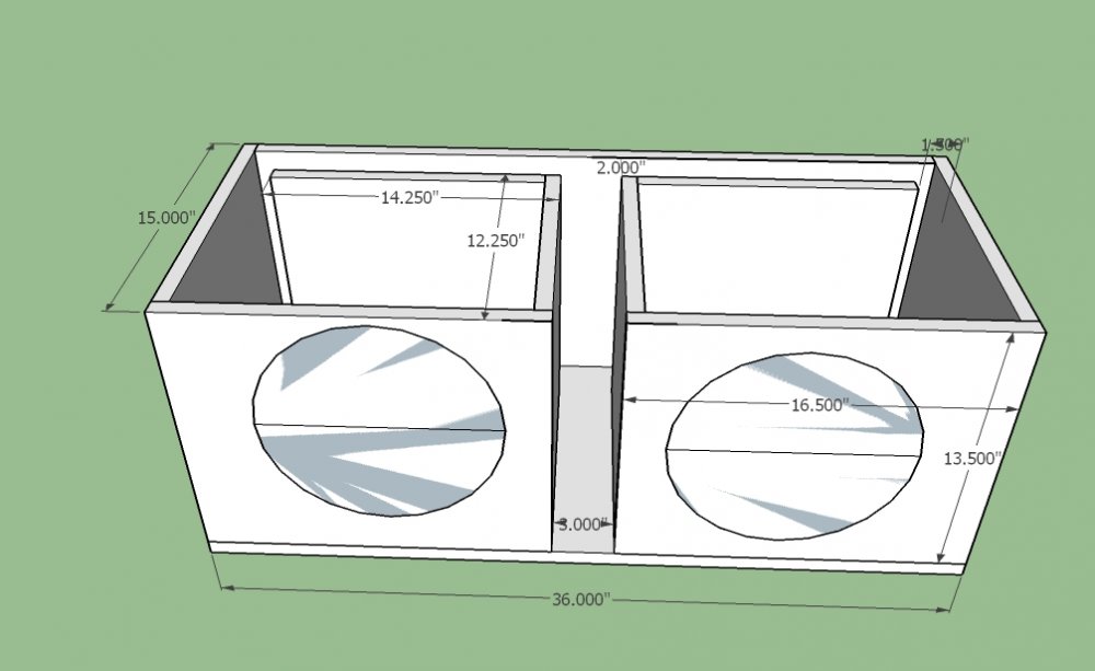

fus88 Posted May 18, 2017 Report Posted May 18, 2017 hi this is my first time designing a sub box, and from what i could understand after researching a bit i got up with this. this is just a general design for 2 12" not for a certain sub. these dimensions are limited by the trunk of the car. is it ok or did i miss something? really appreciate any feedback. forgot to mention, i'm really confused about port area and tuning stuff. will this design produce tight/boomy bass thanks
06RTCharger Posted May 18, 2017 Report Posted May 18, 2017 The proportions of the box IS determined by the specific sub tho, and the amp you'll be powering it with. You should know what sub and amp ur using before u design a box.
fus88 Posted May 18, 2017 Author Report Posted May 18, 2017 1 hour ago, 06RTCharger said: The proportions of the box IS determined by the specific sub tho, and the amp you'll be powering it with. You should know what sub and amp ur using before u design a box. well, i was planning on putting pioneers ts-3003d2 but not sure if i could find it where i live. now i'm running 2 kenwood kfc-mw3000, could not find the manuals for them so did that thing above? The amp i'm using is kenwood kac-9106d.
ckeeler11 Posted May 18, 2017 Report Posted May 18, 2017 The only way to know how this will perform would be to figure out what subs you have and enter the info into WinISD or similar program and see how it plots. Most 12's like 2-2.5 cu. ft. per so your box is way small for 2 of them. Also the port depending no the sub should be okay but is dependent on subs and power.
