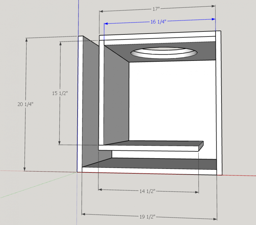

Triticum Agricolam Posted June 20, 2017 Report Posted June 20, 2017 OK, here is a suggestion. 2.25 cu ft net 32 Hz tuning 40 sq in port area External dimensions 18.5" D x 21" W x 20.25" H. All panels except the left and right sides are 17" wide. "Nothing prevents people from knowing the truth more than the belief they already know it.""Making bass is easy, making music is the hard part."Builds:
Rusty B Posted June 20, 2017 Author Report Posted June 20, 2017 hey Triticum I really appreciate the info. One last question. What would be the best material? MDF or Plywood? Thanks Rusty
Triticum Agricolam Posted June 20, 2017 Report Posted June 20, 2017 13 minutes ago, Rusty B said: hey Triticum I really appreciate the info. One last question. What would be the best material? MDF or Plywood? Thanks Rusty Which ever you prefer. Both can be used to build a good box. Good plywood is better than MDF, but MDF is better than crappy plywood. "Nothing prevents people from knowing the truth more than the belief they already know it.""Making bass is easy, making music is the hard part."Builds:
