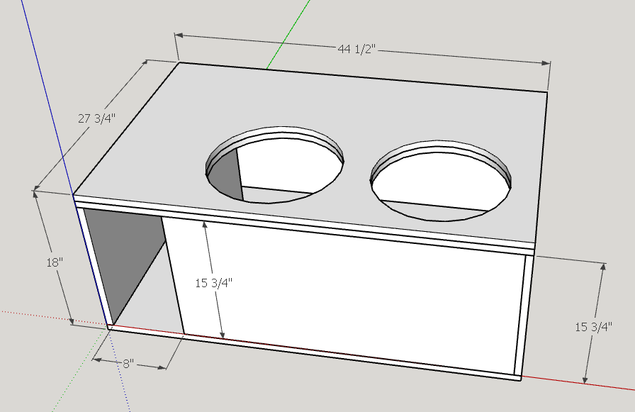

Looking to build a box for my 2 skar audio ddx 15's running a skar audio 1500.1 at 1 ohm. Putting enclosure in the back of 04 ford exporer. Wanting a low tune and subs facing upwards port back. Any design help would be much appreciated. Never built a box before so any help would be great!!!! Available space is W=44.5 H=22 D=22
Here is an idea.

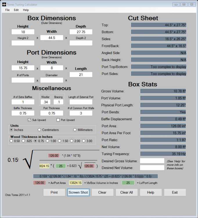

This how this could be laid out:
There are lots of ways to make something that will fit your space, this is just one.  Joe X usually does a better job at coming up with stuff than I do, maybe he will make you something too.
I put one brace between the sub, additional bracing throughout the box would be a good idea.
