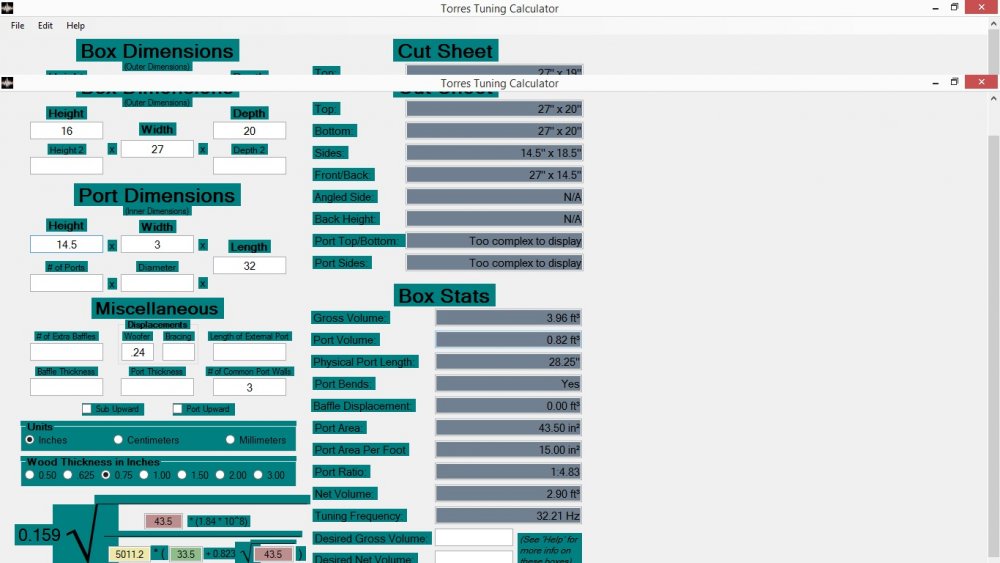

noxas Posted June 17, 2017 Author Report Posted June 17, 2017 This is what i was able to come up with. Could anyone give any feed back? I was trying to keep frequency as well as port area as close to recommendation as possible; or would something else be more advised?
Triticum Agricolam Posted June 18, 2017 Report Posted June 18, 2017 That looks pretty good. How much power are you going to be running? ETA - One problem I just noticed. You can't fit two 12" subs and a 3" wide port along the front of a 27" wide box. One solution would be to port out the side. "Nothing prevents people from knowing the truth more than the belief they already know it.""Making bass is easy, making music is the hard part."Builds:

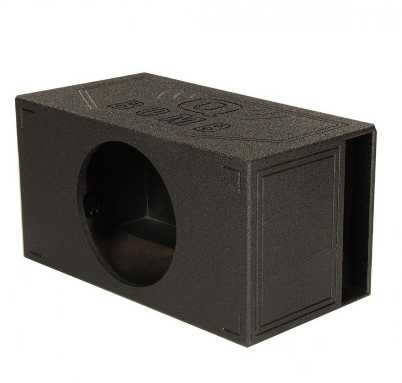

noxas Posted June 18, 2017 Author Report Posted June 18, 2017 I'll be running a mtx thunder 4501. I redid the measurements on the car and I'm sitting more along the lines of 31inchs. when you say port out the side do you mean like this? This would also increase my total depth of the box to 23 as well right?
Triticum Agricolam Posted June 18, 2017 Report Posted June 18, 2017 Yes, that picture shows what I mean by "port out the side". Changing to that will not increase the depth of your box because the volume the port occupies has already been accounted for. "Nothing prevents people from knowing the truth more than the belief they already know it.""Making bass is easy, making music is the hard part."Builds:
