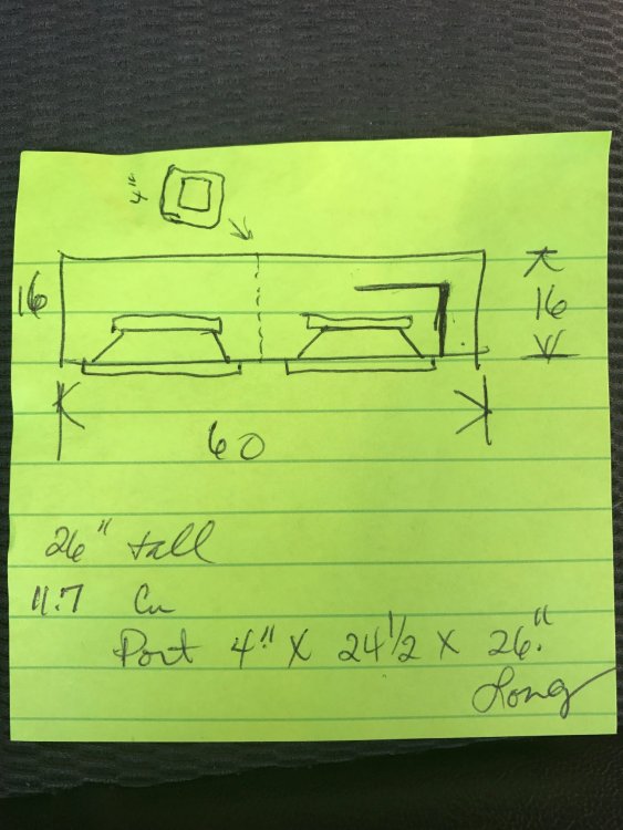

cleto13 Posted September 11, 2017 Author Report Posted September 11, 2017 Ok so I went to see my audio guy who has never disappointed me, and he designed a box for me. I'd like to see what you guys think before I start ripping MDF. And just to remind y'all, I've got (2) solobaric L7 15's and a RF T2000.1bd. My box is made of 3/4" MDF. Dmensions are 60" wide, 26" tall, and 16" deep (outside measurements). That should be 11.7cu ft NET. Port is L-shape 4" wide, 24.5" tall, and 26" long. 4" square brace in the middle. That should be tuned to 22hz. Thoughts???
cleto13 Posted September 11, 2017 Author Report Posted September 11, 2017 This is what he sketched up for me
Triticum Agricolam Posted September 11, 2017 Report Posted September 11, 2017 I come up with about 10.1 cu ft net, tuned to about 26 Hz. I think those specs should work fine though. "Nothing prevents people from knowing the truth more than the belief they already know it.""Making bass is easy, making music is the hard part."Builds:
goldeneye4564 Posted September 11, 2017 Report Posted September 11, 2017 i recommend double baffle. I RREEALLY ANGRY WIT U PHOTOBUCKET. HAD TO USE DROPBOX NOW HOLYYYYYY. Wanna ride bikes? Quote On 9/16/2017 at 3:28 AM, Jake Pace said: Oh i know how a 12v system works I did take 3 years of electronics in High school hands on and some in college and also worked on cars in college an always got A's to B's in each class. But oh well enough dealing with ppl who have probably not even lived as long as ive been into electronics! On 7/8/2013 at 4:01 AM, Banshee421 said: Do horns get low
