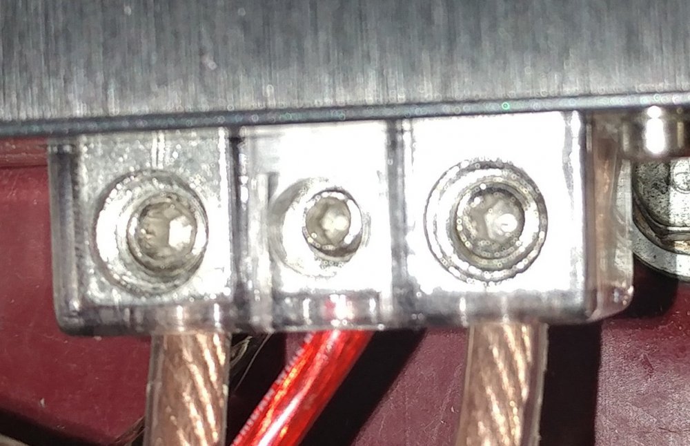

Levi563 Posted September 22, 2017 Author Report Posted September 22, 2017 Here is a pic of the amp. wires are straight to the battery can't really get to the back of the head unit unless I take out the majority of the dash might get them later if necessary. sorry I had to crop so much file size was to big
