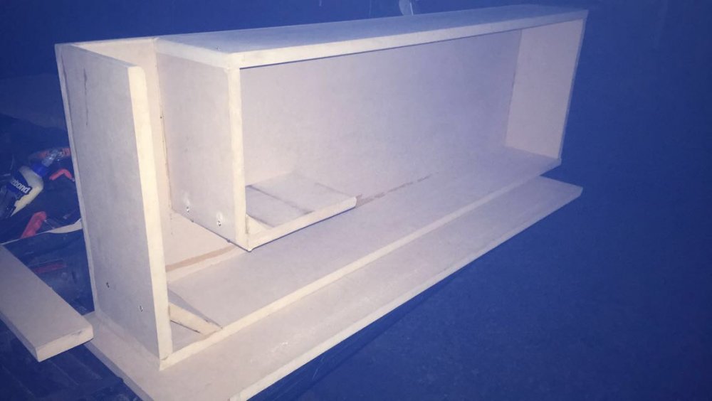

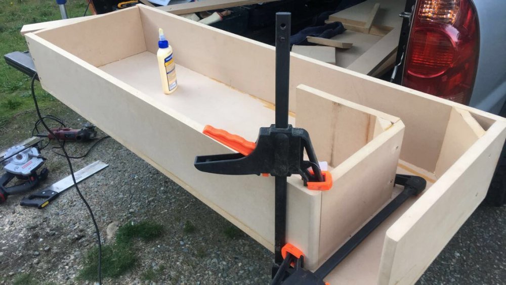

theaestheticgreek Posted October 24, 2017 Author Report Posted October 24, 2017 Hey Joe, just wanted to drop an update right quick. Life’s been crazy and I’ve been without my own garage and have had a bucket of tools everywhere I’ve gone and been since I started my little journey to knock out this box. Gotta day I’m super thankful for the help to. I’m pretty passionate about building and I’m learning a lot as I go. I’d like to swoop some legit design software and begin doing this shit on the reg to. Anyhow, idk if I mentioned it earlier but I’m basically a really good looking and pretty tan homeless guy, but I’ve managed to get this much done out of the bed of my truck. Like I’ve built what I’m about to show you from my tailgate.

Joe X Posted October 24, 2017 Report Posted October 24, 2017 Great job on the box and thanks for the update, you will really need those cross-braces front to back on the figure if not more, box needs to be stiff to work well, sorry to hear you are having a hard time with money right now, if you intend to keep doing this I would still consider the router a good investment.
