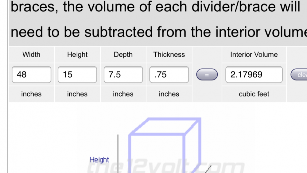

theaestheticgreek Posted October 5, 2017 Report Posted October 5, 2017 Hey SMD forum hoping this forum is more active than my old stomping ground of caco but im just trying to get some help for a box for an l7 10 to put behind my tacomas seat. i could go 10.5 deep at bottom, 18 inches tall, and 6.5 deep at the top. just gonna do a slot port and id like the box to be 48 wide. i got the torres box calc but its not giving me the tuning of the box i got goin on. so was wondering if anyboy here could help me? ive had a post up about this for months at caco but i think its too sleepy over there. and i hae a mac computer so its been a chore even getting a program to work without buying it. so ya l7 10, looking to tune 32-35hz whats good lol i had an idea to do the box like, 13 tall, 48 wide, and 8.5 deep. this way the box is deep enough for the 6 3/8 mounting depth but idk. i know the subs displacement is .065 cubes to
theaestheticgreek Posted October 5, 2017 Author Report Posted October 5, 2017 Super lame stat but this is what I think I'll want as far as volume goes before dropping the port and sub in. Displacements should only knock the volume no more than like .25cubes ish? I'm thinking like 10-11cubes of port area sub? Or is it per per cube I forgot how they do that.. been years

theaestheticgreek Posted October 10, 2017 Author Report Posted October 10, 2017 Frick.. so joe x... I can go taller I can go up to 18 tall.. Like I was kind of thinking maybe it be better to give the L7 a lil more volume like upwards of 2 cubes? Unless... you think it be better down at 1.7? And another thing is I frickd up and already made a couple cuts to make the box 48W x 15.5T x 7.5D so maybe we can keep the depth. But I’ve got a 41X48in sheet I can still build to make the box taller if we want? Think you could swing that? And it be sup forward, port shooting up out the top on whatever side of the box?
