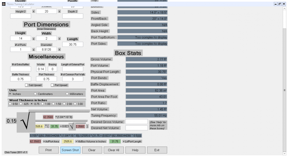

Ok, I put the SA box design into the calculator just to verify. Am I doing something wrong here?
Also is the port length on the pre-designed box = 30.75" (1 1/4 + 13 + 16.5)? Just want to make sure I understand the port length dimension
The port is going to be longer than that because you measured the length of the panels, but port length is measured down the center line of the port.  I can't tell what it should be from the pic, but its going to be several inches longer.
