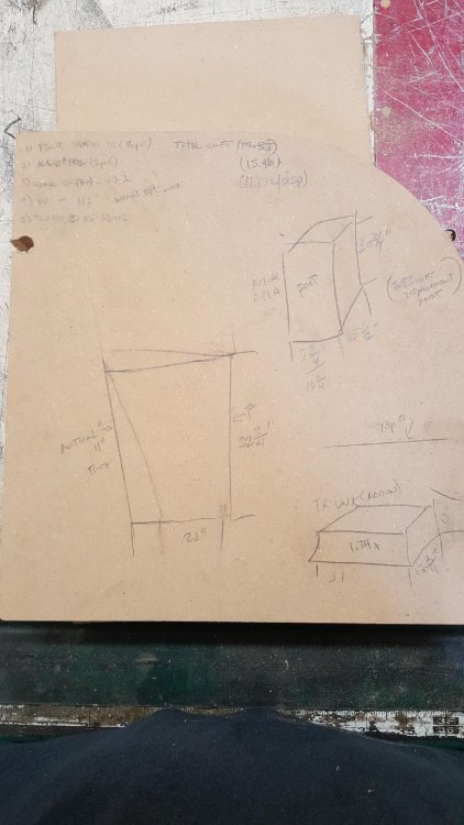

What's up bassheads, trying to keep this short and to the point. I got a wall built for my Nissan Altima 4door and from the sounds of the setup it not sounding the way I was hoping. I think he went with a program online to figure out wall design, he says tuning is 36hz or 37hz but sounds way higher.. the car bass is punchy... if anyone has any experience building enclosures for these.. plzzzzz let me know! Thanks in advance bassheads. I attached the measurements and design..

would these specs work? I think these recommendation was for the 2008 dp 15s!

ok I will try that... I was hoping someone could look at the pic I load with the measurements of the enclosure and port and let me know what volume they get along with the port tuning.
Its really hard to read the numbers in your pic.  Port calculations are exact anyway, since you are having problems you will be better off to find your tuning with the method I gave you anyway.

finally got a chance to find the acoustical frequency.. and its tuned to 44hz

That would explain your problem.
