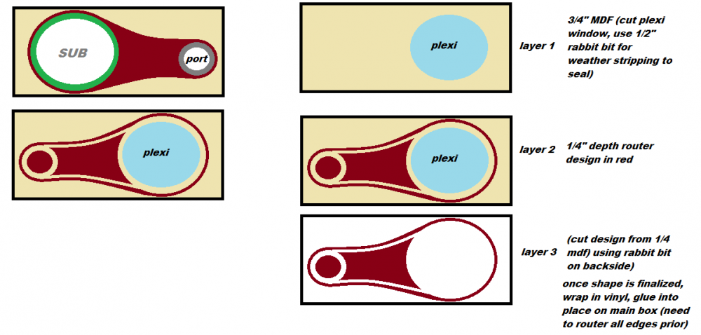

hello all! I am about to start work on a ported enclosure for a single 12" Rockford Power T1 (T112D4) ill mention some basic criteria i used to reach the current design and include photos of where im at in terms of planning, followed up by my questions.
So criteria- space lost to box must be minimal while still offering proper volume for sub. sub must be front firing and either front/side ported. (this is to eliminate any chance of cone damage via stuff in the trunk. also would like a plexi viewing window. amp must be hidden and exposed wiring minimal. (clean look)
current idea/design- as of now im aiming for a 2 cube (pre sub) aero ported enclosure tuned somewhere between 34-36 depending on input. and id like to venture into vinvl wrapping/ designs.i plan on buildiing the box out of 3/4"MDF , on the back side (trunk side) will be the viewing window and complicated wraps/designs. my questions are as follows 1) if im using 3/4" MDF and i router a 1/4" depth to inlay the design, will that compromise box strength for this single 12? 2) my viewing window will be 10ish inches in diameter, do i need 1/2", 3/4" or 1" thickness? 3) it is entirely possible that i could run the aero port through my rear center armrest into the cabin, effectively making this a blowthrough ,should that be done? thank you in advance for any input.
3/4" acrylic should be plenty strong enough.
How much power are you going to be running and what size is your port?
since its D4 im wiring down to 2 and aiming to run 1,000-1,200 w @ 2. im honestly not certain on port size/ length at this point. i played around with it before but i read through one of your posts explaining port velocity and keeping it below certain speeds, saved your calculator as well and plan on utilizing it, what i do know is id prefer an interior swappable port.
