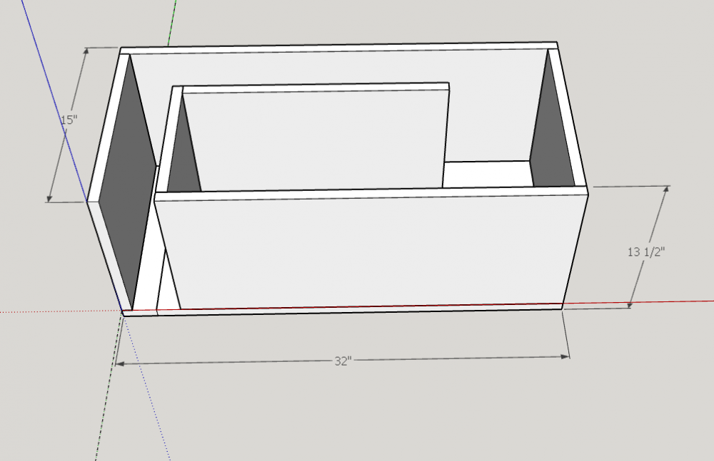

akuma4u Posted December 25, 2017 Report Posted December 25, 2017 hi can someone please tell me if this design works and is accurate? 2 cubes net @ 38 hz also,.. is it possible to delete threads? i kinda made a couple that are too similar and want to get rid of one..
the_village_idiot Posted December 26, 2017 Report Posted December 26, 2017 i tried to use your dimensions and this is what i came up with
the_village_idiot Posted December 26, 2017 Report Posted December 26, 2017 just my 2cents, it looks way off. Its showing 1.49 cubes net, and a 44.06hz tune and waaaaaay too much port area per foot. Correct me if i entered any information wrong.

akuma4u Posted December 26, 2017 Author Report Posted December 26, 2017 The only thing you entered wrong was sub displacement but that doesnt help matters as its .21 not .08. I also was very confused with this design and torres results they r way way way too off but the guy who made me this design told me to screw torres and use his...but i dunno i wanted confirmation first its accurate before i build

the_village_idiot Posted December 26, 2017 Report Posted December 26, 2017 Corrected the disp. That was my fault, i never changed if from my last build lol. But after that correction it made it worse.
Triticum Agricolam Posted December 26, 2017 Report Posted December 26, 2017 4 hours ago, the_village_idiot said: Corrected the disp. That was my fault, i never changed if from my last build lol. But after that correction it made it worse. That style of port is a 3 common wall slot port. You need to enter in a "3" in the "# of Common Port Walls" field in Torres. It changes the tuning significantly. "Nothing prevents people from knowing the truth more than the belief they already know it.""Making bass is easy, making music is the hard part."Builds:
Triticum Agricolam Posted December 26, 2017 Report Posted December 26, 2017 7 hours ago, akuma4u said: hi can someone please tell me if this design works and is accurate? 2 cubes net @ 38 hz also,.. is it possible to delete threads? i kinda made a couple that are too similar and want to get rid of one.. I built the box in Sketchup. Here is what I found. The net volume comes out at 1.8525 cu ft (2.0625 - .21 for sub displacement). The port total length is 28.5". Based on my own experience, I bet your tuning comes out at about 39 Hz. Torres came pretty close, but not quite perfect. "Nothing prevents people from knowing the truth more than the belief they already know it.""Making bass is easy, making music is the hard part."Builds:
