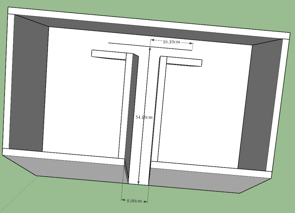

Joe X Posted January 9, 2018 Report Posted January 9, 2018 On 1/5/2018 at 9:16 AM, AndriusLT said: Hello, I am making a dual 12 inch sub box with one square port and I wanted to ask how should i measure the port pic: Correct me if am wrong at measuring port in the picture. Just a visual of how the T shaped port needs to be done:
AndriusLT Posted January 18, 2018 Author Report Posted January 18, 2018 Okay guys so correct me if I am wrong. The port length in the picture is 54.10 cm + 16.10 cm x 2 = 86.30 cm ?
ckeeler11 Posted January 18, 2018 Report Posted January 18, 2018 Would not be times 2. total would be 70.20.

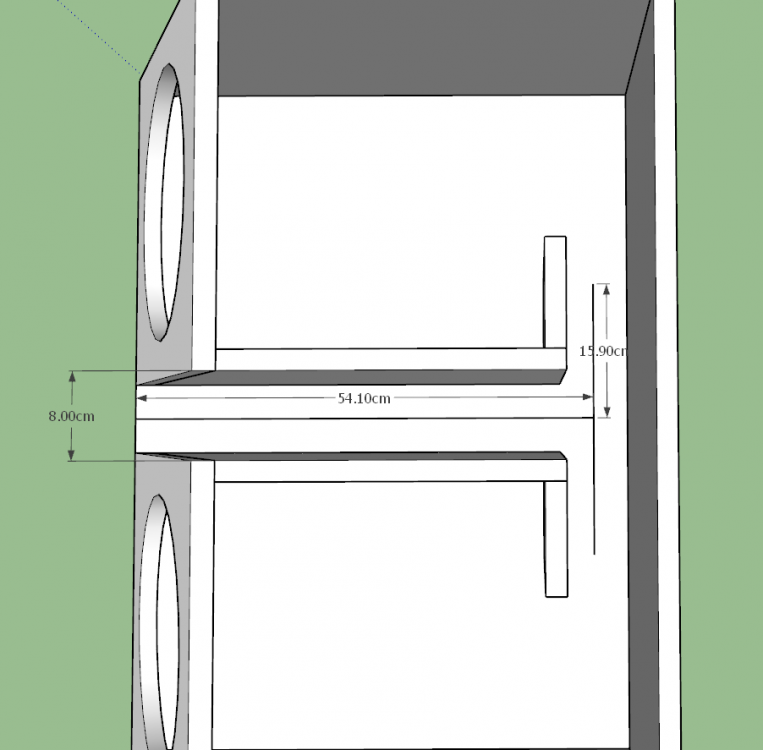

AndriusLT Posted January 18, 2018 Author Report Posted January 18, 2018 Okay so all port length would be 54.10 cm + 15.90 cm = 70 cm ? And also from where should I start measuring the port if it is angled?
ckeeler11 Posted January 19, 2018 Report Posted January 19, 2018 How drastic is tha angle? if there is a small difference from top to bottom then measuring from the bottom will be fine. If there is a significant difference from top to bottom I would measure from the middle.
AndriusLT Posted January 19, 2018 Author Report Posted January 19, 2018 Okay will measure from the middle, but have I calculated right? (All port length)
ckeeler11 Posted January 19, 2018 Report Posted January 19, 2018 Yes but measuring from teh middle the front to back port will be shorter so you will need to add some to the "T's" to maintain the same port length.
