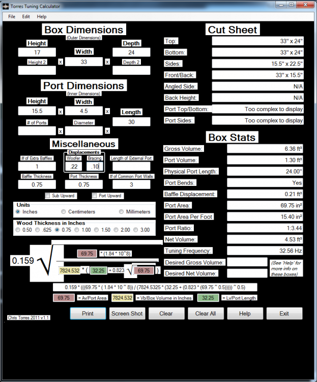

Help needed with box design for x15
gonzalez210

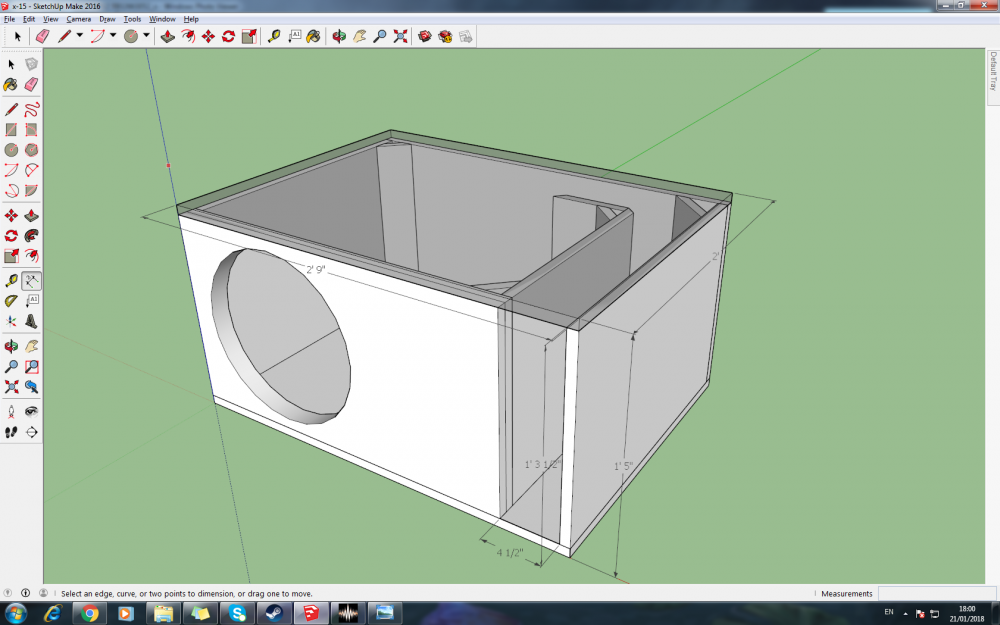

Looks good to me!
Builds:
Sub position shouldn't be a problem and for the 45's they are all the long sides so do as you cut the long bit and then use 45 degree bit in the router to get your angle.
Also because the box is two baffles you could flush mount the sub also if you wanted to.
